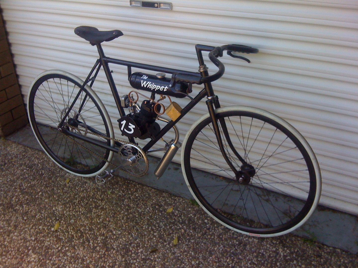

Really happy with Norm's @ Venice Motor Bikes wheelset. Weinmann rims are the same colour as the bike. 12g spokes, CB110 rear hib

Looks outstanding. Nice work.... i must have missed something, did you say you got the wheelset from Venice Bikes? But i thought someone locally was building your wheels?..... whoever did em they look great, i like the black rims a lot more then the chrome you were planning
the local ones that were laced for me, had mismatched rims, one was narrower than the other, & one was new & the other old & untidy. Bicycle shop that did the lacing havent rectified this.
So I didnt go back to get them, left them at the shop, down 2 hubs but whadda you do?
Norm's set with the Weinmann rims is excellent!
Looks like you got yourself a roller! Nice job.
Thanks Pat. Yeah at least it's a roller now, as you say.
