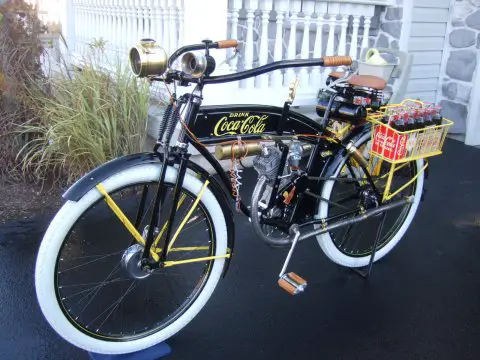

Now ain't that cool ... you've got me inspired. That really looks great. If mine tuns out half as nice as yours I'll be happy. The Coca-Cola theme really works. Maybe I should paint the name of a plumbing company on the side of mine!
I'm running my computer on battery so I can't make out all the details, but is that a throttle or clutch lever? My throttle lever will be on the right and I'll have a lever on the left actuating a tensioner for the belt drive.
