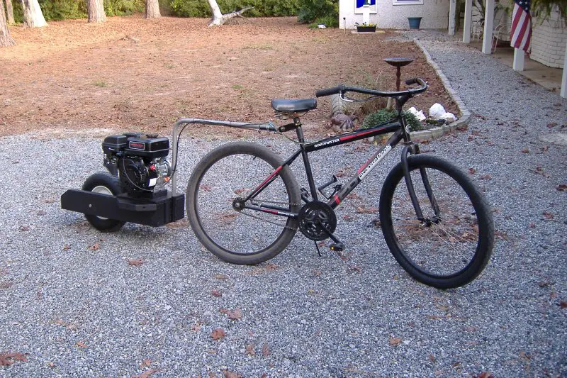

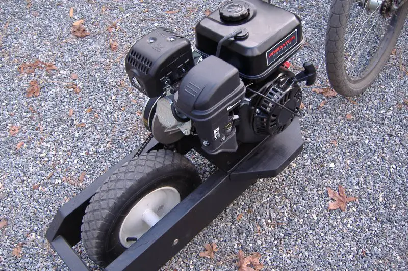

Guess I have built just about all kinds of MBs but never a push trailer. Figured I would give it a shot.

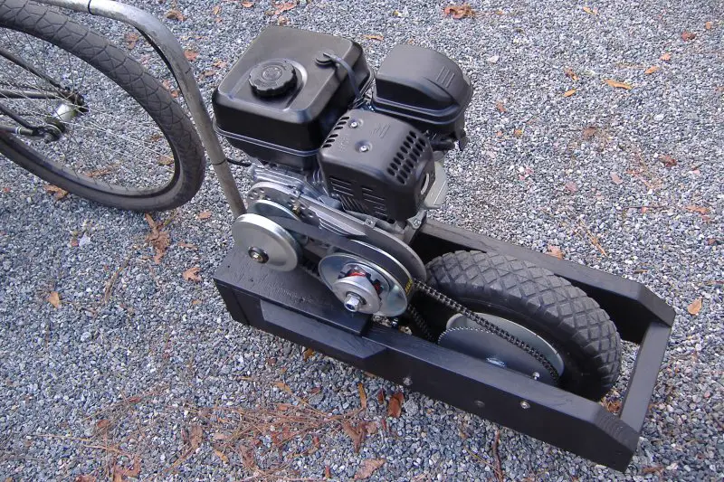

The trailer is made from scrap left from our old house renovation. Uses a wheel barrow wheel with a 72t #35 sprocket welded to it. 212 Preddy thru a TAV 2 clone. The TAV is the only way to go these days @ only $52 shipped why fool with a cent clutch. Ratio is a 4.8:1 which starts off at a 12.8:1 and ends up at a 4.32 if it reaches OD. Figures to the low 40s with the governor, the Preddy is governed at 3800 instead of the usual 3600 With out I bet 50+ is easily possible. Really just want a relaxed cruise in the upper 30s.

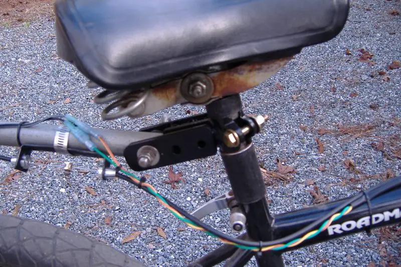

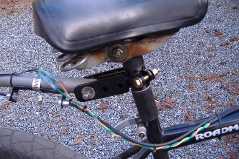

The thing is not as ungainly as it looks in function, is very quiet and is as vibration-less as an ebike. Has worked very well is the short time I have used it. Cool thing is my wife got a steal on a nearly new Schwinn Meridian and it will quickly hook up to it. Will hook up to various bikes we have. I made a two sided seat post to adapt the bigger posts. Its got skid rails on the sides to protect the engine should the need ever arise-- hopefully not!

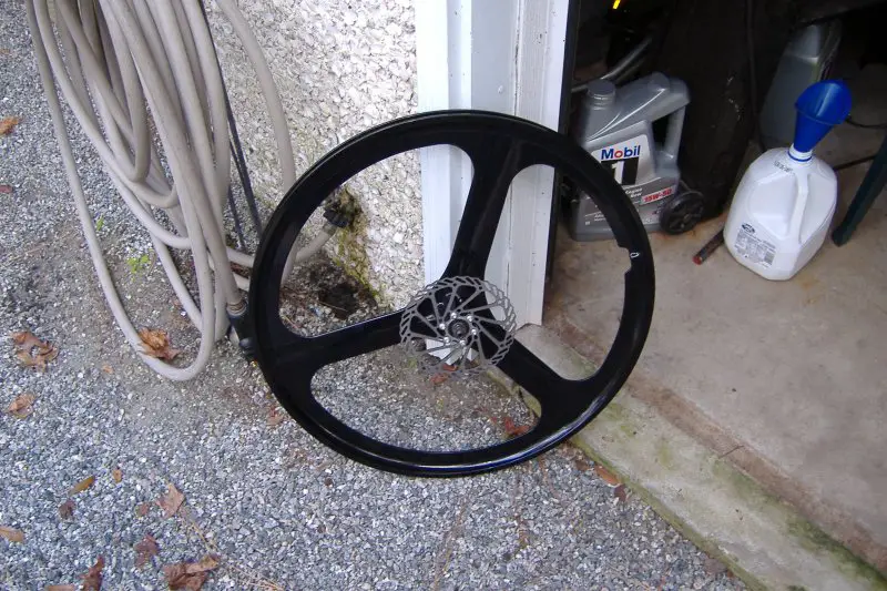

Plan to rebuild the bike with three spoke mags and disc brakes front and rear as it needs better stopping power at the speeds and weight it experiences.

Went on an extended test run. Its so much fun just kept riding. This thing is pretty fast! Acceleration is quick and the top end is pretty high. Didn't have a way to measure it but it's up there. Handling is excellent turns around easily in the road, and they are fairly narrow down here. Leans easily with the bike in turns.
Really the only thing that makes you know it's back there is over bad bumps there is a slight jacking of the bike fore and aft. And the power!
Think I'm really going to use this as practical transportation. Will easily keep up with traffic in our town. Heck I passed a few cars! Gonna be pretty cool on the trike but will have to set the throttle limit screw to keep the wife out of trouble!
If you are not building an MB for looks or replica etc. this is not a bad way to go especially since it quickly transfers from bike to bike of similar size.

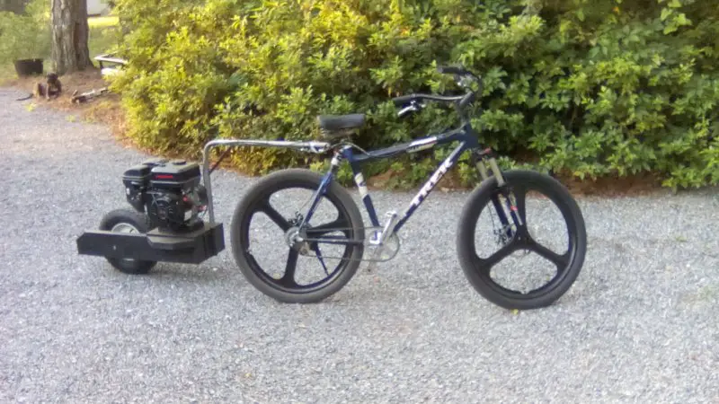

Here's its latest configuration
