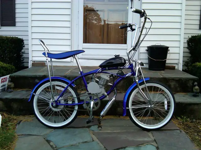

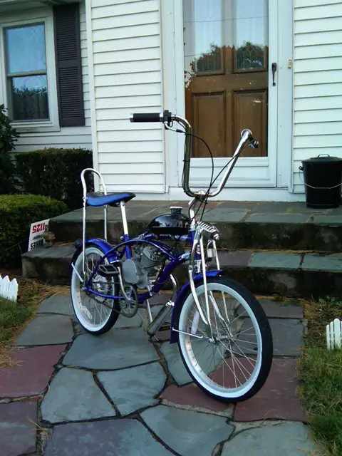

    Don't know how gangsta your wife is. We got these bikes in blue, red, and black. They're small and easy to ride... Plus it can be masked as a second bike for you when shes not riding it. LOL
    IMG00005-20091007-1710.jpg IMG00006-20091007-1713.jpg IMG00004-20091007-1709.jpg

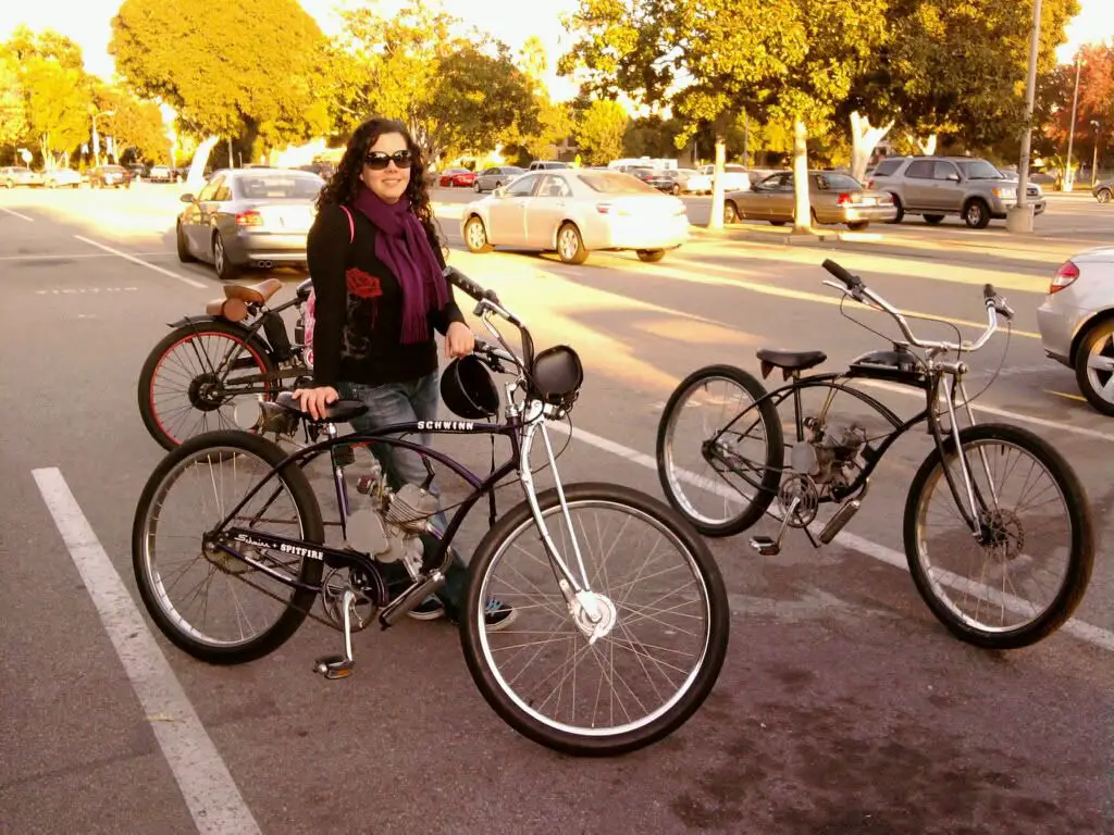

    Doood... My girlfriend is 5' tall & rides & 1981 Schwinn cruiser with no problem!
    [​IMG]
    [​IMG]
