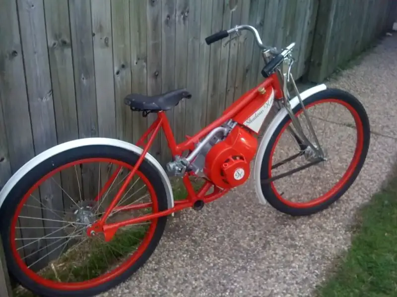

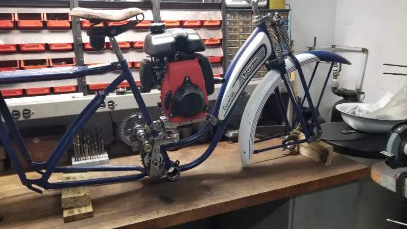

I've often been able to lace modern hubs onto wheels by using the original spokes & changing the lacing pattern... Most wheels use a 3-cross pattern; I tried either a 2-cross pattern or a 4-cross pattern... (If the hub is larger than the old, the 4-cross pattern is what worked).Hit a brick wall when I tried to lace the original steel rims to modern hubs for reliable brakes. I need to figure out how to calculate the proper spoke length. Here's what I got so far.
Are you working on anything during the deep freeze?
