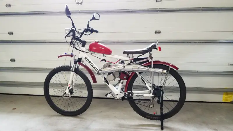

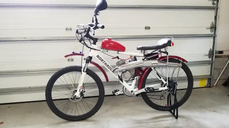

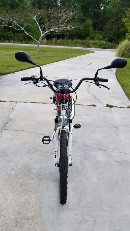

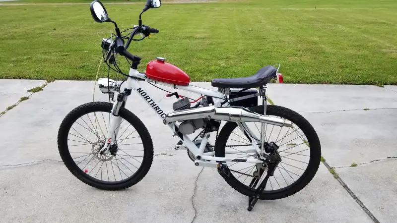

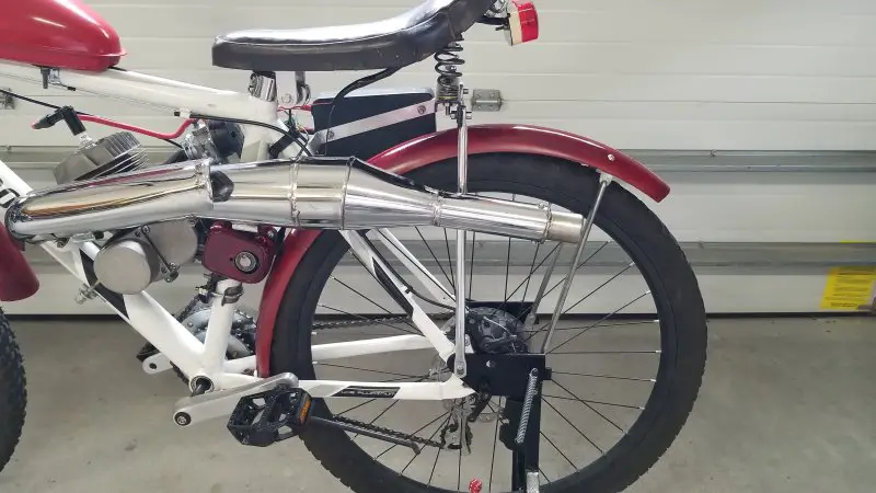

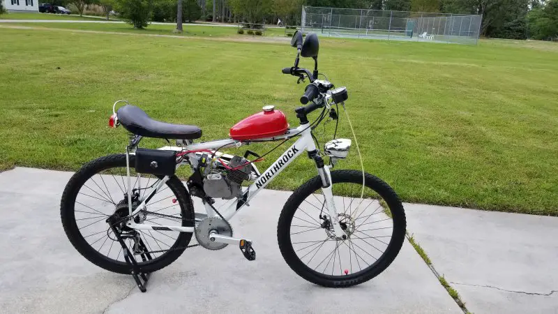

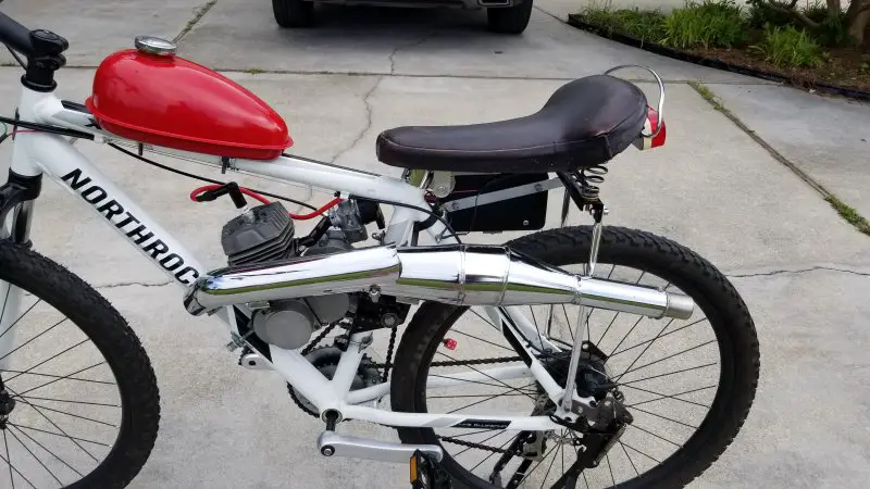

I got out of the game early last year and was left with a couple of bins of parts. When cabin fever set in this winter, I was going to build an ebike, but decided instead to throw the spare parts on my Northrock mountain bike. The attached photos show the end result. I tend to go into way too much detail when I describe a new build, so I'll just say I took it out for a spin today and reached 40 mph in 4th gear before I ran out of street in my neighborhood. Feel free to ask questions and thanks for looking.

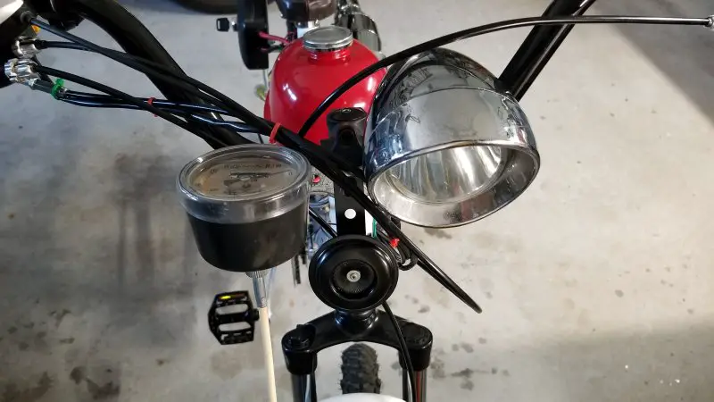

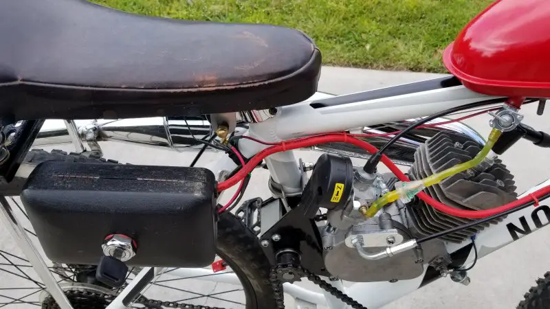

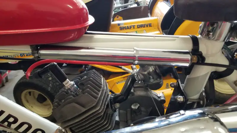

Hi Chad. Stats are stock-jetted Chinagirl with an early expansion chamber and Statton shift kit connected to 7-speed derailleur. The motor mounts were customized for this bike. A 12 volt lighting coil and rectifier run a 1000 lumen LED headlight, dual LED tail light, and moped horn that's operated through the shutoff switch on the throttle. No brake light is set up yet. All electrics like CDI, rectifier, fuse, and keyed ignition are housed in a hinged metal box for weatherproofing. The brakes are mechanical Avid single pad calipers on 160mm discs operated by a dual break lever. The front will be upgraded to a 203mm. No chain tensioners were used because I've found them to be problematic. An extra sprocket was installed between the primary drive sprocket and frame to serve as a jump stop. Tires are WTB Rough Terrain 26 x 2.25 knobbies on standard MB rims. The speedo is a high quality vintage Stewart Warner and the mirrors are motorcycle mirrors from Amazon. The frame is an all aluminum rigid tail with Suntour front shocks and either Walk or Bucklos handlebars (can't remember). Both wheels run on hardened quick-disconnect axles. I made the springer seat from spare parts and scrap leather. The hand bar on the rear makes it easy to work the rear wheel stand for kickstarting (the freewheel on the cassette prevents bump starting). It took a while to get used to the Shimano shifter, but once I realized you don't need to clutch with a derailleur it shifts like a semi-automatic motorcycle, smooth and even as long as you decelerate when shifting. I don't know the top speed-I'm guessing around 50. Hope this helps. Let me know if you want to know anything else.

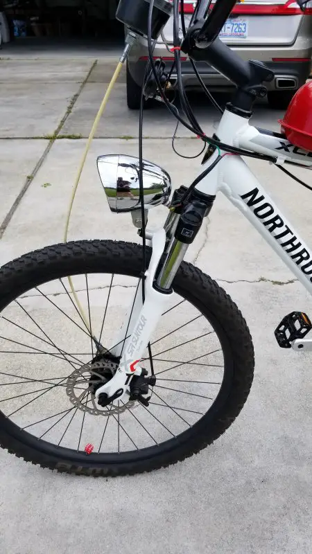

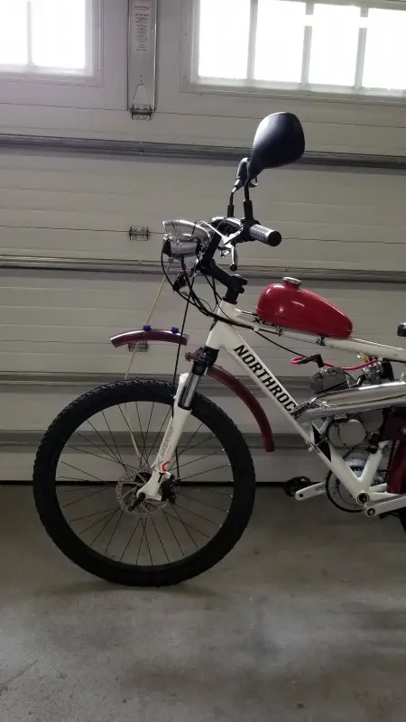

Back in the Skunk Works after buying some fenders on a junk bike at a garage sale for a whopping $1.00. Sanded off the rust and primed, then painted with Red Anodized Dupli Color. After screwing up the front fender I had to learn how to paint all over again. I used the goose neck from the donor bike to make a front fender mount that inserts in the bottom of the steering tube. The front fender was cut in half and mounted to an aluminum strap that is held in place by the inverted goose neck. The hardest part of mounting the rear fender was dealing with the derailleur when the rear wheel was removed. Will paint the tank and electric box to match after a short break for riding.

I got tired of tuning the carbs on my two bikes, so I came up with a fun distraction. I mounted a moped tire pump behind the gas tank using a metal pin on one of the gas tank mounting screws and a plastic tube strap with a pin built in. The spring loading of the pump holds it between the two pinch points. These nifty little pumps have a hose that slides in the housing for storage. When the hose is in place the schrader screw-on connector fits over a pin that holds the pump in place. I always carry a patch kit and two tire spoons with me just in case and the pump will allow me to re-inflate after repairing a puncture. Have been looking for moped-type tires for bicycles, but can't find any that are nearly as durable as the Heidenau K-56 tires on my little SACHS that are constructed like motorcycle tires and haven't suffered a puncture in 5 years of riding. Anyway, now that I have my pump installed, I can deal with a flat.
