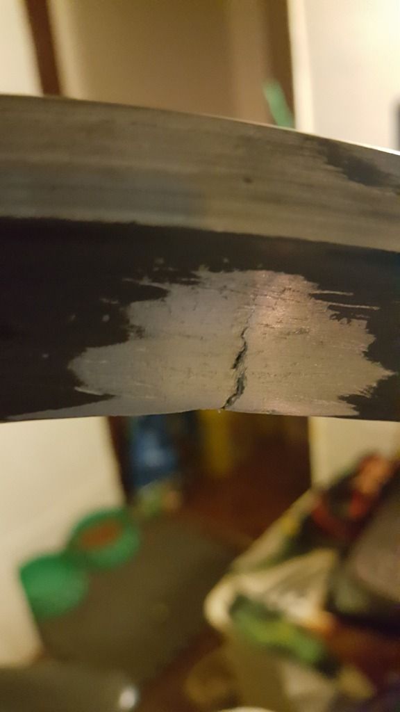

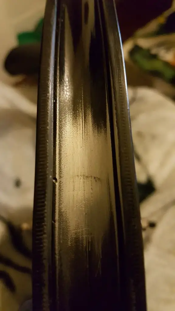

So today when I was messing around with my clutch and readjusting in I noticed my mag wheel kept binding up on my brakes which I though was odd because unlike a wheel with spokes these don't come out of true unless they break.

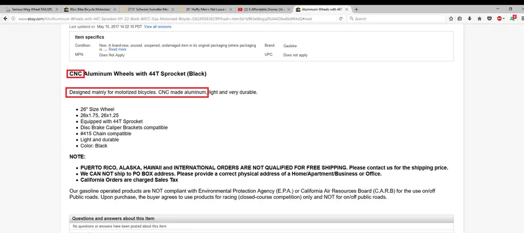

Well... When I finished working on my clutch I decided to look at the wheel, my heart sunk. It somehow cracked after spending nearly $200 dollars on mag wheels. I got them from gas bikes eBay page, there is less then 200 miles on these wheels and they already have had a serious failure.
If you look at the first and second page of this forum section (Wheels, Brakes and Suspension) you will see that I have started 3-4 different threads because I have had nothing but problems with rear wheels since I started working with motorized bikes. From 2 different hub adapters slipping and snapping spokes to wheels constantly coming untrue and then to this, diving in head first and spending a lot of money on wheels just to have one get destroyed...
I'm at a loss now because I've run out of options to beef up the wheel any further. I will be contacting gas bike to find out what they can help me with since the wheel is less then 6 months old and has hardly been used as its so cold up here. Will keep you updated with what they say.
Scary thought is I've been riding on it cracked like that for a bit because I could feel the rear of the bike hopping up and down and figured it was the chain but it wasn't it was the flat spot on that rim. Guess I'll keep riding it till the rear wheel breaks completely for now. Here is some pictures of the fail.
https://imgur.com/a/3Ngk4
I added a new link to the photos since photobucket removed all of my other pictures. It shows the crack and how I welded it. It did crack again and I will upload that when I get another camera that works.
It's a very sad day.

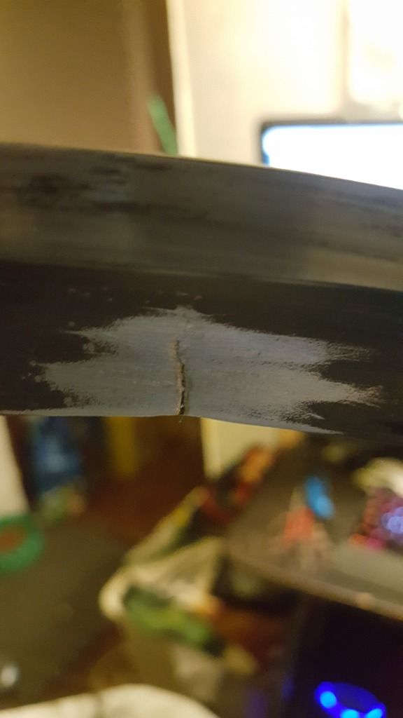

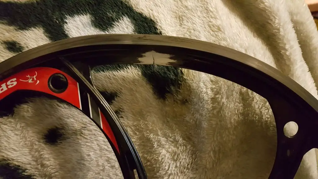

So I went ahead and did all the prep work to begin TIG welding the wheels while I'm waiting around for money to get new ones. These new pictures will show in better detail the cracks.
Nothing worse then having a running bike stuck on the side lines because of wheel issues.
Im going to weld it over the weekend and I will post update pictures after its done. Hope I can heat treat it enough to remove the flat spot, aluminum sucks when it bends because to bend it back you risk more stress fractures and the rim is already compromised but I believe we can add enough material to make it safe enough for a month or so on the bicycle.
Here also is a GIF of how much the sprocket moves on the wheel after I removed it. They drilled the holes to big and I'm not sure if I will be able to re-tighten the bolts because I when I first got the rims blue locktite wasn't holding the bolts in they kept coming out. So I went ahead and red locktited them, worse come to worse the sprocket will sheer the bolts off unlikely tho.
http://imgur.com/a/V9Q2g

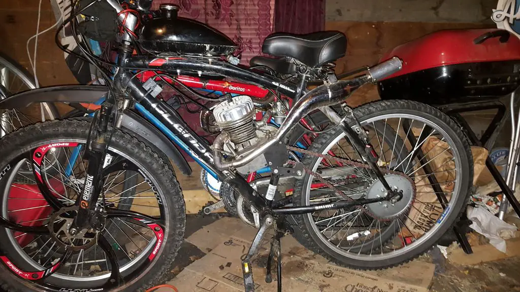

Got her back together for the weekend guys!!!!!!
I'll be able to hit some yard sales this weekend!
Still will be welding the old rim back together this weekend will post more pictures soon. I'll look into a full suspension bike soon but depending on how much it all adds up to it might be cheaper to buy a used XR650 at this point.

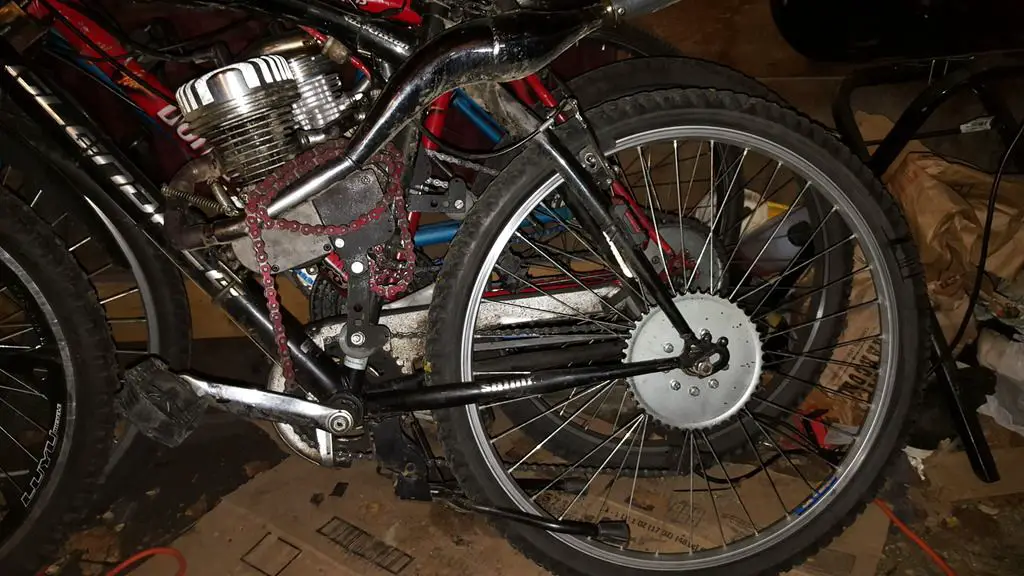

So I went for a ride this morning and everything was good and lined up so I went to bed and then I took it out again and the rear wheel got all messed up again... Chain snapped, causing the wheel to warp wayyyy out of whack. Here is a picture of the damage....
One of these days I'll find a rear wheel that holds up!!!
