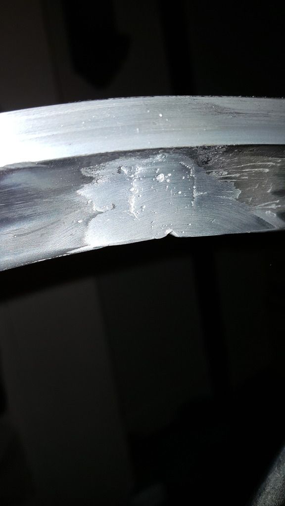

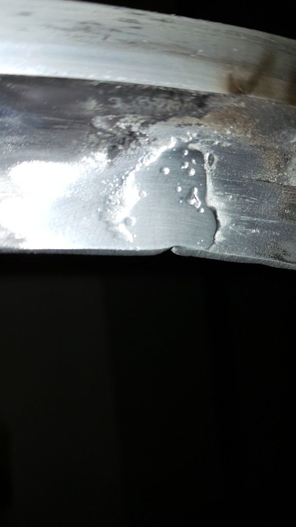

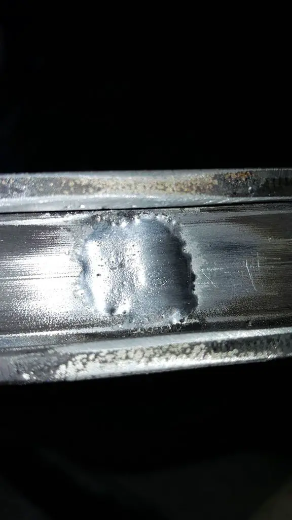

I got my wheel done today here are some pictures of how the wheel looks after TIG welding, should hold up considering the amount of added aluminum. Will update again if it cracks or snaps completely.

Around 50+ miles later the wheel is still holding up very well. No further cracking in that spot. Last week my wife and I did a 28 mile round trip crossed crossed 6 towns. Second to last trip was 11 miles only problems were the chain stretching and the fuel petcock came loose and I lost about a liter of fuel I was pissed because Klotz is 15 bucks a quart.

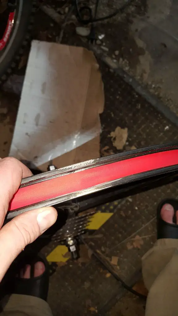

Well sucks all my pictures have been taken down guess photobucket is useless nowa days. So once again I was messing around with my bike adding a half link to the chain and I looked at the rear wheel and it cracked again on the opposite side of where I welded it. TOTAL JUNK. This will be the last summer I ride the bike I cant find wheels that hold up they don't exist under the conditions I ride the bike. Next year I'm buying a on/off road dirt bike.
