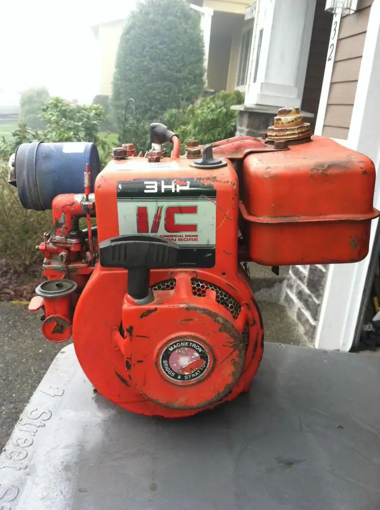

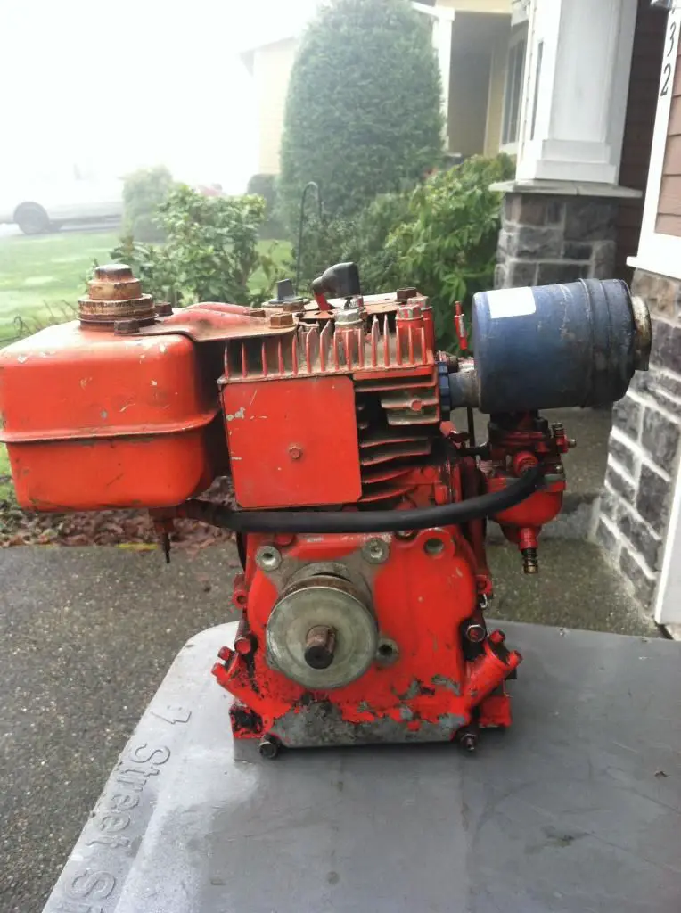

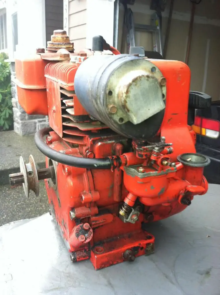

Snagged a Briggs model 80202 3 hp. And also a nice pre-plastic cam for it which will allow me to have it ground. The motor isn't an I\C but it will allow me to build the motor and bike up until I can get the I/c .
My motor should be here this week, it should fit the bill perfectly. Ive got some things to work out with the motor transmission system. Here are the problems I am facing maybe someone can help.
The cast flywheel is going in favor of a billet aluminum
I need to be able to pedal start so I am on the hunt for a clutch with a one way bearing, or a way to modify a standard one as posted in a thread I cannot find. Does anyone have any insight on this?
I will be doing some mods when the motor gets here and will post a step by step. Here is the motor.
