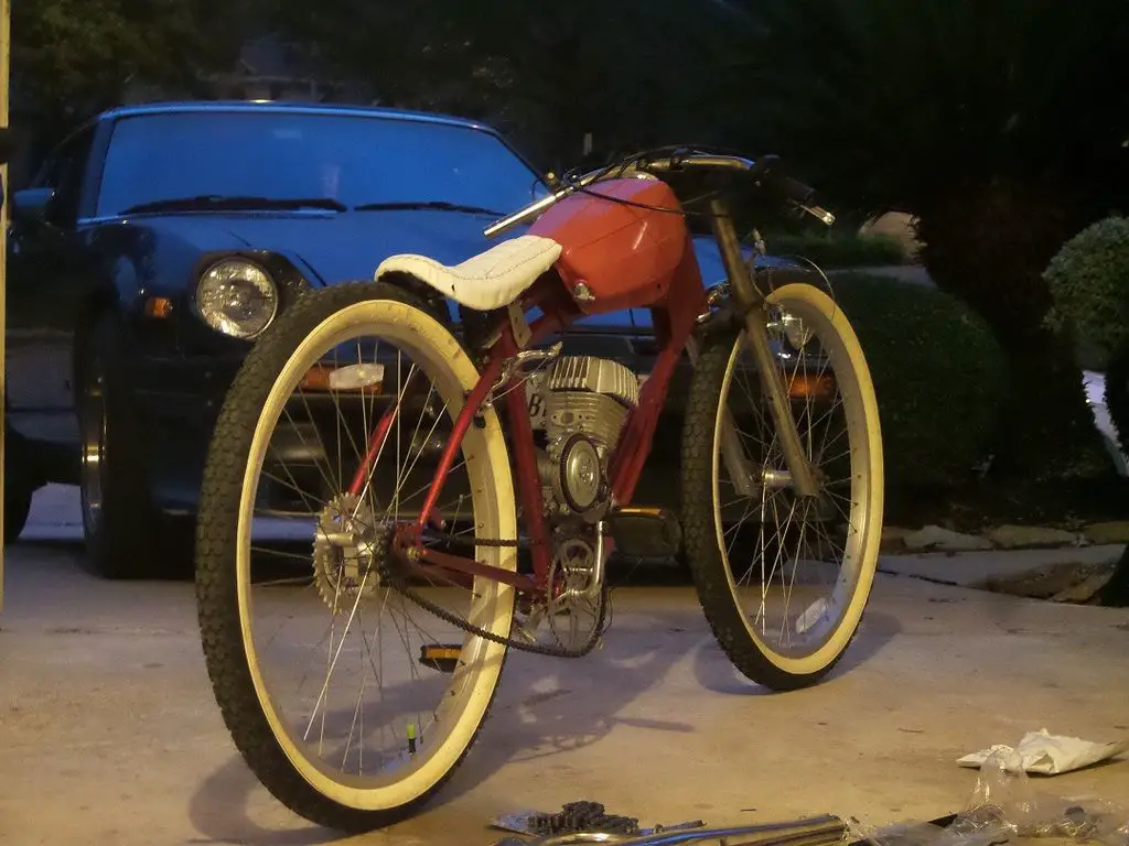

Ryo's Cafe/Cruiser/hot/ratrod bike thing.

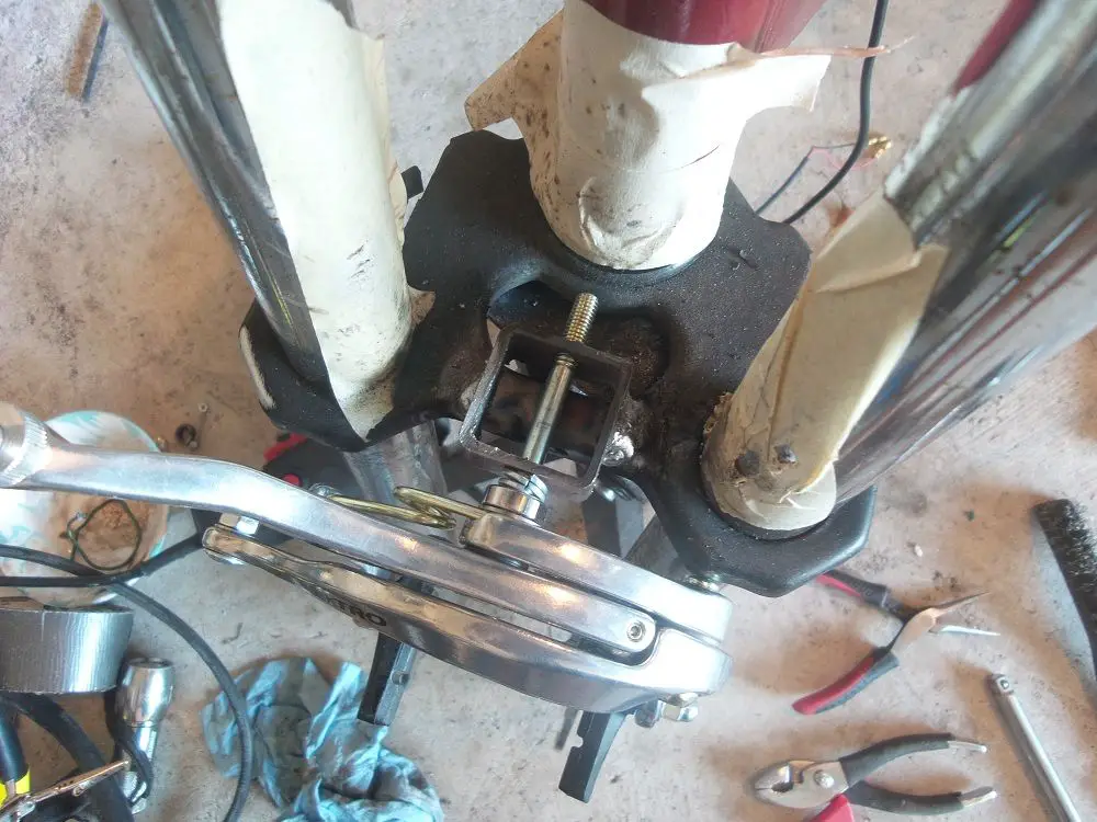

Sanded the rim, cleaned it, and shortened the brake lines... Seemed to have done the trick, both sides pulls evenly now.
I had really long brake lines since I was just mocking it up, but the kinks that the line made the break not work well...
I still need to fabricate something to hold down the front calipers better. It's really janky.

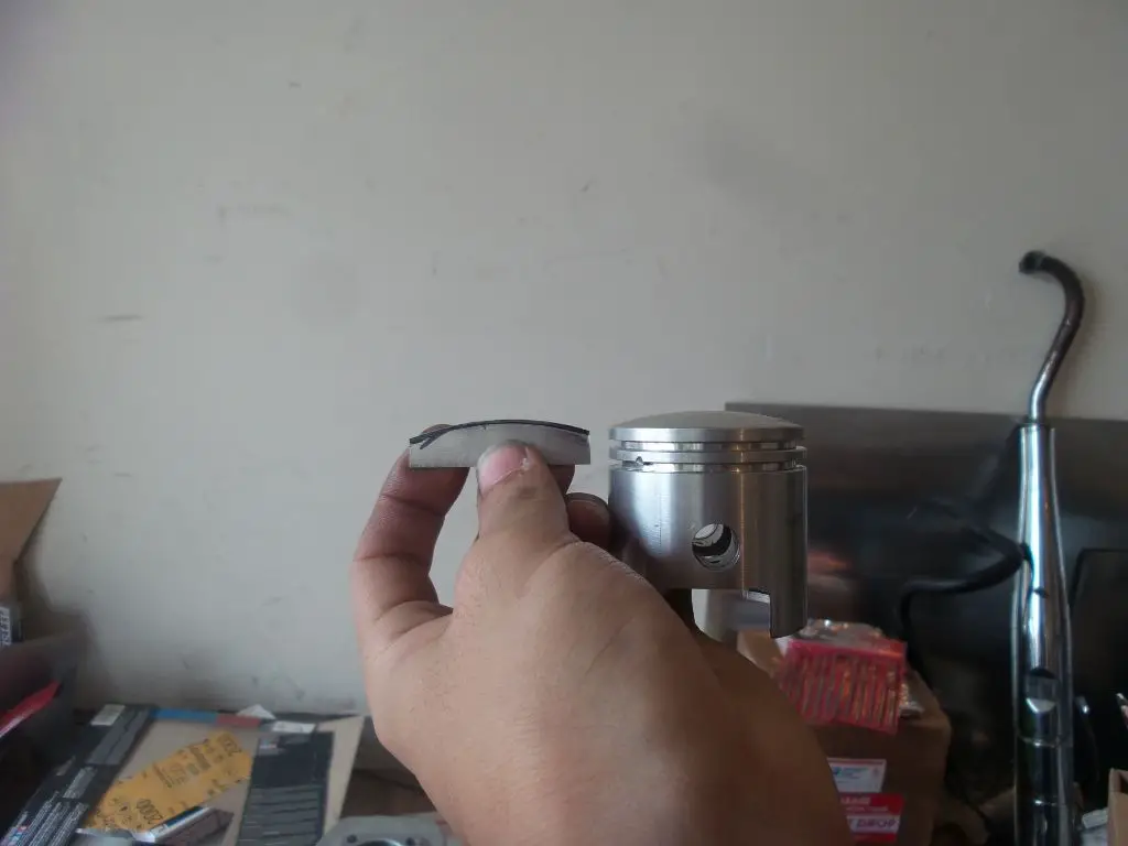

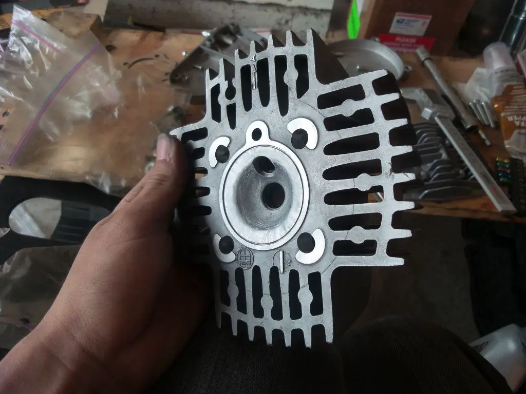

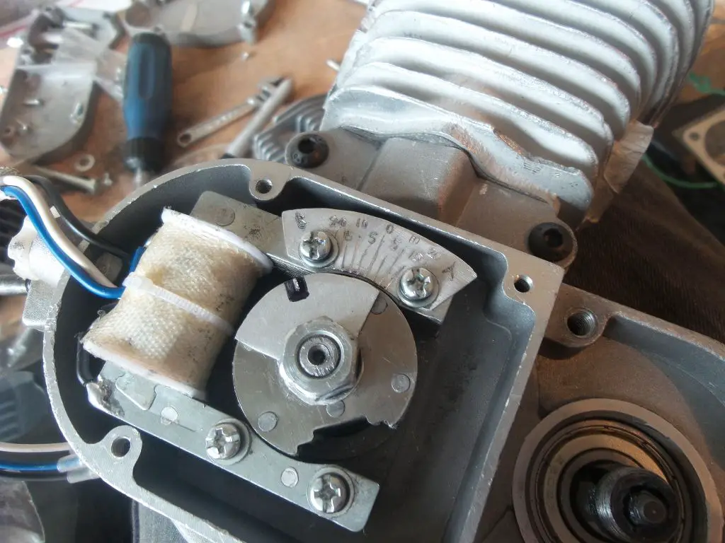

Also made a tool to match the combustion chamber to the piston shape.
Reshaped combustion chamber... To the best of my abilities with the tools I have.
After clay testing, I got the squishband down to 1.2mm with the gasket on... So I try without any gaskets and ended up with .6, which was what I was looking for. However when I went to assemble the motor, it seems that I didn't get an accurate reading with the clay test, piston hit the head while hand turning the motor.
I put the gasket back on for now but I'm afraid it doesn't have a good contact surface with the puch head. I will have to re-check tommorow.

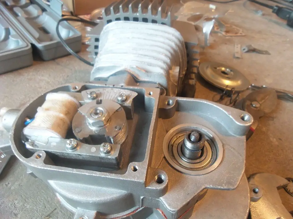

Spot the rookie mistake.
And yes, I had to tear down the whole motor over again.

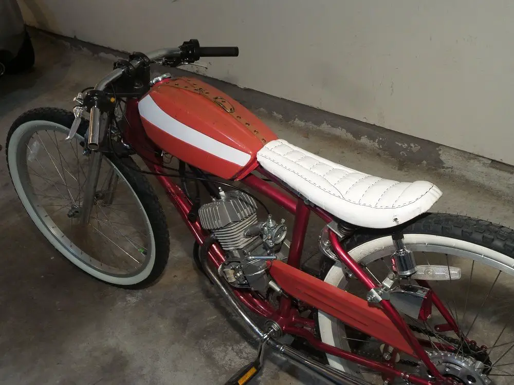

Anyways, should I keep the Patina-Orange gas tank or paint it the same color as the rest of the bike? Decisions decisions...

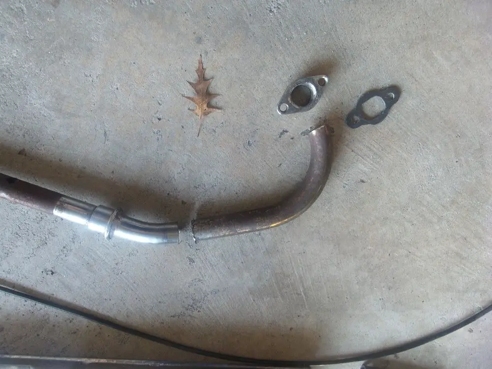

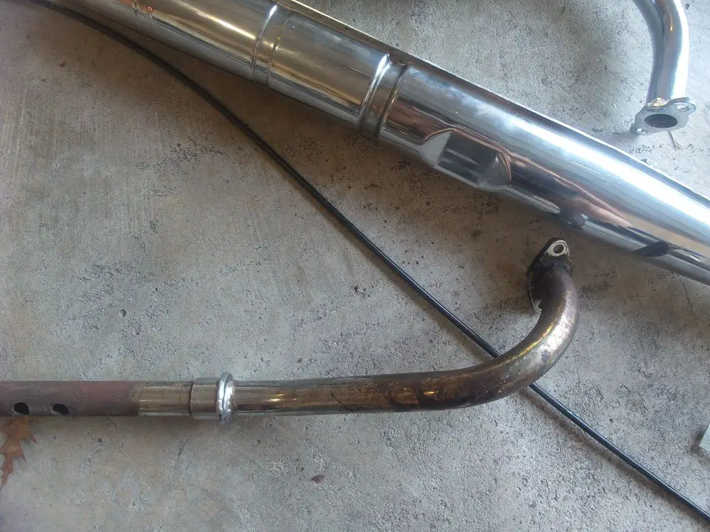

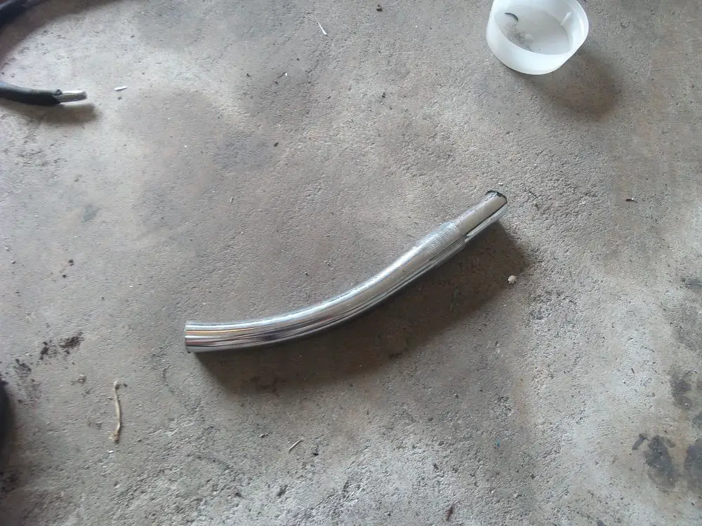

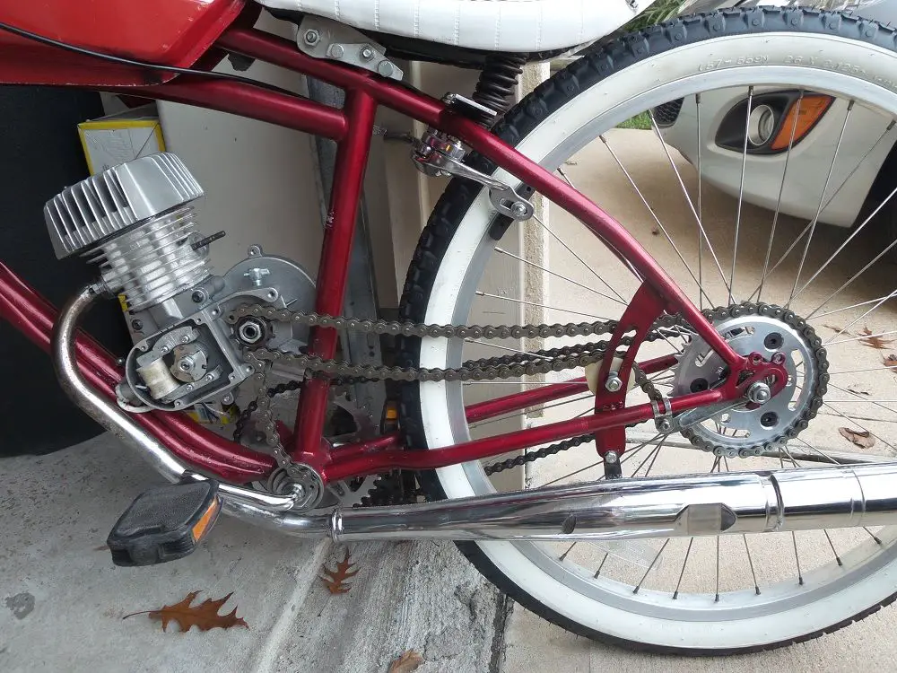

Solely for looks, I decided to use a Puch exhaust / baffle for my motor.
Chopped to re-angle / lengthen some of the parts using the remains of my handlebar, it was conveniently the same OD. ID was slightly smaller but not by much.
End result. I grinded the welds for a cleaner look and to check for leaks. It's really pain in the arse doing this with a $100 Harbor freight fluxcore mig.

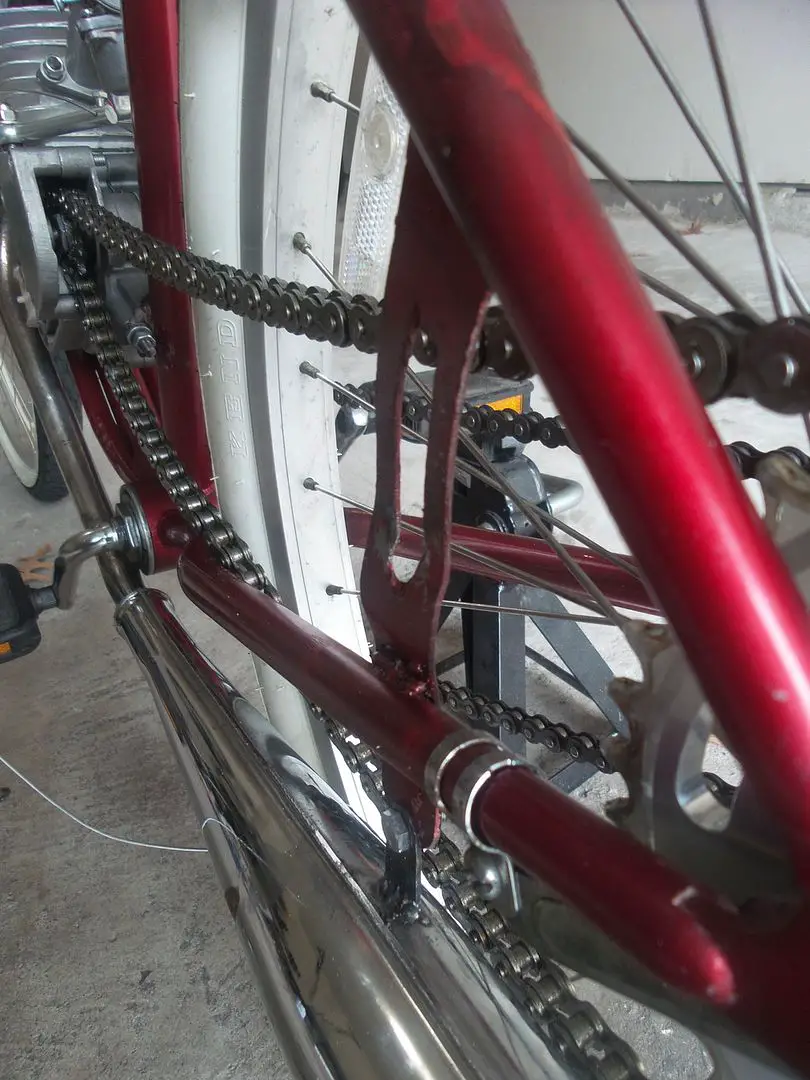

I moved on to make the chain tensioner and realized that I could integrate the exhaust hanger.
Test fit. The chain clearance at the rear tire was very narrow... I was wanting to go with wider tires but seems like it'll be an extra hassle to make that fit. I'll stick with the tires I have for now. slotting the engine mounts seems almost impossible to do... What are some ways to bring the chain out a few more mm?

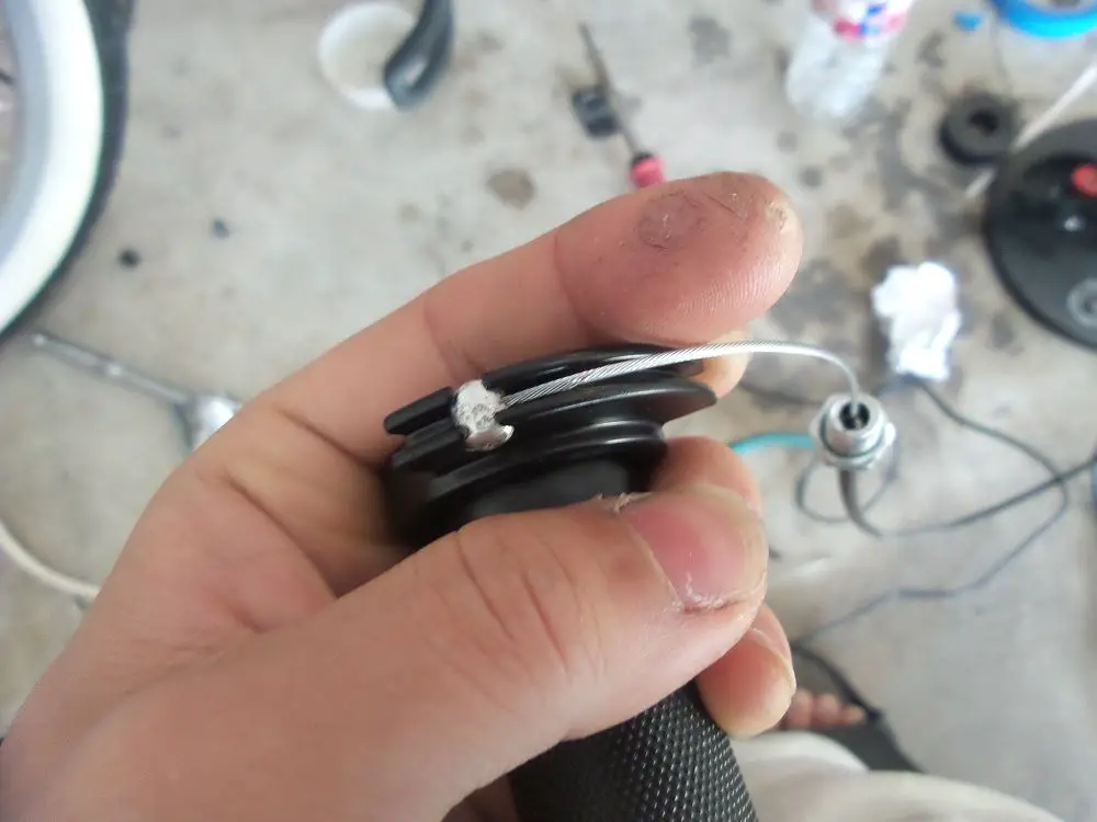

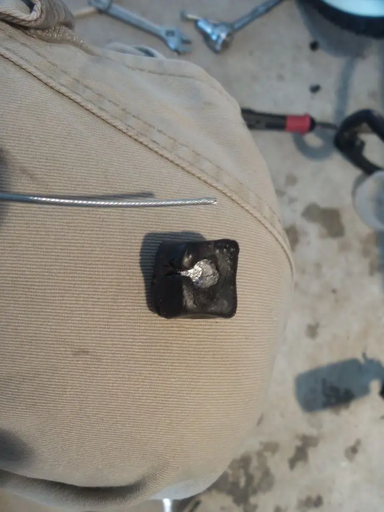

**UPDATE 1/3/2016** The cable end thing came off. Attemp at own risk.**
I didn't take much pictures since it was uninteresting but started work on all the cables and wires. I like to keep things as neat as possible so I trimmed the throttle cable by cutting, per usual, and then soldering on the ends with a little fondry/mold thing I made out of polymer clay and aluminium foil. Also note that the aluminium 1/4 twist throttle sold on ebay will not work with the cable that comes with the kit without modifications to the cable as seen here.
a little porous, but as long as the wire was heated enough, then it'll stay pretty good. I purposely did it to the throttle side as a "just in case" it comes off.
I also re-did the front brake mount .

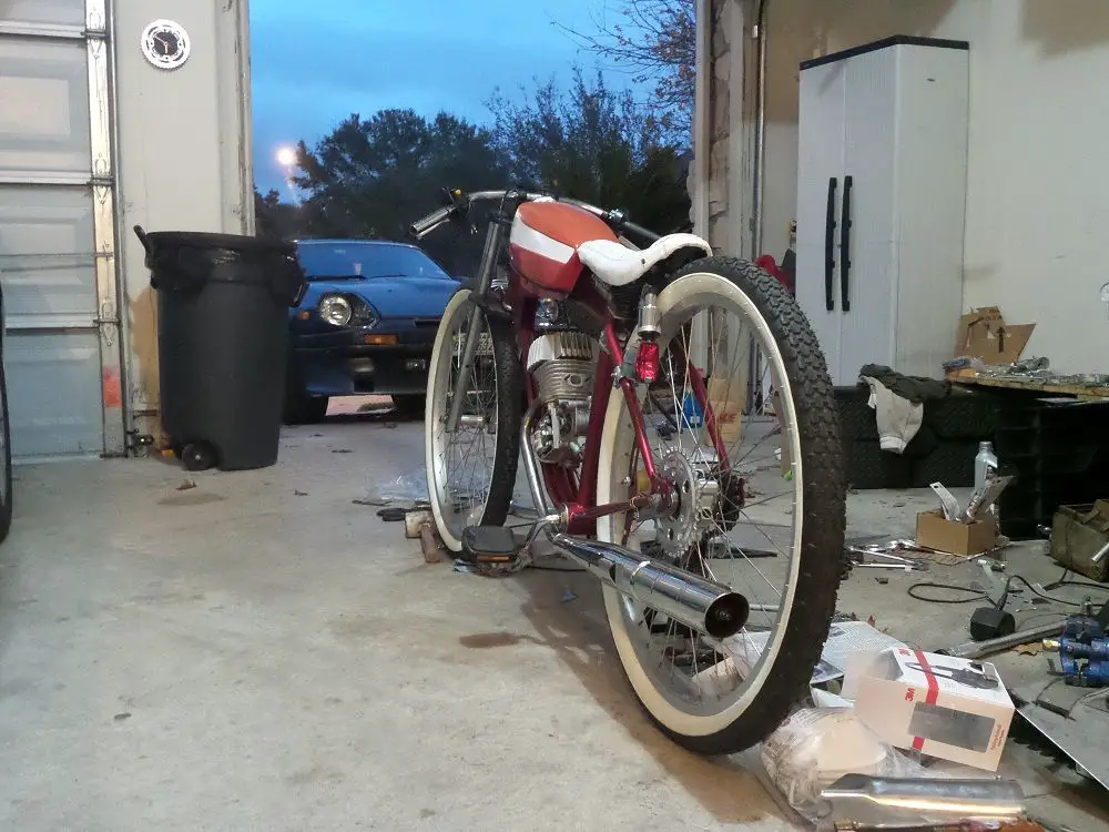

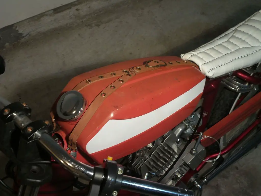

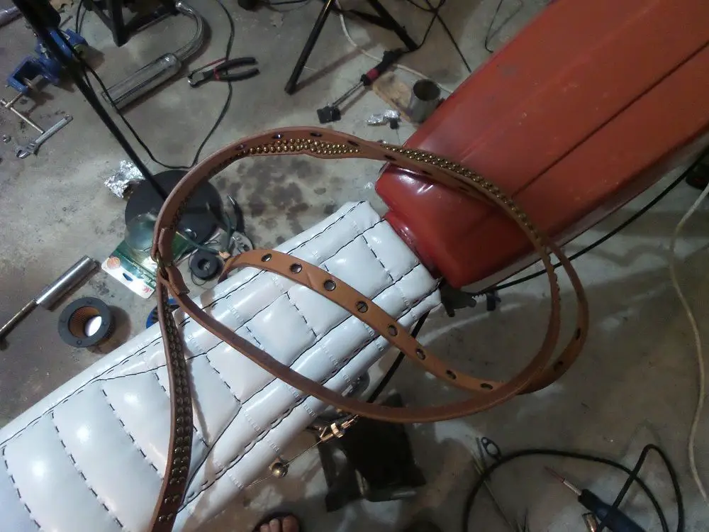

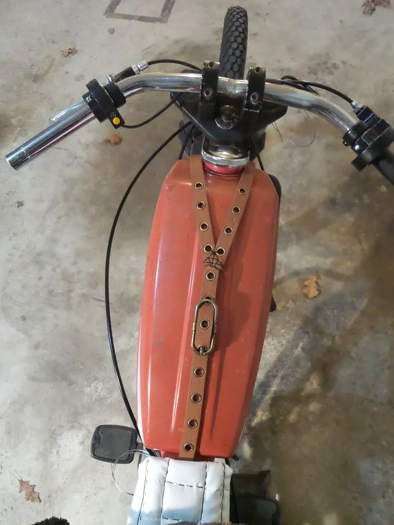

Got a really long ladies belt for a dollar at goodwill to make a cafe-racer style tank strap out of.
I really didn't take much pictures of the in between process because since it's quite boring. It was literally just cutting it to length and sewing it.

That is an awesome exhaust mod!
What model puch exhaust did you use?
Just one like this?
http://www.ebay.com/itm/Puch-Stock-...ash=item1c5b1cd526:g:ztAAAMXQ1ZhTerPH&vxp=mtr
(it looks simliar)
Pretty sure the baffle / tip part is all the same. I bought it on ebay myself as a "moped" exhaust, it was only later that I found out it was puch / its brands. The "header" part is probably different but You'd have to modify it to fit anyways. Now do be aware they are pretty long and somewhat heavy. Plumbing it to fit nicely on the bike was a pretty big pain.

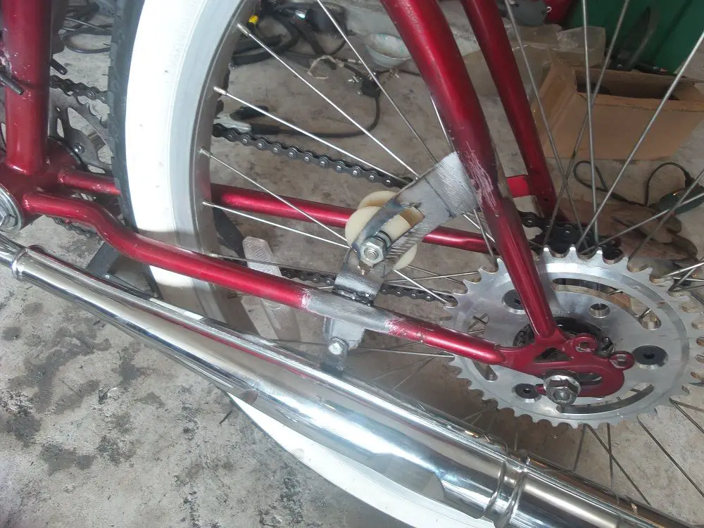

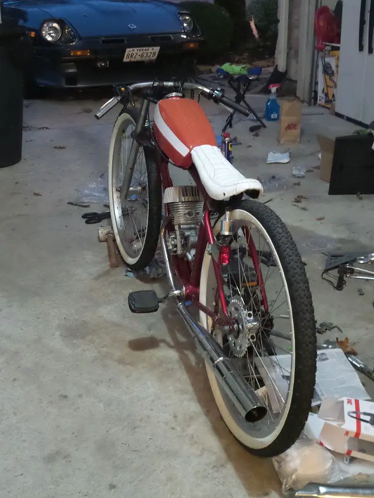

Well, good news and bad news.
Good news is that it ran, and ran FANTASTIC.
I was so EXCITED that I completely forgot to take a video!. The large baffle and the exhaust really makes it sound like a machine rather than a toy or a weed-wacker.
It pulled a lot more than I could ever imagine (110lb 5ft tall kid with a 36T and 26"+2" Wheel / Tire... Yeah... It goes...)
But, After about the 5th time roll-starting the bike, this happened.
The force put on the bottom chain on a pedal start was a LOT more than I though, causing the thing to just bend like jello.

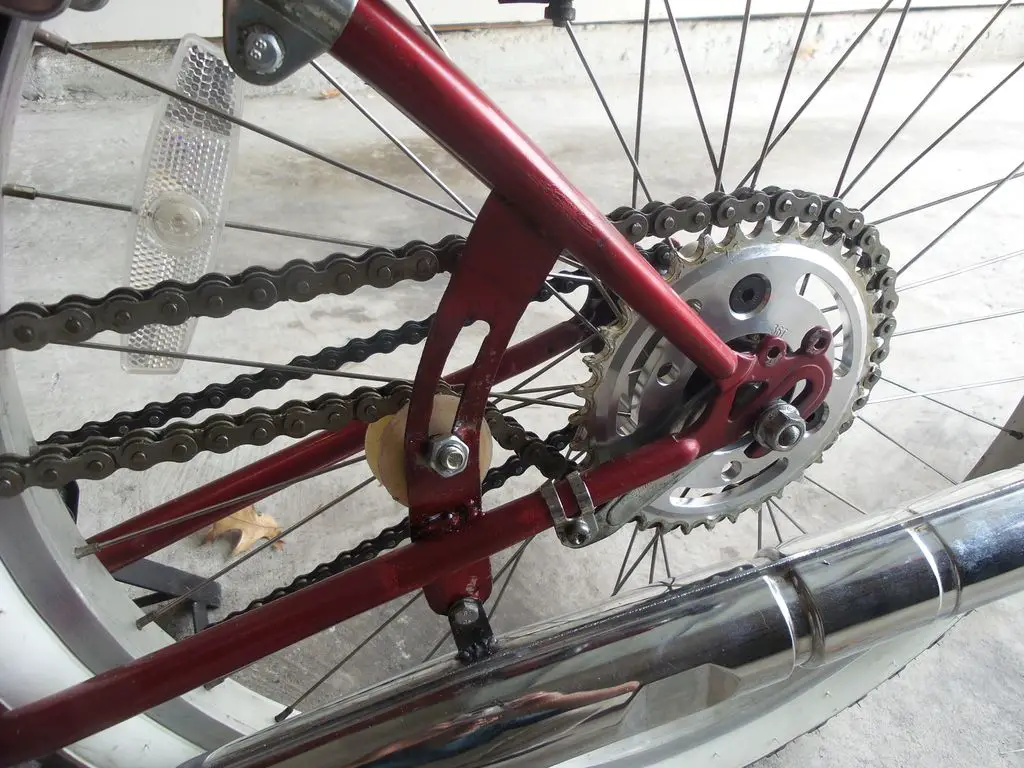

I had to think about this for a while, but understand now. The pedal start ia right side chain. Top tension on chain. Then from hub of wheel transfer to sprocket left side. Then chain is bottom tension trying to jump start engine.
Can there be a pull recoil start and engine idles with auto clutch?
The need for a chain tensioner, could it be eliminated?
Beefing up the metal welded to hold the tensioner and adding gussets somehow, is that something that is wise? What I mean will it take out something else as a result of one fix. I don't mean to be knocking what is already there, but do you know if others have had any issues with similar.
If you have picture to show how the chain with the tensioner is from front to back to see how aligned it is, I would be interested. What I mean does the idler wheel on the tensioner only keep the chain raised up and not guide away from hub sprocket.
Forgive me if I don't know much about the chain drive, I've always used v-belt and sheave. Chains I use are of very short length on jackshaft.
MT
Oh before I forget... really nice build... the gas tank... how you make custom cable ends!!!
There were a few things at fault that I should have saw coming.
1 - Compression ratio has been raised to somewhere around 11:1 (It's a guesstimate. about 6cc combustion chamber) And because of this, the "pedal start" is a lot more violent and harsher on the bottom chain. Now, the head DID come with a decompression valve, which was the whole reason I bought this particular Puch head but realized that the hardware is missing and I can't seem to figure it out.
2 - The chain tensioner is more or less needed for clearing the rear-bottom left tubing. I made the engine mount intentionally low for center of gravity sake and this was the result.
3 - The tensioner was alligned, but the steel sheet I used wasn't thick enough to take the "pedal start", bent, tensioner went out of wack, and the chain derailed from the sprocket.
4 - The tensioner was too close to the sprocket, making it vulnerable for the chain to eat the sprocket. It seems the sprocket don't want any more than half the circumference covered in chain.
Tommorow, I'll make a new tensioner out of thicker material with a better design, this time, a short tensioner closer to the tubing and out of a square tubing for the sides to act as a gusset.
