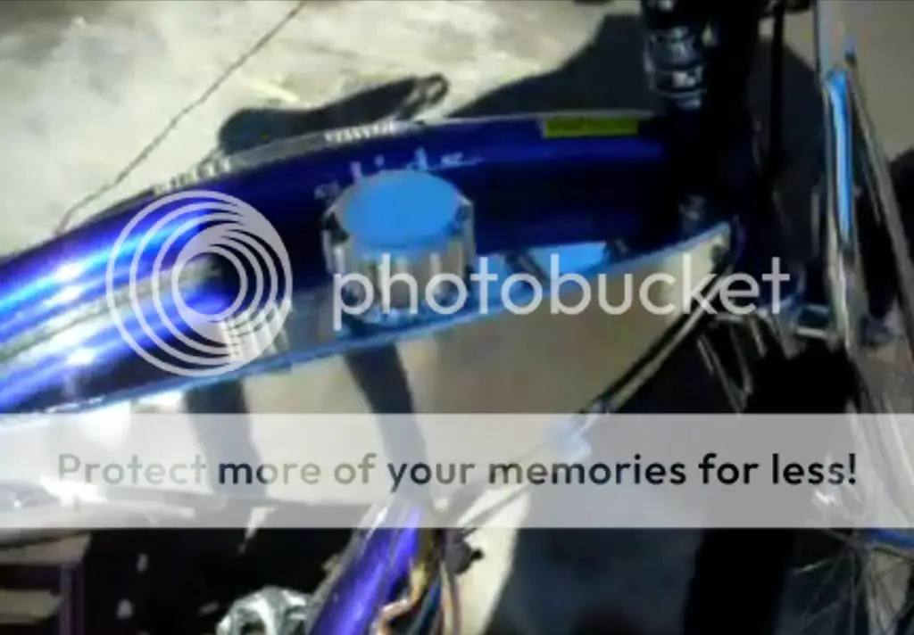

MabMan sent me this lol
attachment.php
The bike comes with a standard 2 liter tank and may or may not get 6 miles to the gallon? Is this correct?
