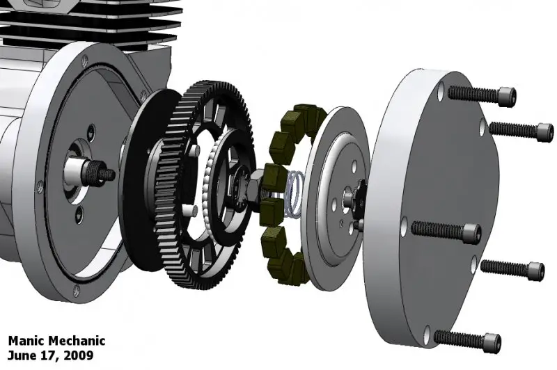

Rg have you removed the right side cover and watched for movement when squeezing the clutch lever? You should see the plate move as you pull in the lever. The flower nut can be turned counter clockwise to loosen the clutch, lock the lever in and it's easier to turn the nut. Back it off a few notches at a time.

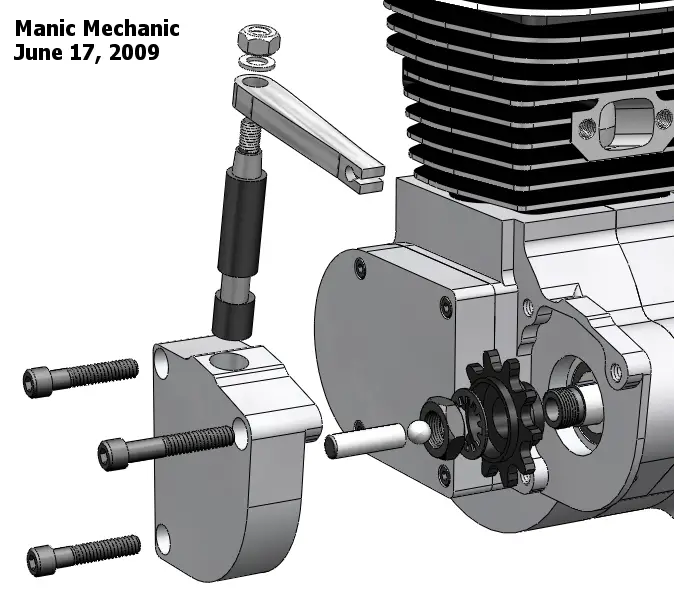

One thing to check. Maybe you can watch a video to see. There is a slider that the clutch lever bar presses against inside the drive sprocket. Could have fallen out at some point.
There is a shaft that goes through the engine from the sprocket side to the clutch side, the shaft is hollow with a pin inside. On the Chain side you’ll find the bucking bar and one ball bearing. The chain cover has the lever with a cam lob on it, as you pull the clutch everything inside the clutch shaft is supposed to move to the right. The clutch plate is mounted on the end and should move.

With the clutch handle pulled in the plate should release from the big gear so it turns with the rear tire, if not remove the lock screw and turn the flower nut to the left.
I have heard the part referred to as a ball but in my single piece jug engine it's a cylinder that fits under the cam. It might have fallen out at some point.
