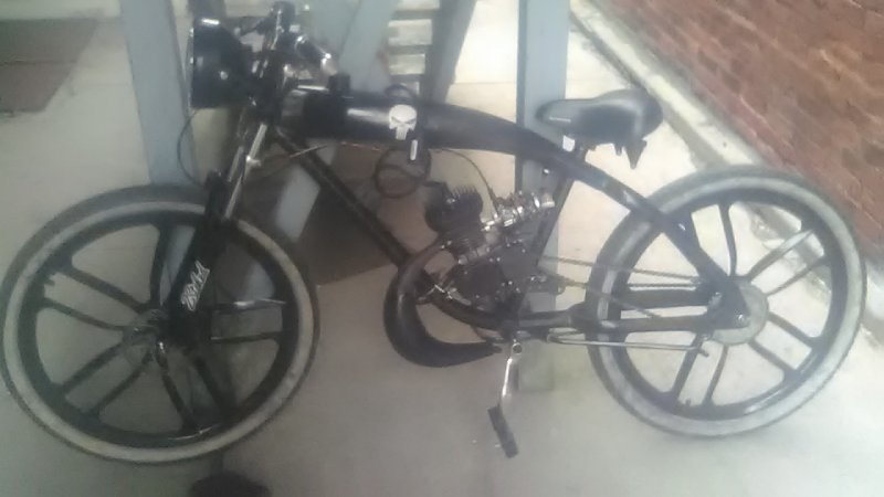

Thank you for the descriptive post as to why these are the cheaper steak, does it taste good? Does it get you to work? Some of us may have two grand for a build but not two grand for forks, I'll attach some new crappy photos from my phone with the mags and hydraulic tektro disk brakes like I said good year heavy duty tubes, Kenda makes a bicycle tire with motorcycle street tread, those are on the way

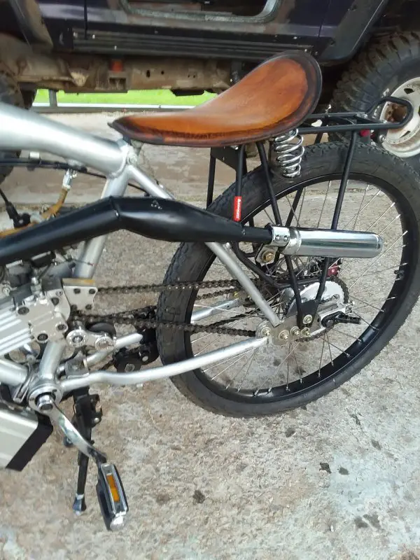

Your suspension is very interesting there's alot going on in this picture. I think I'm seeing a barba racing motor? The silencer would be nice for me to continue using this thrust pipe, looks stock which I definitely have as well as a welder. Looks like a moped drum hub? There's alot going on there that is a beautiful, intricate bike

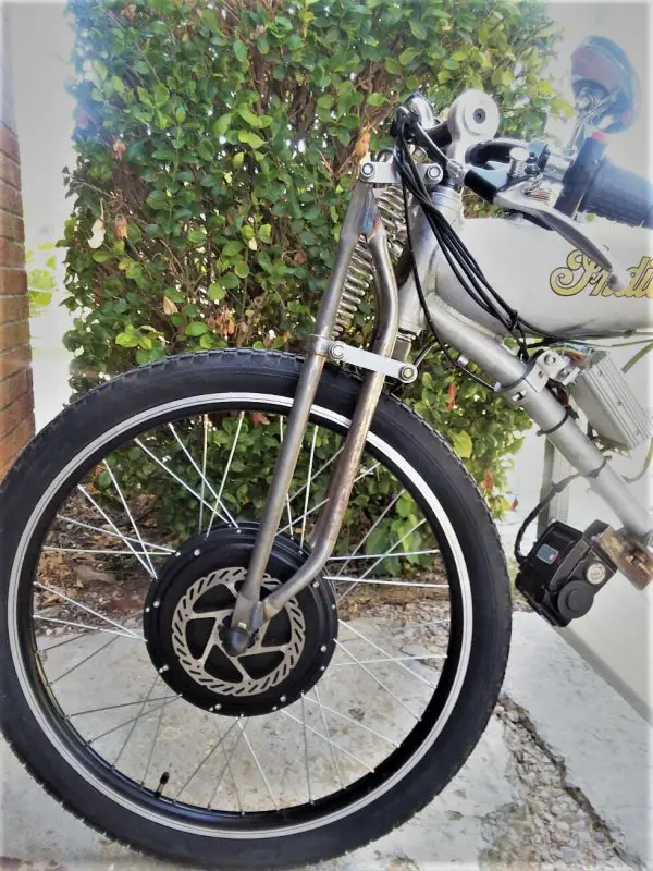

Thanks Noah. I'll post a front end photo which will help. This bike is an electric hybrid and also think the hub e-motor looks like a drum brake, but actually it's disk brakes front and rear. The rear hub is billet aluminum with sealed bearings from Ghetto bikes.
The x-chamber is a thrust pipe, stinger shortened with a kit muffler attached. Really quiet. The motors I personally build, many mods a few of which are reed valve, window piston, extra cylinder port, German precision bearings, balanced rotating components and a welded stuffed case, porting and slightly higher compression etc. All the external stuff is just stock as ordered, heads, Dellorto, RSE reed and as much extra finned aluminum as I could bolt on for extra cooling & it looks ok too. Two things bolted to the case is a spring chain tensioner and behind that an aluminum case saver which could be called a life saver as well. It's purpose is to prevent chain to case lockup should the chain break. These are common factory motorcycle incorporated devices for bikes that run tight chain to case tolerance at the output sprocket and the China girl engines are the tightest chain to case that I've ever seen and therefore dangerous. Rear wheel lockup is not as dangerous as front wheel but it's not good. These really work I lost a fast link twice (installed clip backwards) & both times the chain spit through and cleared without my noticing the chain was gone, engine rev'd and progress slowed the chain was a few hundred feet back up the road.
Photo is old before I changed the battery mount and painted the aluminum wheel. The lithium battery is under the down tube and saddle bags hold two more...I have room for 5 total on long rides they are 20 amp hrs. each. good for lots of miles. The modified motor is a fuel hog, but with the 38 tooth sprocket at 35mph cruise I can squeeze 100mph per gallon with a little help from either pedaling or 500 watt, wink,wink, e-motor.

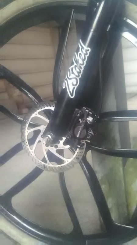

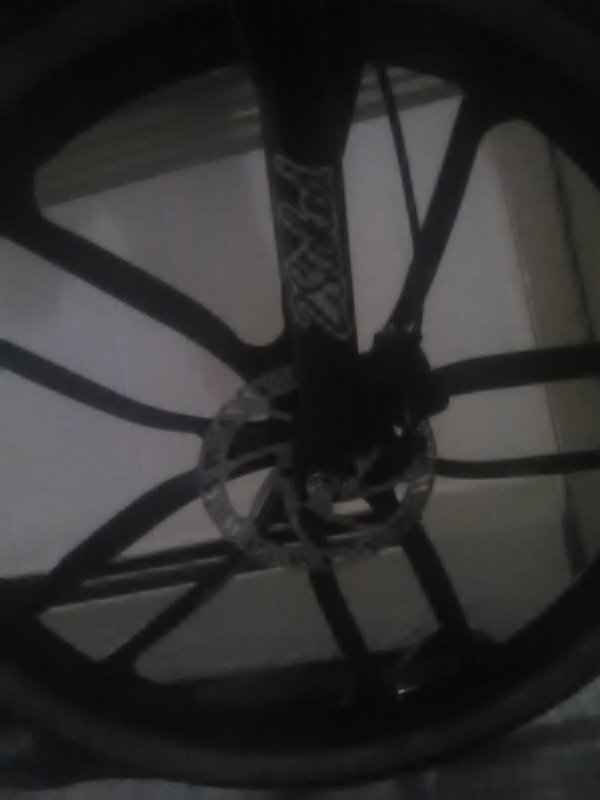

Okay guys here it is with the mags and hydraulic disks. I thought I was running a 36t before turns out it was a 40 so maybe I'll get some more speed with the 36 on these mags, definitely had some unexpected chain work lol shortening it, it's really looking and riding great I downjetted and it's just a monster jumps from under you

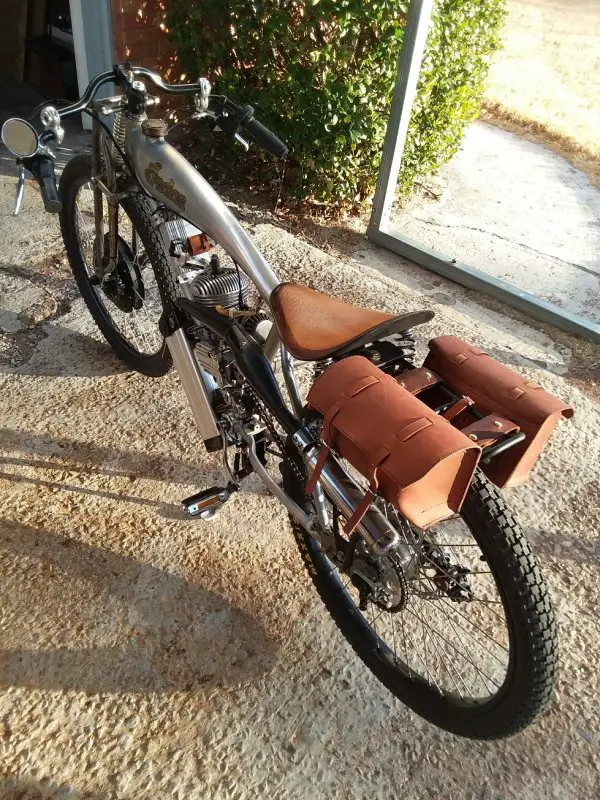

The hybrid uses Samsung 18650 3500 mah cells Cannonball, 36 v.16amp hr pack on the one mounted to the down tube, but the other packs are 20 amp. hr. I also use 48v. 20 amp hr. pack on another bike and think I incorrectly stated the voltage on the hybrid in an earlier post as 48v when it is actually a 36 v. hub. sorry for that. Same 3500 mah cells on each pack.I've a friend that made the 20 amp packs up as a favor to me (though not for free) each pack has BMS and they're relatively compact. My controllers are just the typical hub kit variety, which I fully intend to upgrade, but the kit units have performed adequately on the bikes running the 36v. e-hubs, one set @ 500 watt and the hybrid @ 750 watt. The 48 volt 1000 w. hub has reset several times under hard running on the ugly fat tire bike, so it gets the first controller upgrade...soon.

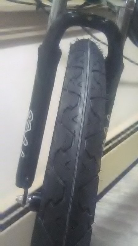

Kenda makes a tire with motorcycle style tread for street riding I mounted them last night gonna test em out after work today
