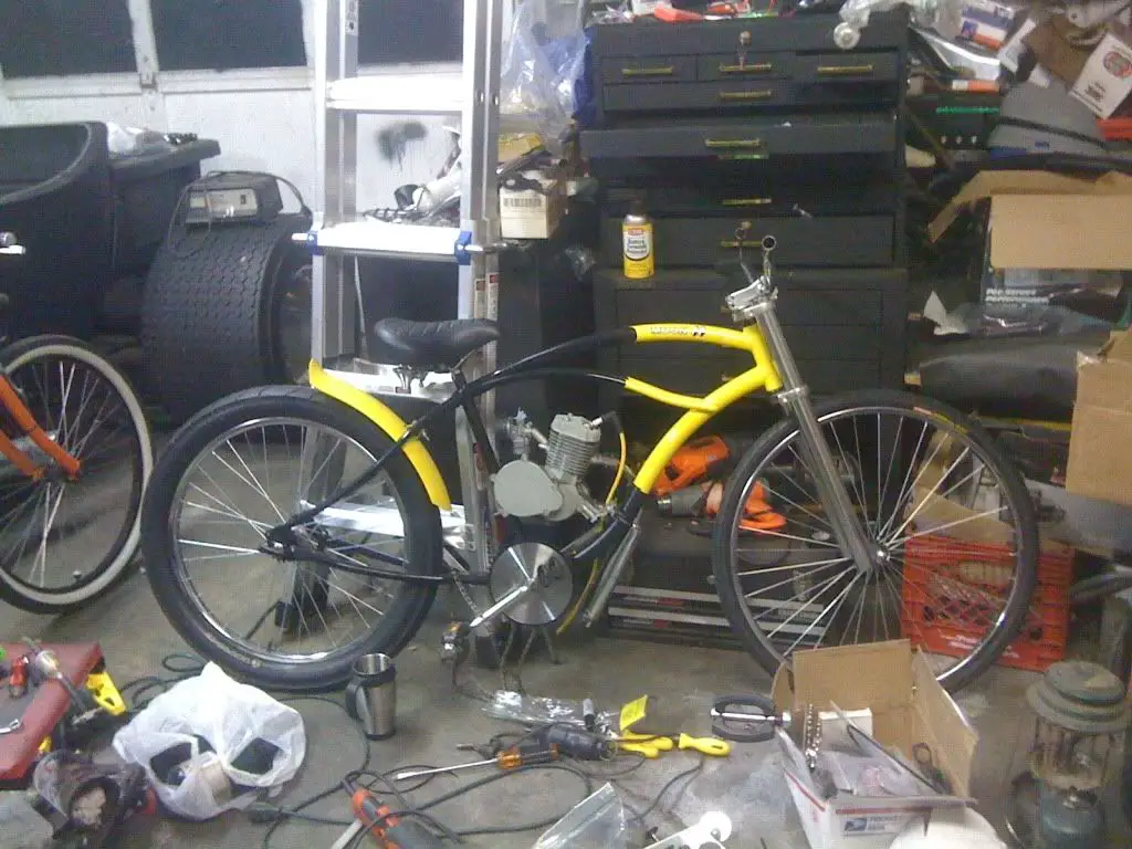

Thanks Barely im nodding off as im typing lol...Your rollfast bike is awesome. I love it. Glad you made a couple videos,they are cool..This bike will have the nuvinci hub and it kinda bothers me you wont be able to hear it shift like yours. But im also building a mooneyes bike that will have a 7 spd nexus and that will have the sound im craving to hear,shifting gears with that sbp exhaust OH Yeah cant wait.. Jim redid my rear motormounts wider to fit the newer slant head motor for free. What a great bunch of guys at sickbikeparts, thanks again guys. Here is pic of bike 1yr ago and now in ever lasting mockup stage

Kinda like the yellow one got a bike lying around like that and those same forks now I get an idea how it will look lol. For a minute I thought I was getting a peak at one of SBP new design? You got some fun builds there there gonna look great!
