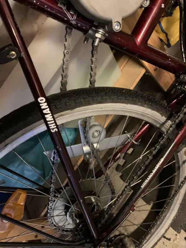

So I did some riding today, I have now put 9 km on the bike, it’s running fine but it got some small issues. First of all the chain bounces up and down when I ride, (I don’t know if it’s normal but it is shaking a lot up and down with a distance of maybe 2 cm), however when I go fast (30 km/h) it runs in a nice line. I don’t know if it it’s either normal or a problem, but it seems odd.

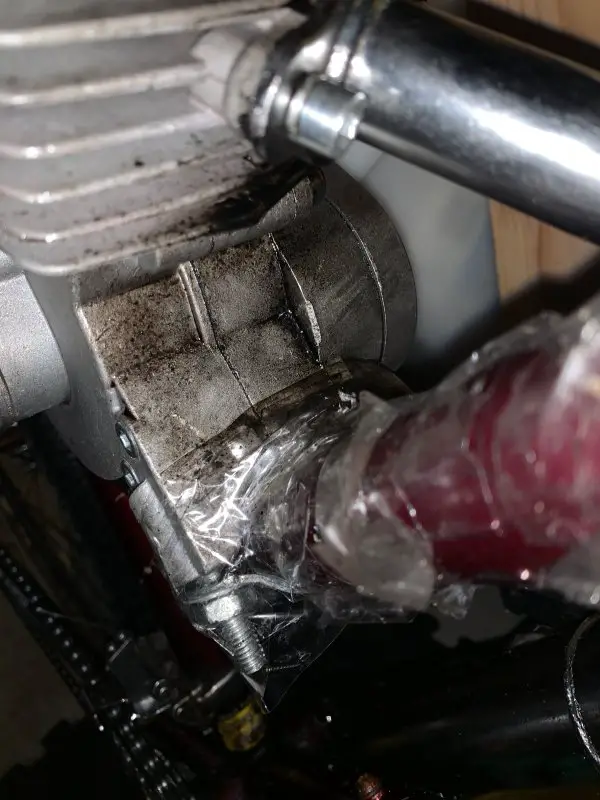

Secondly, the oil leak haven’t stopped. It’s a lot better now that I have reduced the oil percentage, but it’s still spitting out oil around the cylinder exit (this might be because the gasket ripped and I’m using a old thin metal one).

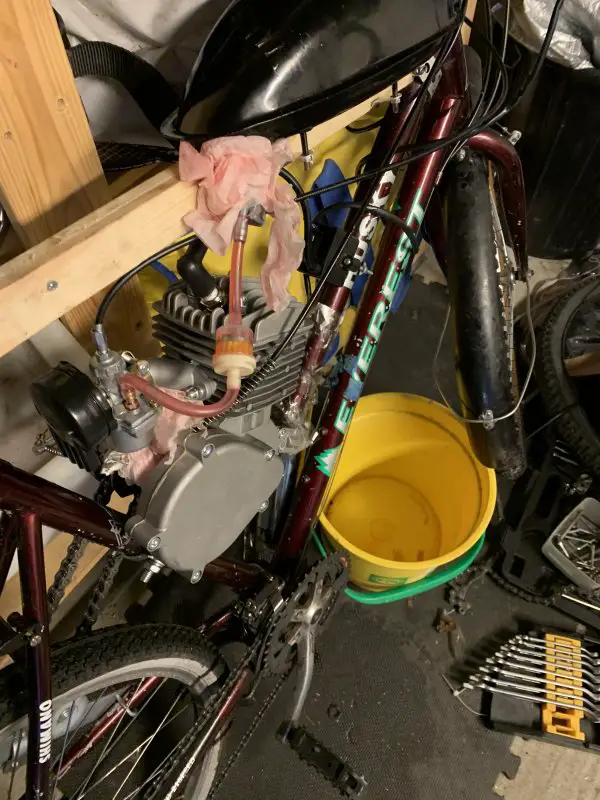

Third of all, the tank haven’t completely stopped leaking. I put some paper around it last night and today it was pink, indicating the leakage. It’s only leaking from around the exit part of the tank, but I drips and hits the wires and runs down to the carb. This is annoying as I’m loosing fuel, and it’s making the bike dirty and wet.

Petter said (I don’t know if it’s normal but it is shaking a lot up and down with a distance of maybe 2 cm)
This is due to slack chain which is not constant because the rear sprocket is not perfectly concentric, that is why I prefer a spring loaded tensioner which is capable of maintaining constant chain tension.
In your case the shaking stops because at 30 km per hour the centrifugal force of the chain riding on the sprocket tightens the chain and removed the slack. This is why every thing smooths out at high speed .
It probably will never stop completely but soon it will be so small that you wont worry about it.
The thing you have to resolve quickly is the fuel tank leak. find out where it is coming from and seal it or drain the tank and get another one.
