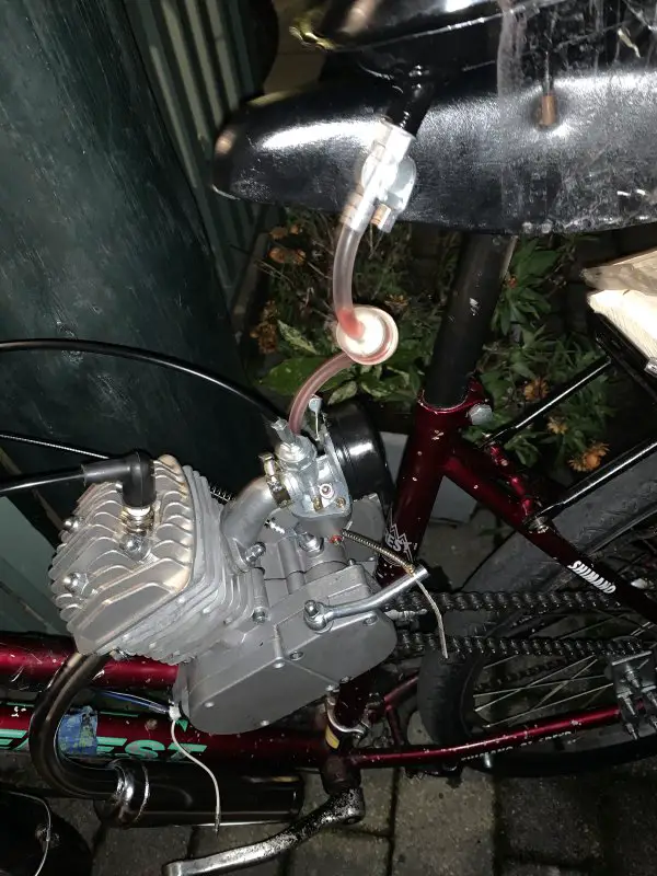

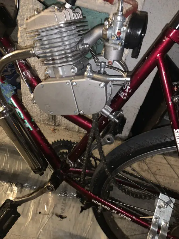

Here is a small picture of the current setup, and the small amount of gas in the fuel line.

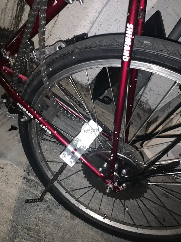

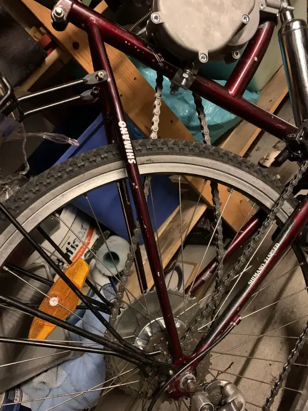

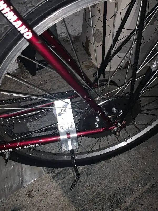

Update, bike has broken down. It didn’t even last the first day. I am devastated. I was riding on this road and suddenly I just hear a loud sound from the wheel, the chain tensioner got caught in the wheel. The chain snapped and the wheel lost some of the metal bars. All this hard work for nothing, I don’t know what to do anymore. I even screwed on a wooden pillar for the tank.
picture before the trip and after:

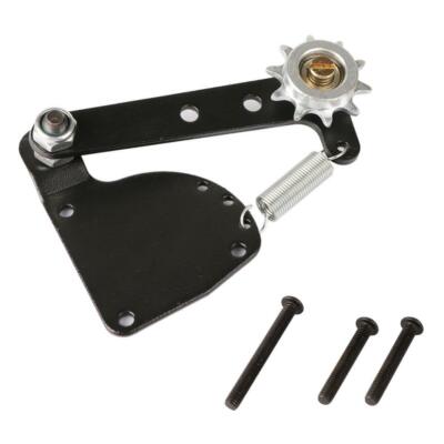

Sorry I should have mentioned it before that those type of chain tensioners are a menace. That is what they do; move into the wheel and get caught in the spokes. I found that out very early when I noticed it was becoming loose. I even drilled an extra hole through the bracket into the bike frame and put a small bolt to lock it from rotating. Eventually I gave up on that type of tensioner and mounted one that attaches to the engine and that has been working fine so far.
You are lucky that the chain broke; it could have been much worse and taken out the spokes, but they appear to be ok in your after picture of the wheel. Those bars only mount the parcel carrier and you do not need that any more.
You learned a valuable lesson today and that is to constantly check your bike before every ride for loose and damaged parts.
The chain can be repaired with a chain breaker tool and a new link.

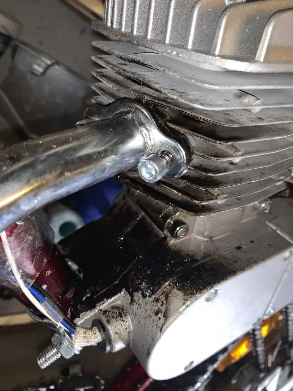

I know I'm late to The Game on your starting problem, but one of the perplexing issues with my engine was a leaky head casting. I had spark, fuel/air/oil and LOTS of pedaling, and it would sputter/half-run, barely with enough power to move the bike along at jogging speed. Once I ordered a new stock head, BAM! Worked like a champ.

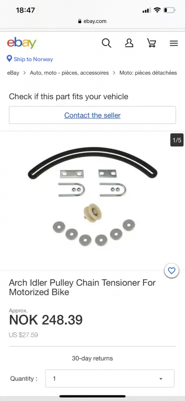

Thank you guys for your tips, i refuse to give up. I am getting the spokes fixed, I have ordered a different chain tensioner and I have ordered a new chain. I appreciate your advice and motivation to keep the project going. Here is the type of tensioner I bought, this doesn’t allow the tensioner or chain to come in contact with the wheel. Do you recommend getting any other upgrades? I am sick if the stuff breaking.

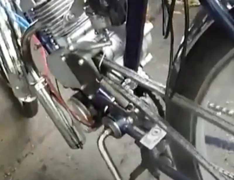

I personally have no experience with that type of tensioner but I have seen them around. I noticed from pictures of your bike that the chain seems to be too long to my liking. I like to make it as short as possible and limiting the possibility of it jumping off the sprocket.
This is the type of tensioner that I have on my bike.

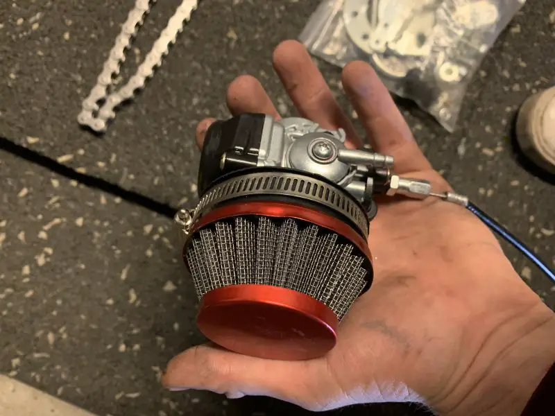

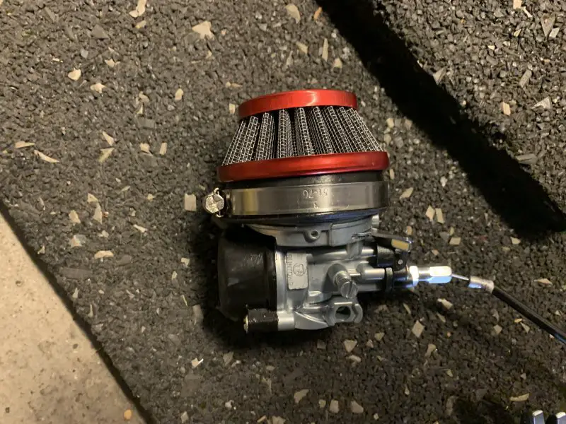

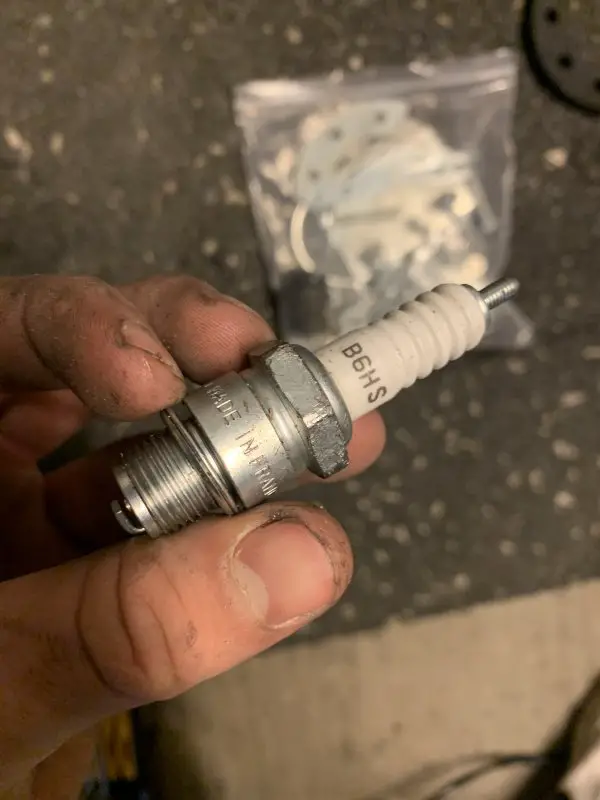

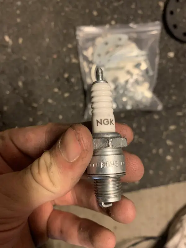

I’m getting a new wheel, just thought I’d les you guys know. I have another question, I have a different carburettor and a different spark plug thank the stock ones, do you recommend swapping or having it the way it currently is? Here are the carb and spark plug:

The plug is a definite, if it runs good with the stock carb it will be best to get some miles on it first.

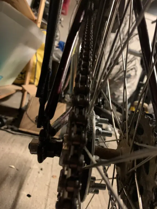

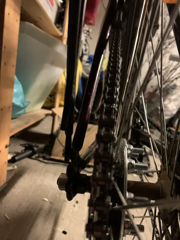

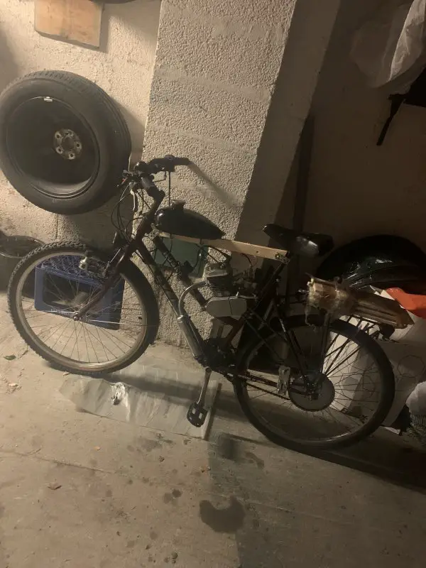

Just got the new sprocket on to the wheel, don’t think I can get it much better than this. Now I just gotta wait for the chain tensioner. Does it look okay?

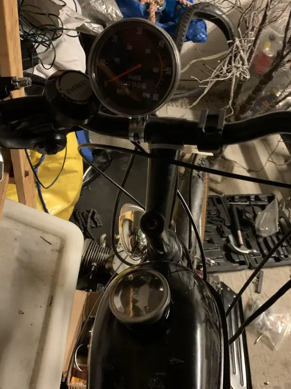

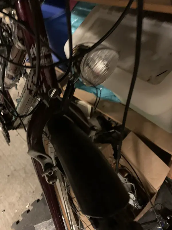

So i did some work today. I fitted s speedometer, a light, and most importantly the wheel and chain. My friend helped me true the wheel so the wobble is barely noticeable. Now I just got to wait for the chain tensioner to arrive.
Is the wheel a new one or did you true the old one with a spoke wrench.
