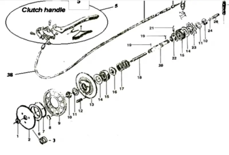

It appears to me that there are a few parts missing from your clutch assembly. Item 3 and maybe 6 and 7 if you look at my picture you will see what I am referring to
Thank you. However I don’t have any of these parts, and I have not removed any parts. What do you recommend? Can I order any of these parts, or is the project simply not gonna work? And is the clutch essential for getting in started or can I just start it with the engine engaged? Also do you have any ideas on why it isn’t producing any power? The piston simply just moves. Do you think there is any hope, ore is the engine broken?

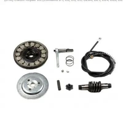

These parts are easy to find and ae not that expensive. I buy my parts at https://www.motorizedbicycle.ca/
There must be similar suppliers in your country too. The engine will go with the clutch engaged but you will not be able to stop with the engine running.

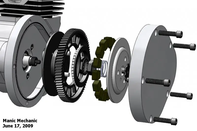

Petter you are trying to overcome the power of the big internal spring, you can not do it without leverage. Try this, hold the clutch lever in and see if the flower nut will screw in more. You do need the spring that goes between the clutch gear and plate.

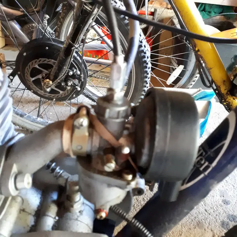

Every thing looks good but now I am wondering if the needle valve is lifting out of the main jet when the twist throttle is opened the throttle cable does not look correct where it enters the carburetor. There should be no slack and no gap between cable housing and carburetor body, just a direct pull when the throttle is twisted. Perhaps the needle has become unclipped and is not rising when the throttle is being opened. I just took this picture of mine and this is what it should look as it enters the carburetor. You should try to catch wasted fuel in a container for future use and safety reasons.
Is the needle thing supposed to move with the plastic? Do you think mine is placed wrong? Take a look at the video below and check if the needle position is correct or wrong.
I can not tell very much from the video. But Yes the brass needle is supposed to move smoothly with the plastic cylinder when the throttle is opened by twisting the handle bar grip. If it is working like that when you do your starting tests, your engine should start and run.
The brass needle is tapered at the bottom end and when it is at the bottom position it blocks the main jet so no fuel is allowed in the venturi (passage leading to the engine cylinder). As the plastic cylinder and needle move upward more and more air and fuel allowed into the venturi as the throttle is applied.
For the engine to start and begin producing power both the needle and plastic cylinder must rise with the application of throttle.
The engine can be made to idle faster if the idle screw (screw with spring) is turned clockwise, This process lifts the plastic cylinder and needle valve if everything is assembled properly. Your engine will produce more power when you attempt a start.
