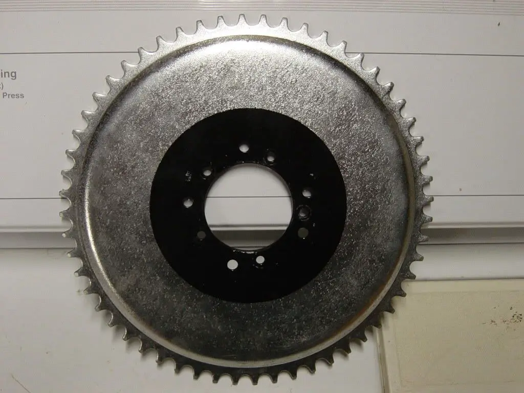

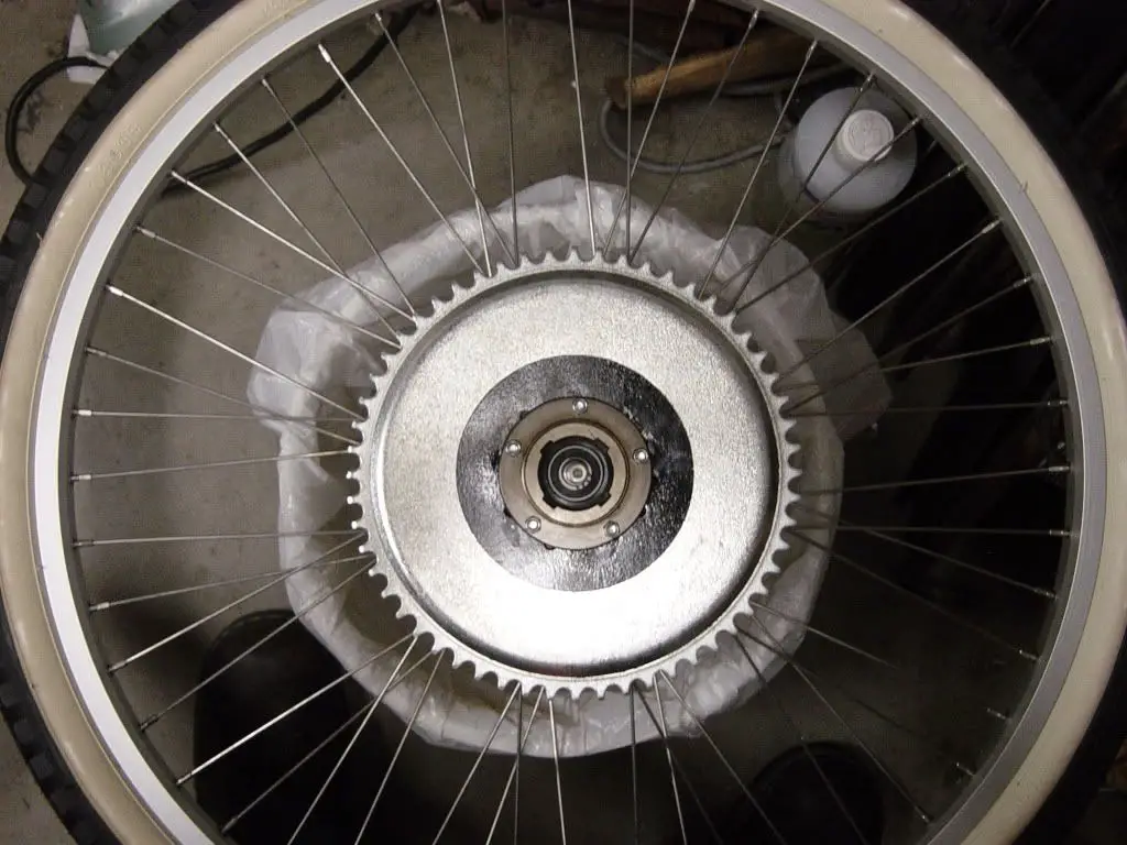

On a better note I got the rear sprocket back from the machinist. It fits the Staton left side freewheel absolutely perfectly. Now to weld up a few of the original 9 holes in the sprocket and drill it for the 5 hole freewheel.
2 weeks ago I paid a good ol' boy (retired master tool and die maker) $20 to machine the hole in the center of the EZM sprocket to fit the Staton freewheel. :D
Other local machine shops wanted anywhere from $50 to $80 to do it, It's a $30 sprocket for cry'n out loud! :O
I got back into town Thursday after a 4 day vacation.
Friday I welded and drilled the sprocket bolt pattern to fit the Staton freewheel, it went from 9 hole to 5 hole mounting.
Saturday I painted the sprocket center to protect the welded areas from rust

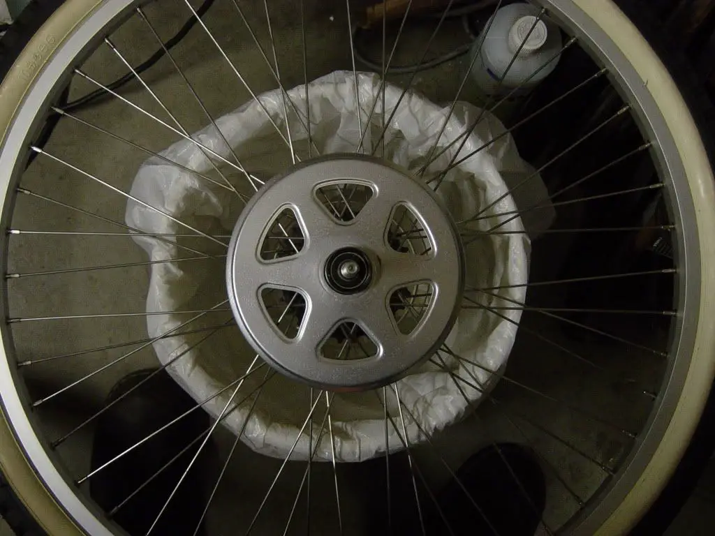

and cannibalized an old metal spoke protector from a long dead rear wheel to mount in between the Staton freewheel and hub. For the price of that wheel, I'll be damned if I am going to risk the chain eating up the spokes if it ever derails.
Today I sanded the bad rust off of the spoke protector and put it in a bath of "salad dressing" to clean all the rust off of it. Tomorrow or the next day I will paint it.

Today I installed the mount plate in the frame and started working on the rear wheel engine sprocket. I have the sprocket's dished side facing inwards and the sprocket mounted inboard of the freewheel and I still have about 1" of clearance between the tire and the chain line. I hope it won't drag the chain against the chain stay.
