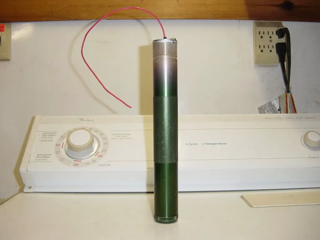

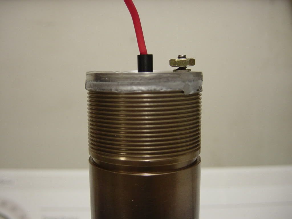

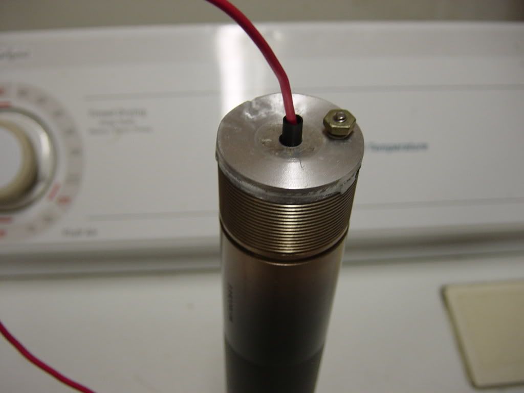

    After enjoying the ride I worked some more on my MagLight battery holder.
    It was an old 3 cell size D battery one. Now it's a 4 cell battery holder that will be water tight and easy to mount and blend into the bike.
    I got some Alumiweld rod from Harbor Freight to attach the top cap, and soon I will close up the switch hole too.
    I have never used Alumiweld before. It is easy to use. I recommend it anyone who needs to do a simple repair or non structural joint on aluminum to give it a try. Who knows, I might just try my hand at fabricating an aluminum gas tank in the future.
    Here's some pics of it. I know, I know it looks like a pipe bomb. :)~ I didn't think of that until after I took the pictures and checked them out on my computer.

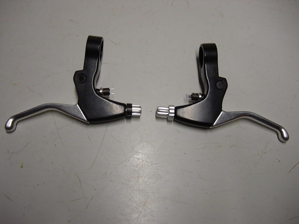

    Tonight I added switches to my brake levers. I roughly followed the instructables link shared in the Lighting and Electrical section by abikerider. http://motorbicycling.com/showpost.php?p=354587&postcount=8
    The biggest deviation of the instructables I did was using a letter "C" drill bit instead of a 1/4 inch one so as to cut deeper, stronger threads into the soft aluminum.
    A 7mm x .75 tap needs a 6.2mm hole. A "C" bit falls in between 6.2 and 6.3mm, which is considerably smaller than 1/4 inch, 6.350mm. With threads this small you want all the meat you can get! I don't own any metric bits so... use what you have, right?

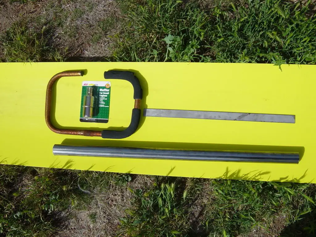

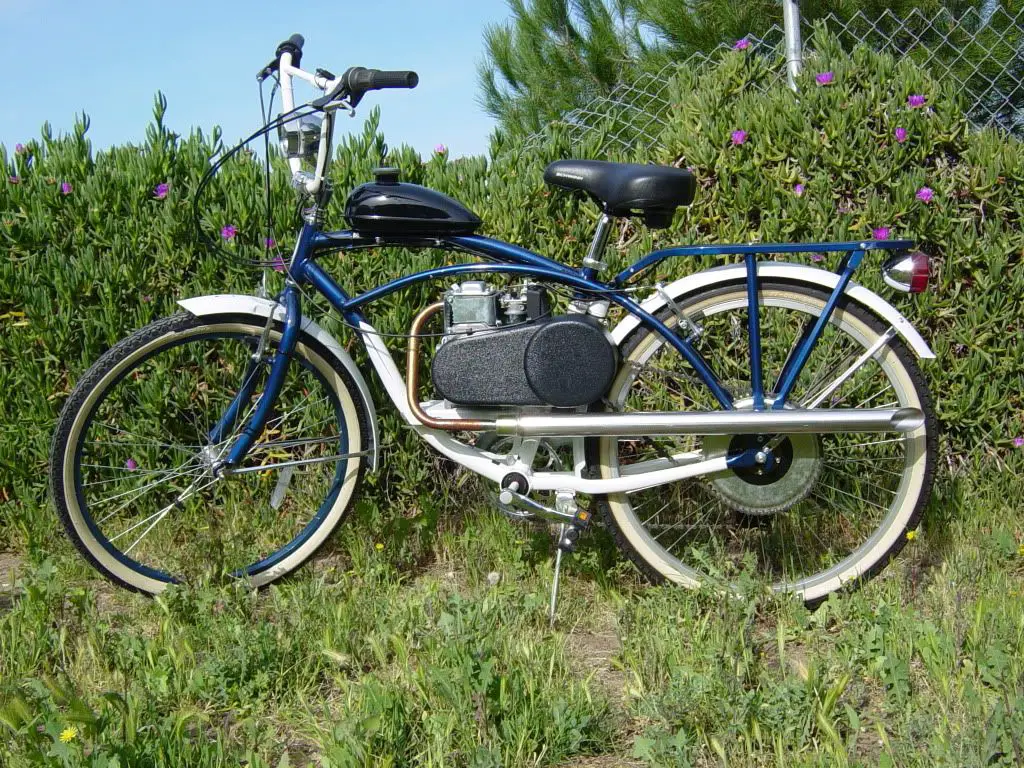

    I made an exhaust system for it over the weekend. It sounds more like a 250cc engine now rather than a 49cc engine and the sound volume is about the same as the kit muffler.
    Here are the parts used, the handlebars came off of an old exercise bicycle:
    [​IMG]
    And here is it welded up and on the bike. I think I want to get it chromed but that depends on how much $$$ it will cost.
    [​IMG]
    As I have made quite a few changes to the bike since I last posted any photos of it, here's the other side:
    [​IMG]
    Still not done with it yet, but I am happy with how things are turning out. :D

  12. killercanuck
    killercanuck New Member
    Joined:
    Dec 17, 2009
    Messages:
    1,749
    Likes Received:
    The long pipe looks awesome!
    Have you thought of some engine enamel for the copper? Something close to the frame color or white even, eh?
  13. azbill
    azbill Active Member

  14. GearNut
    GearNut Active Member
    Joined:
    Aug 19, 2009
    Messages:
    5,105
    Likes Received:
    2
    Thank you, both of you!
    The length I Really like for multiple reasons.
    1. Looks awesome!
    2. Puts all the noise behind me.
    3. Is the secret behind the killer deep, throaty sound.
    4. Long pipes make more torque at lower RPM's with a slight loss of horsepower at higher RPM's.
    It is a low RPM engine so that is a win for sure.
    The copper color on the handlebar - header is actually rust. I plan on getting it flame sprayed which will give it a very durable satin aluminum finish. I couldn't wait to see it built and on the bike and also hear what it sounds like so the rust is temporary.
  15. GearNut
