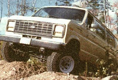

I had my own version, my E350 family van converted to 4x4:
