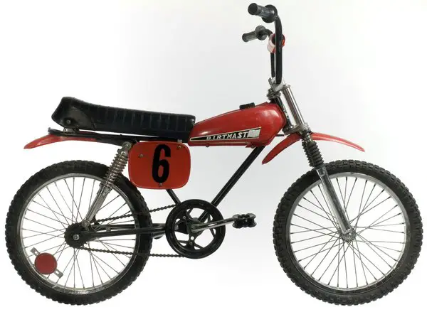

    This is what it looked like new (I'm pretty sure)
    [​IMG]
    The ride is a little bouncy, I'm hoping I can service the front shocks to make it a little better, and maybe match up a couple shocks for the back..
