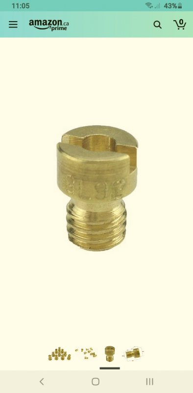

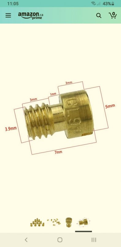

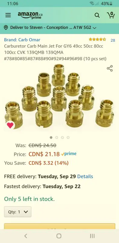

I cannot find anywhere that sells NT carb jets in Canada and doesn't want like 30$ for shipping. I'm not spending around 50-60$ to get carb jets. I found these on amazon and I am wondering if they will fit my NT carb. I already have micro drill bits and a pin vise, along with everything to solder. I am going to resize the jets myself however I don't want to do it on my only stock jet in case I screw up. I know the jets are huge but will they fit the nt carb? There's precise measurements of the jets in the attached pictures. I cannot simply measure my nt carbs jet as I don't have anything accurate enough. Thanks any help is much appreciated.

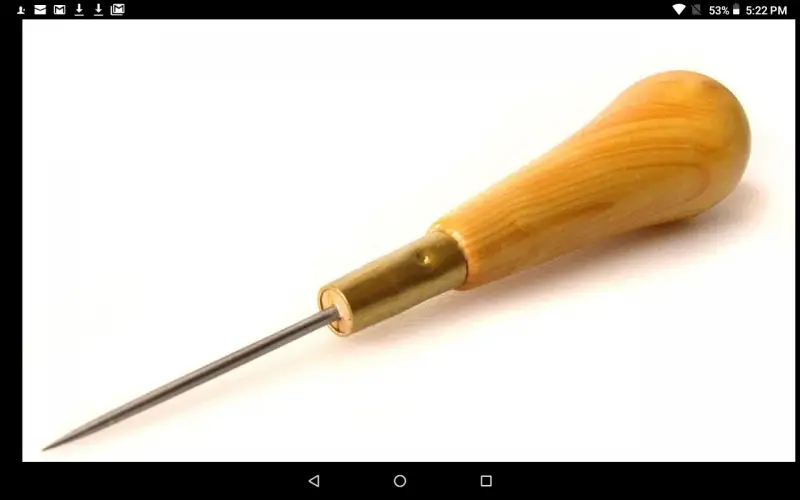

If soldering for the first time use a awl standing in a vise to stand the jet on, this will keep the solder from entering the area where the needle travels. Use a torch not a soldering iron, don't get the jet too hot, as soon as the solder flattens out remove the heat.
