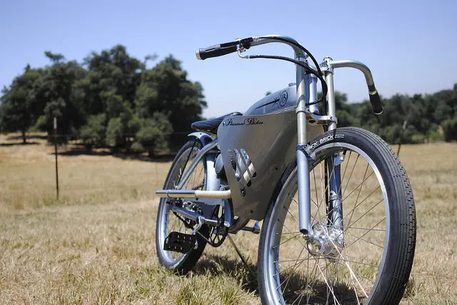

Phantom Bikes did a build with clipons:
They have a bunch of pics of that bike in their gallery. I'm assuming those are custom bars, but you could contact them to find out maybe.
