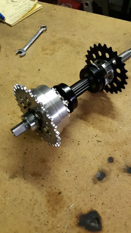

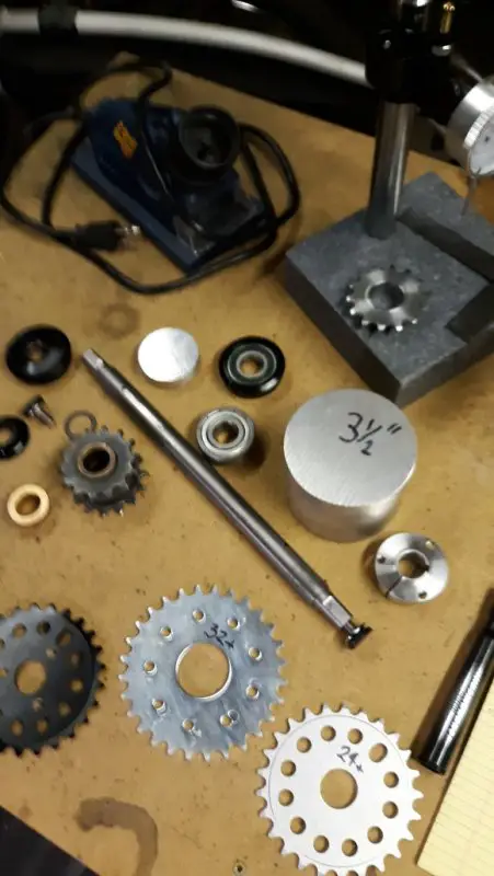

Another long drought between posts to this thread. I completed the reduction gear and bottom bracket assembly machine work which will replace the internal jack shaft I used for the 'Ol Crow electric V twin. Though the internal jack shaft worked well it was too limited in ratio selection range and involved quite a bit of time to switch sprockets. I will make at least one more for my Harley "Peashooter" I brought both bikes back inside the house to work on in the heat of the day under air conditioning. Mornings have been really nice but high today forecast for 100 degrees. If it reaches the century mark it will be our 6th. time this month reach the century mark. More in May this year than all of last year combined.

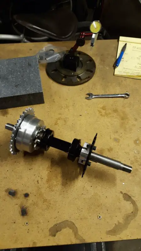

Tom it's never a problem to share for me.
I determined that the hop in the get along was eliminated with tailstock support, at least to the eye. The lathe spins it on the arbor well. As to measuring the sprocket run out there's a problem, this sprocket, the 32t, is not close to pristine as I used it on an early bike project and altered it to fit a 415 chain using a drill press to spin the socket while grinding it with a hand held angle grinder, not precise but quick. It worked but I can see the uneven tooth height that process resulted in. Measuring for concentricy will have to wait till I replace the sprocket with a new one, which was my plan to start with. This one is just to test ratios out and see how they perform on the 'Ol Crow. It's fine for that purpose. Also it's not flat by a lot, but tightening it flush seems to take all the wobble out. It's China girl kit "quality" so not so great.
The inside sprocket runs out good, at about .0015 or a bit under, but the real test of concentricity is out at the other end of the reduction drive, but the secondary chain line, to me, is the most important of the two as long as the numbers don't get too large.
