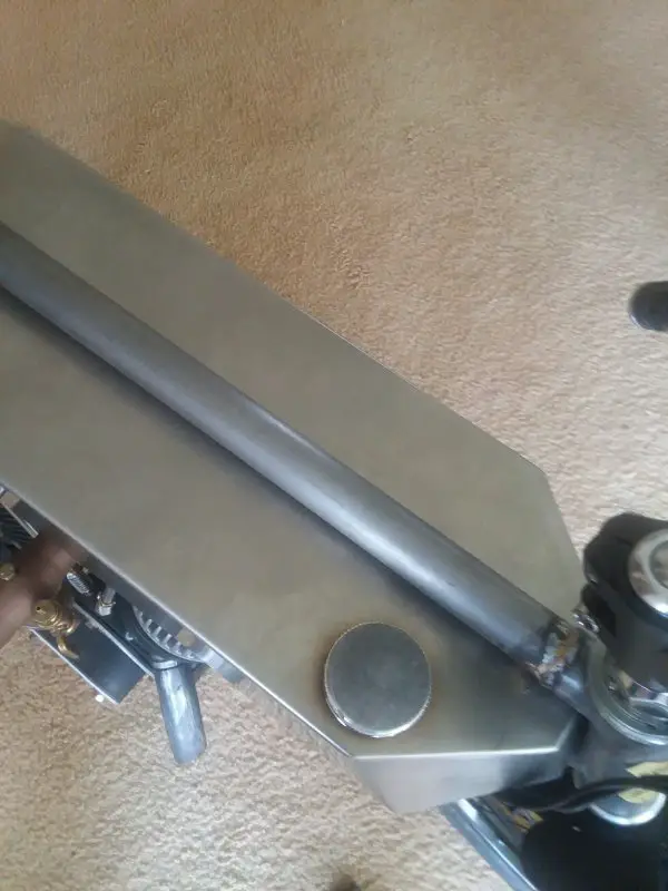

You may have noticed that the last photo (above) shows that the saddle frame bares on the seat post. I want the majority of my weight to be carried by the seat post and not the seat stays. The seat post is designed to carry the riders weight, not the stays. The seat stays still carry some weight and look board track proper, but now the load is spread out the length of the saddle pan.

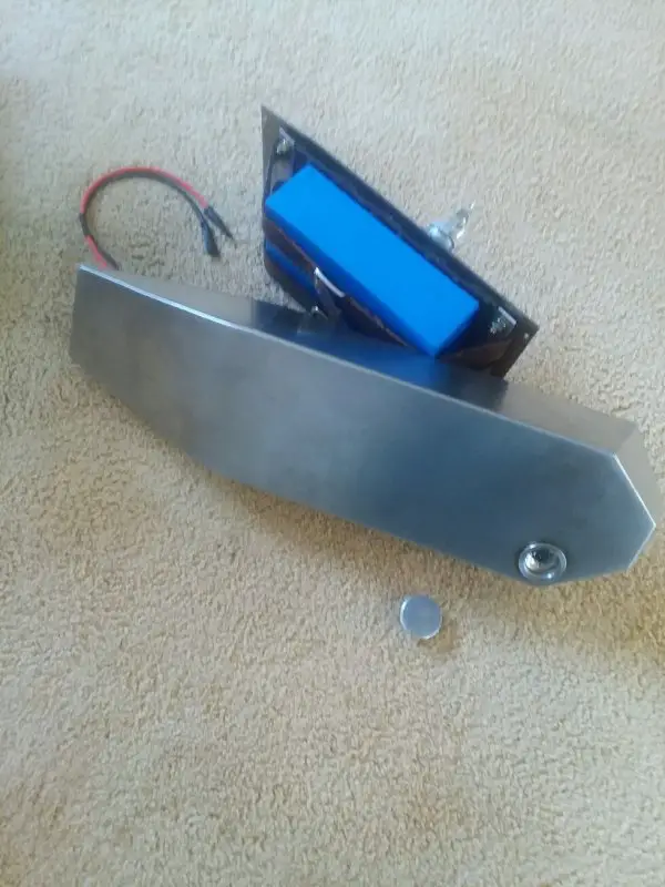

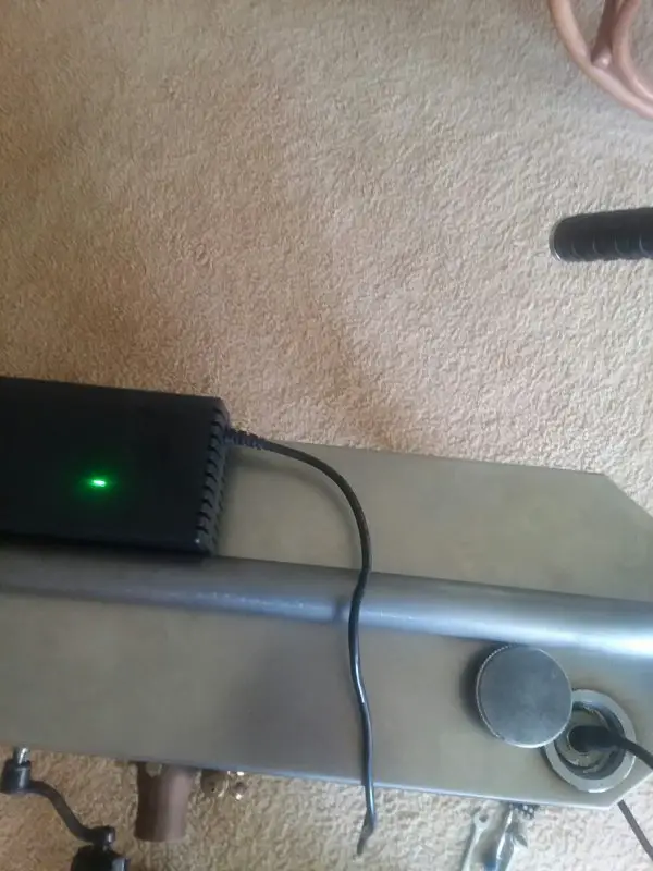

I've installed the battery tank once again; this time charged and fully functional, including the charging port under the gas cap. I used leather belts to hold the battery in fixed position for loading into the tank with tank inverted. I also installed a rubber mat under the battery so the pack can't sip around inside the tank housing with straps in place

Was worried all the standard holes in the sheet metal wouldn't work for you but I can see you put them to good use. As far as the frame stay tubes supporting weight I haven't seen any bend yet and your frame has the larger 3/4" upper tubes. I usually leave just 3/4" tube stick-out above the lug so a seat clamp can be used if the frame becomes a cruiser at some point. Letting this stick-out contact the seat support bracket will certainly take the load off the strut brackets. Everything is looking real nice!
Pat
Thanks Pat other than the hole for the fuel bung both the tank and tool box were set up to go with standard electric key lock and common grommets. I drilled the bottom plate to attach the sediment bowl and battery strap brackets which were afterthoughts and not necessary. I want the finished look to unmistakably be that of a Sportsman Flyer and it's coming together with the addition of just a few more parts. Now I just need to get the motor case completed well enough be seen as a credible part of the build and not pose an embarrassment sitting in your frame.
The stock seat tube stub was almost the perfect length I inserted a standard saddle tube which I cut & capped to give me the exact saddle height I was wanting & then fabbed the saddle brackets to mate with your standard board track mounts on the stays. Easy mods that spread the load though I'd heartily agree your stays weren't going to bend and the original racers were made the same way. I tend to overkill my builds when it comes to strength.

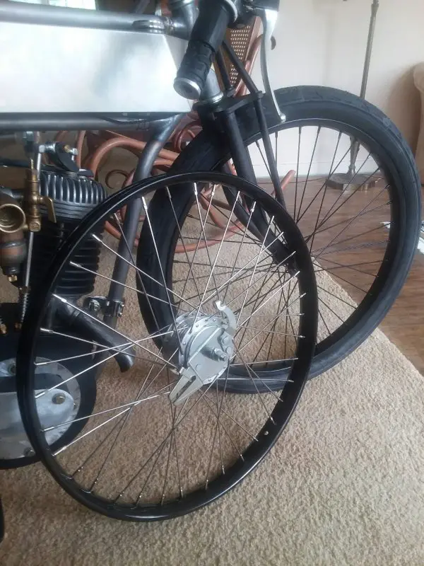

Rear wheel came in & thanks to Rich, Pat's brother, for lacing it up. Great work and I'm very pleased. It's on the bike and spins true. I've adjuster and pinch bolt on order so it's wait on more small stuff that's critical to having a bike that works. Really haven't taken photos in almost a month but nothing really informative going on here at what I hope is the tail end of the build mechanically/electrically.
