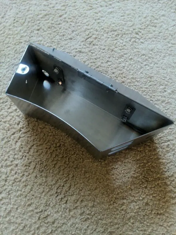

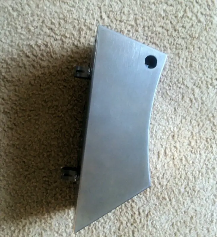

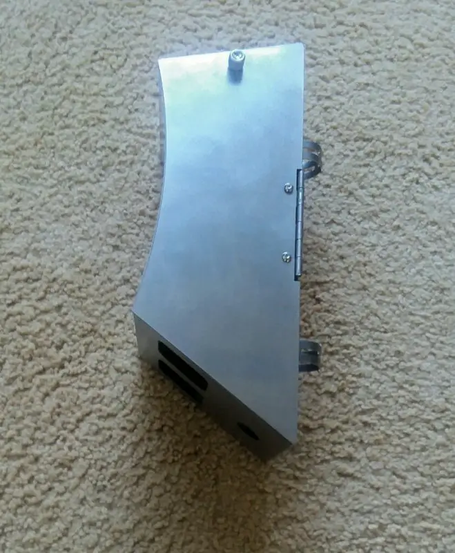

The electric version of the Sportsman oil tank tool box arrived yesterday and is another fine example of Pat's design and fabricating skills. I was somewhat concerned that the 3"x26" would pose a problem because of it's 28" diameter, but all fits fine. I've some selecting to do with switch, connectors and grommets, but the smaller controller is an easy fit. This controller can support 5hp continuous & 8hp peak with the 2kw rated motor 48v. lithium/bms pack. Using a 72v. pack with this small controller is fine ,as it supports multi voltage input, but with less than half the current available with the larger controller.
I've got the fuel tank off the frame in order to get it setup with the battery and wiring necessary, so probably won't mount the oil tank just yet.
Rick C.

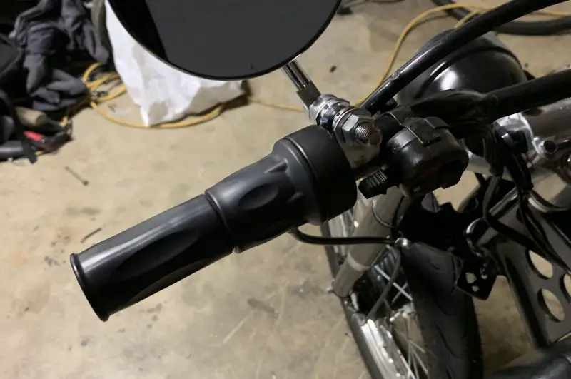

The regen reverse throttle is a regular 3-wire throttle mounted backwards on the left bar. Been riding like this and much prefer it over a thumb throttle for the regen. Keeps the bar cleaner despite the mirror which I got used to because I can’t live without now.
I’m also using the cheap combo 3-pos light switch off treats for lights. It took a little bit of grinding to make sure running positive wire thru it didn’t cause problems with the metal case grounding it to the taillight. I guess maybe I should have set it up as a grounding switch. Diode between the outputs :D
