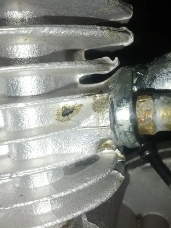

Here is a pic of the hole by the intake I was mentioning
That is a fairly common casting flaw that is only cosmetic.
The hole doesn't go through to the intake.
If you were more curious you would have removed the intake to
look in the intake tract to see if the hole went all the way through? :)
