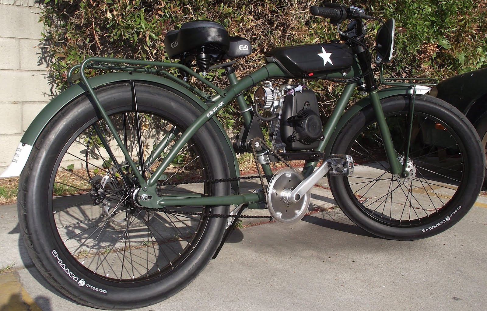

That's the 49cc Hua Sheng 4 stroke minus the Grubee 4G and exhaust. It sure wasn't my first choice but it fits so I'm stuck with it. :-||

Looking great so far... I like those big tires on that bike, Felt should have done that from the factory. I'll keep my eyes on this thread... (^)
I agree totally, then I wouldn't have had to do it on my own. The wheels are Felt 24" and those fat azz tires are Electra Fatti-O's 24x3. They tires also keep me more insulated from L.A.'s potholes.
So close yet so far. I thinks it's pretty much done except for a few knick knacks and tranny.
