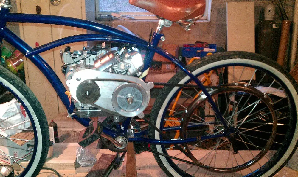

Gettin a lil closer to havin it ready to run.
One of the hardest things about this build so far, is how to drill a hole in 1/4 aluminum that is about .001" smaller than the snap ring bearings that I want to use, for a good tight interference fit, with only a drill press.
Guess what! a 1 3/8" step drill from Harbor Freight does the job perfect
Now I have to set up a fly cutter and cut out a large dia hole in the outer plate to clear the auto clutch, and machine the spacers.
Wit a little luck, I might get a maiden ride tomorrow eve!

If that runs half as well as it looks, you're good to go. I like it just sitting there. The way the engine fills up the frame, the belt drive and rear sheave... Oh yes!

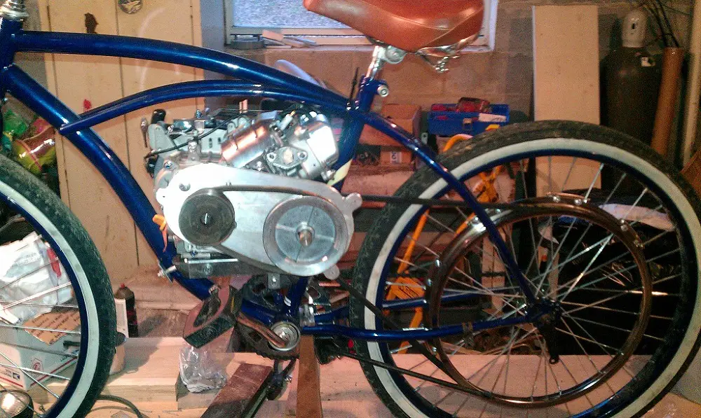

OK, gettin closer to a test ride. Got all the hard mechanical stuff done.
Just gotta finish up the idler control and throttle linkage , and fab the exhaust.
