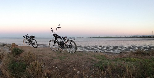

    so finally some updates.
    Installed a manic mechanic sprocket adapter and a 1.95 rear tire. no more chain eating my tire, hooray! Searching for some rim clamp brakes right now. After brakes, im going to start doing some performance upgrades. i fixed the weak points on the frame of the bike and now im back to riding reliably.
    will post more updates once parts arrive!

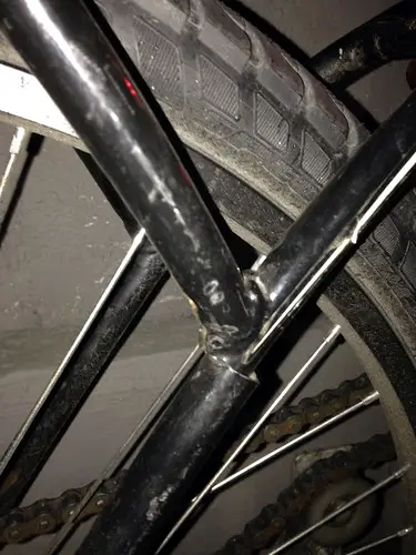

    so after enjoying my bike for a solid month, something bad happened.
    Remember when i said that these huffy frames are really weak? Well take a look at what happened to my swing arms...
    [​IMG]Untitled by cgk325i, on Flickr
    Clean break. It almost looks like someone took a cutting wheel and cut the swing arms lol. Like i said before, im going to have to get a new platform and swap everything over. Will probably get a new bike by the weekend. I will keep the thread updated as much as possible.

    I have a Huffy karaoke that has been bullet proof since 2010, seems the most trouble with the Huffy bikes is the Panama jack version that has the cargo rack welded on like yours, looks to me like the area that has been welded on crystallized the steel right below the weld which makes the metal very brittle, I'm guessing that is what caused yours to break where it did.
    Even though several of us have had great service with our Huffy bikes, there is no doubt that they aren't the best choice out there for motorized bike builds.

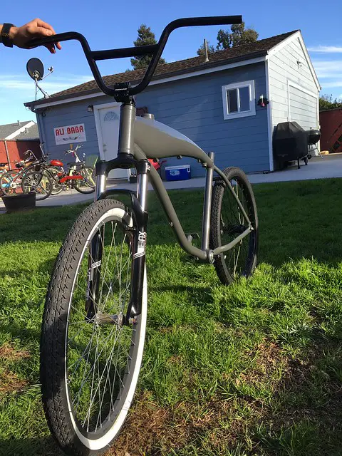

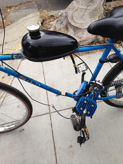

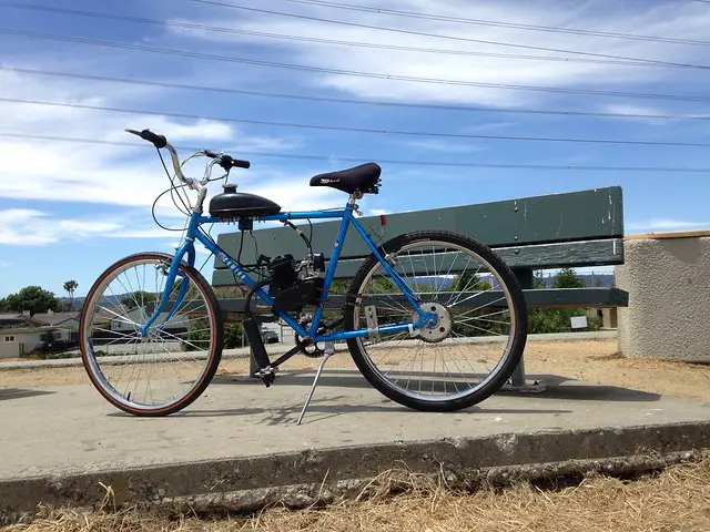

    just finished up the build. bought some parts to upgrade, such as:heavy duty wheels, wide pedals, and a new gas tank.
    heres a pic:
    [​IMG]Untitled by Chris Kallas, on Flickr
  14. mapbike
    mapbike Active Member
    Joined:
    Mar 14, 2010
    Messages:
    5,380
    Likes Received:
    2
    Nice clean looking bike Cgk_iii

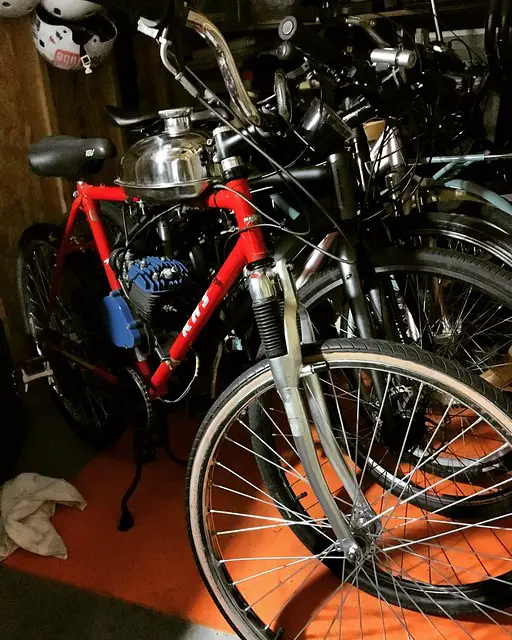

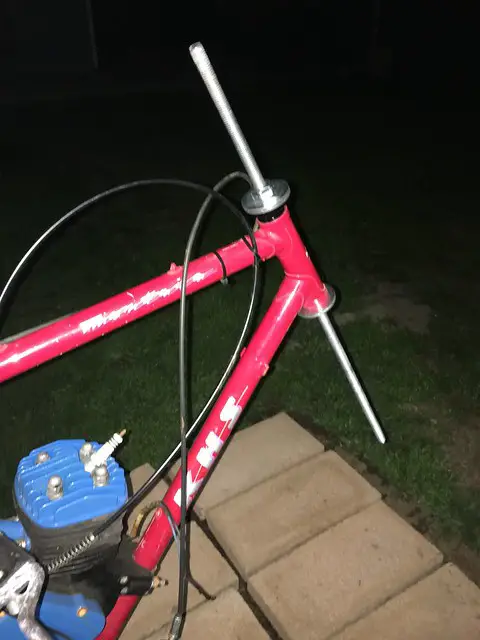

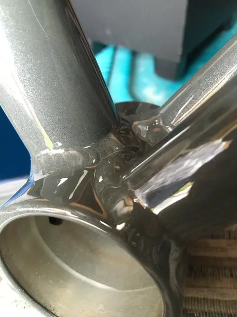

    finally getting around to updating this thread. I was able to enjoy the blue road bike for a good 3 months until this happened:

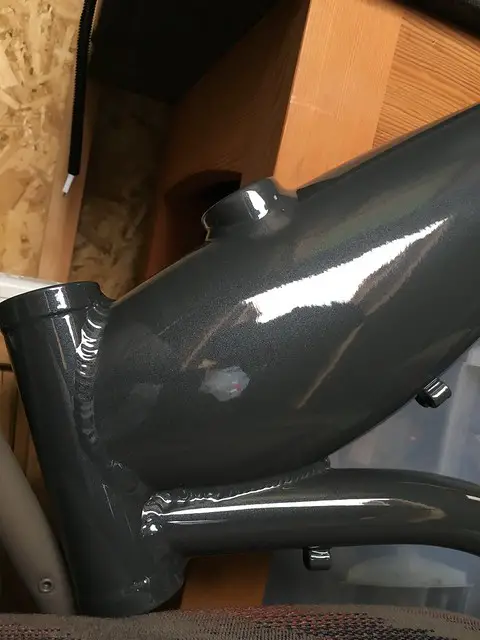

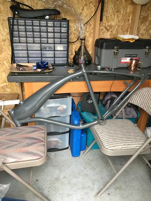

    I didnt wait long before getting a new frame

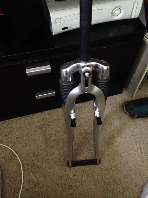

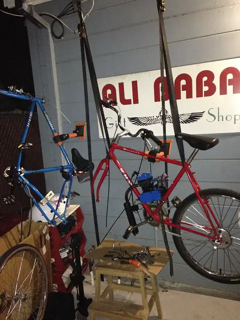

    i wanted to upgrade the suspension on this new HKS so i can prevent things like that from happening again, so i purchased some cheap 29" threadless suspension forks and converted the headtube from a threaded system to a threadless system
