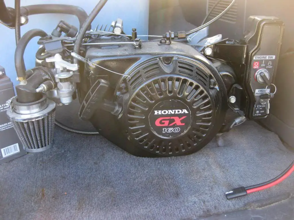

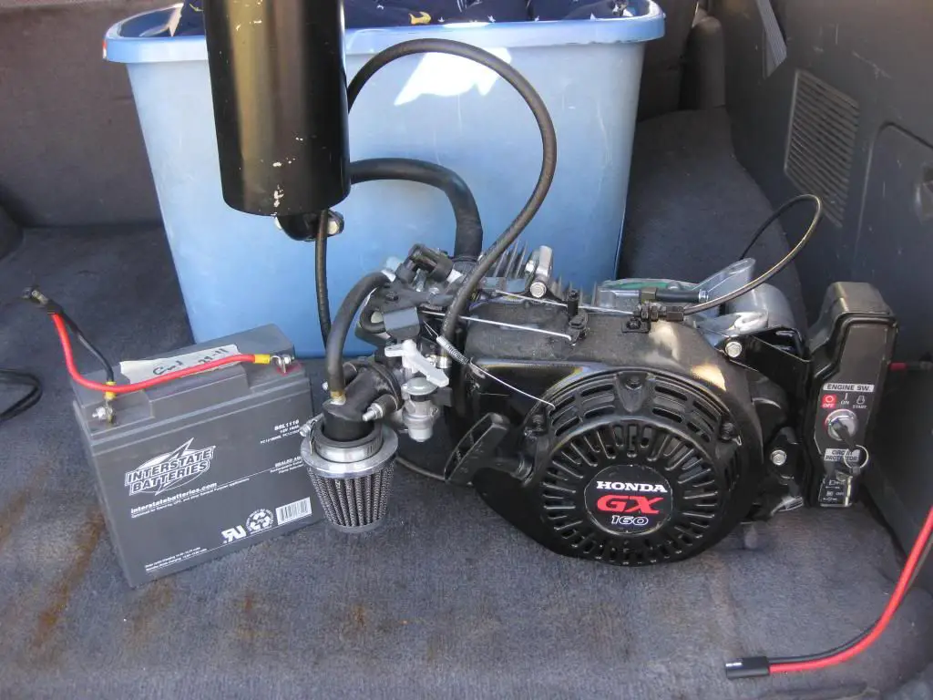

I think the electric start GX 160 will work just fine because that is the engine I have to work with and it's brand new. It's guaranteed to work and I've already installed a billet rod and a modified cam in it ;)

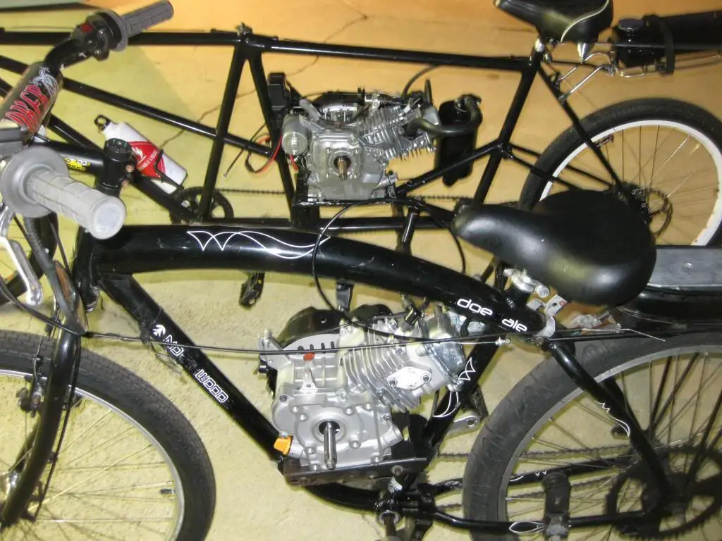

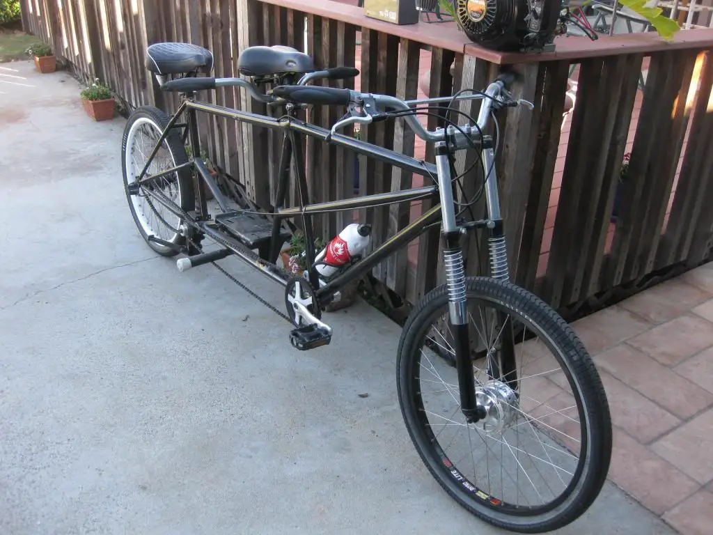

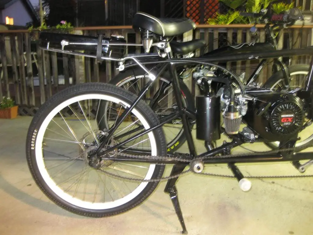

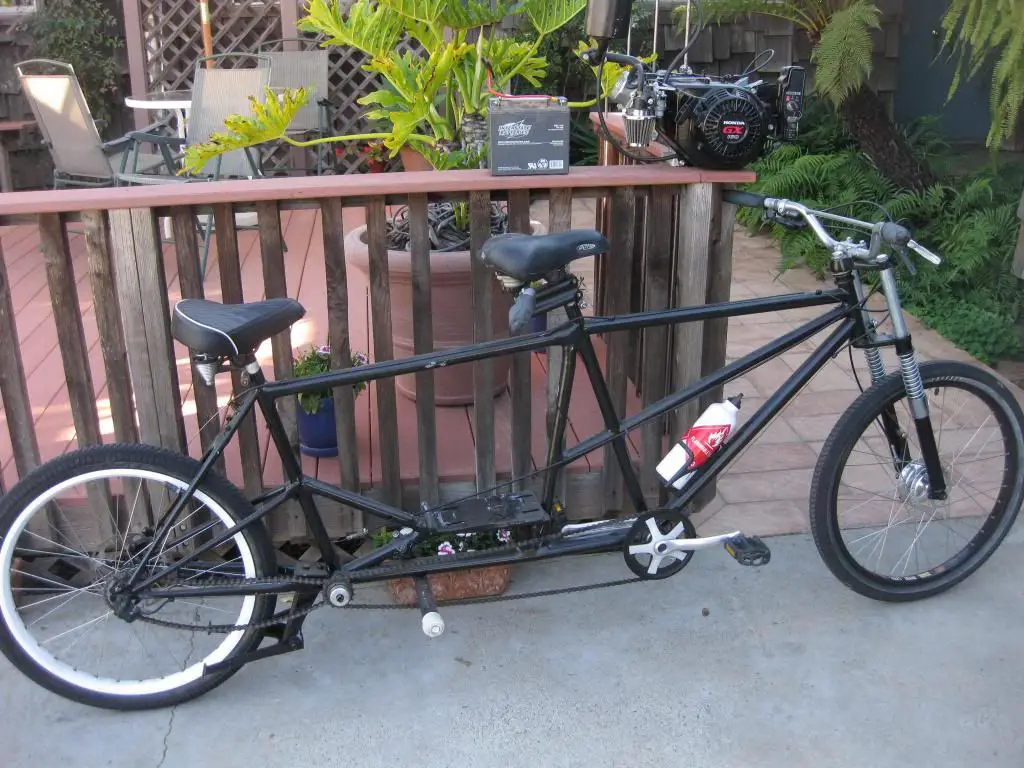

Alrighty then.....some more pics for inspiration and next a little vid of the electric starter doing it's thing once the fuel finally makes it to the carb.
got a few neat mods I'm doing this time around....think it'll be better than ever!

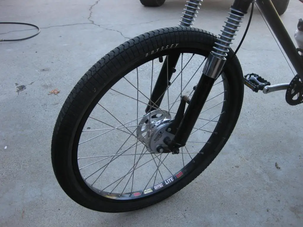

That is one seriously nice looking tandem Scotto. The front fork conversion looks really great.

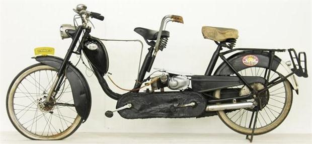

For some reason when ever I see a motorised tandem I'm reminded of France.

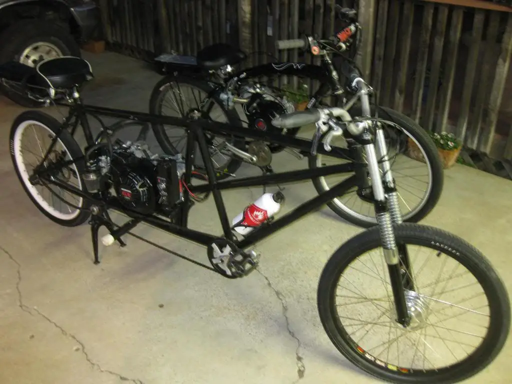

OK, back to this build as I finally finished the 79cc aluminum bike for one of my sons. Will be putting in a full day tomorrow and hope to get as much done as possible, which could be a lot..or? Can't wait to finish this one again as it's twice the fun of a single seater ;)

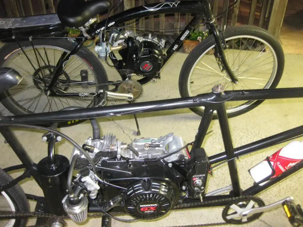

Really didn't get much done today as the weather was incredible.......warm and sunny so I took the 99cc out on a nice long test ride and had a blast. Running the 19mm carb and larger intake manifold, I was pushing 7,200rpm a lot with no ill effects. The bike is running great!
I did play with the tandem a bit however.....put a few cogs on to drive the rear wheel with the engine and had a gear ratio of 1.980:1. Shut the engine down and the rear wheel was still spinning at a bazillion miles per hour.......scary yet impressive.
Progress in the works........
