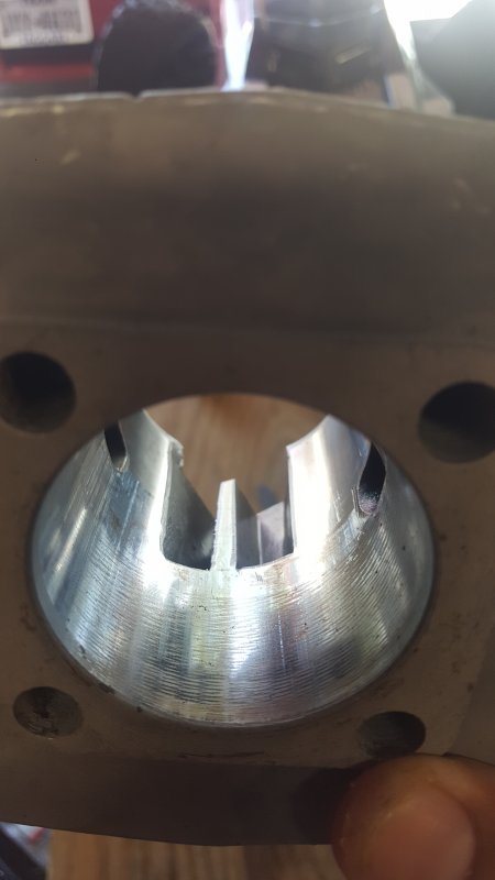

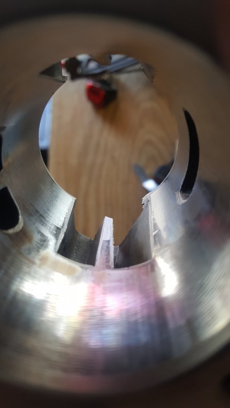

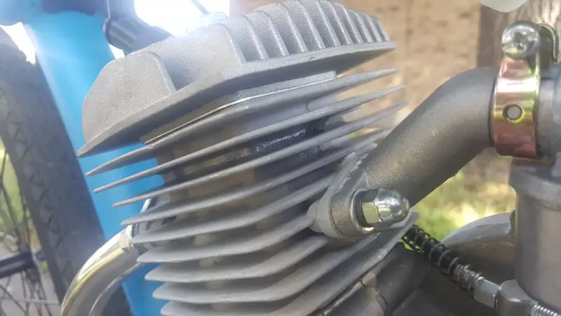

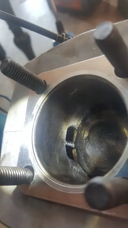

Hello. I bought a new kit off of amazon from bbr. It's the second kit I've installed but I'm still pretty new. This new kit got finished up yesterday and I test ran it for about 5 miles. Firstly, it wouldn't stay running unless I held the throttle open. I adjusted the throttle cable and it stayed running. Second it had hardly any power. After doing some searching and reading I was sure it had an air leak. I checked around the carburetor and while looking, I saw a leak on the cylinder itself. While running I can see it bubbling out of a pin hole. So I'm planning on contacting the seller on amazon and asking for a new cylinder, should I be requesting a new piston, rings, and gaskets too? Like a said I'm new and I'm not sure if all these things need to be replaced together. I took the head off and felt inside the cylinder and can't feel any cracks. BTW I'm running opti 2 70:1 for the first tank then 100:1 after that. I've done that on my pk80 with no problems. I've attached pics of the inside and outside of the cylinder.

Welcome to the forum, from the first picture I take it is leaking between the fin above the intake. From the looks of the inside I would request a complete top end, looks like you had a lot of medal shavings or something hard in side the engine when you started it. The third picture looks to have some debris marks near the ports.
Venice Motor Bikes
Mar 20, 2008
7,041
1,224
Los Angeles, CA.
Tiny flaws in the cylinder castings are very common & don't usually cause any real performance problems...
A 'air leak' will cause the idle to be way too high with no way of bringing it down by carb adjustments).
The tiny hole you have probably isn't affecting the performance (but will make your engine very dirty over time).
It looks like you burned up the chrome lining on the cylinder walls... :(
Also...I don't recommend using that oil for break in... use a standard 2-cycle oil at 32:1
Another thing to mention is that when you take off the head, you need to properly torque it back on (12 ft/lbs) or else you'll warp it & cause a leak at the head gasket!

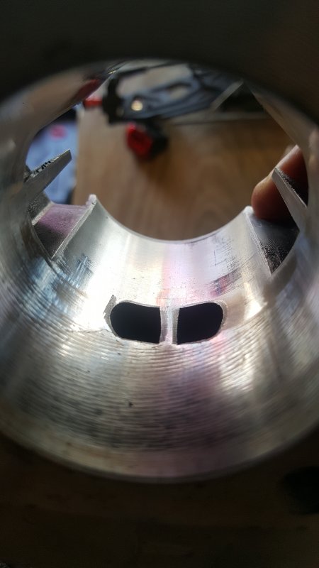

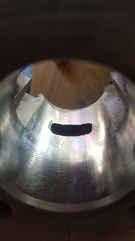

Did you try to clean up the ports before starting it??
It's hard to tell from these bad pics, but it looks like someone tried to clean up the edges of the exhaust port??
I did not do anything to it. But this is the kit I ordered. Bbr probably did if they're the ones that opened the transfer ports. I tried to set up an exchange but amazon wasn't able to send a replacement so they just refunded my money. If I get new top end I should be good to go? Screenshot_20190818-091051.jpg

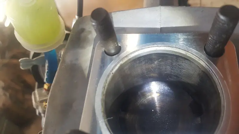

Thanks for the reply. I finally had some time away from work and took the cylinder off. It feels rough on the edges where the transfer ports were opened up. Anyway, the intake is 40mm, I have a low hole piston, any idea on what I should be looking for to match the timing? Thanks

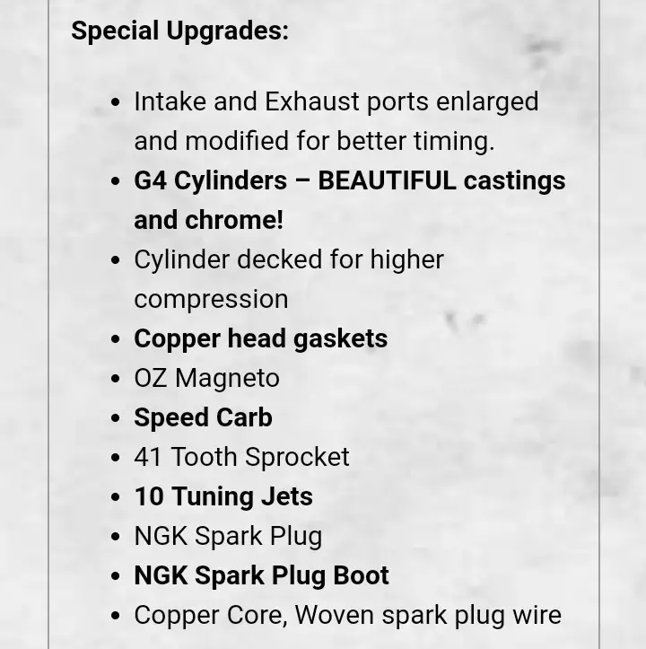

If it had a air leak, or loss of compression, wouldn't just run poor no matter the rpm? Like I said this is just happening at lower speeds/rpms. Any insight would be great. Here is a description of the kit upgrades that came with it. I'm using a 44t sprocket instead of the 41t.
