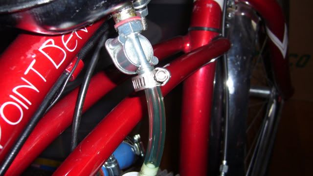

Hey guys. I'm having a small but messy fuel leak from somewhere in the carb. Or around the carb. I can't figure it out. It is around the top of the bowl seal, on the bottom screw, on the primer screw, on the rear mount, frame, and where the kickstand is! It's everywhere. It doesn't leak out when sitting, it's being forced out somewhere while I'm riding. It's not safe for me to ride and inspect, so I've taken pictures with my 1.3 MP phone camera, as close as I could, using one of my LED headlights as lighting, attempting to show you my exact problem. I haven't wiped this fuel mess in a couple of days, so this is accumalated over time. Anywhere you see that familar blue, is obviously fuel, but, once past the rear mount, it turns to a dark, wet sludge that I'm not sure the camera picked up too well. The fuel seems to be focused mainly on the side opposite fuel line entry, so the side with the primer and idle screw.
I'm buying a new chopper very soon, so really, I am not paniking about this, but if there's a painless way to fix this, I'm sure it's a good idea. Fuel on the outside of a super hot engine is probably not too good. Lol. Anyways, here are the pics, any input would be appreciated. Thanks guys, take care.

It looks like it's coming out of the primer, which usually means the float bowl is over flowing.
I was having a problem with a leaky float bowl. After taking the bowl off, I found that the bowl had a little round impression wear they cast it. I'm talking about little circle shaped casting marks. casting marks .On side of the bowl wear my carb was leaking from, the round mark was slightly raised. I used my dremel and polished it flat and it solved my issue.
I have made an observation, seems my fuel leak might actually be coming from the fuel cock on the tank, where the tubing attaches. There is fuel up there, and it would make sense, it runs down the tube, to the top of the bowl, around the bowl, down the rear mount and to the kickstand. I think I've figured it out.
