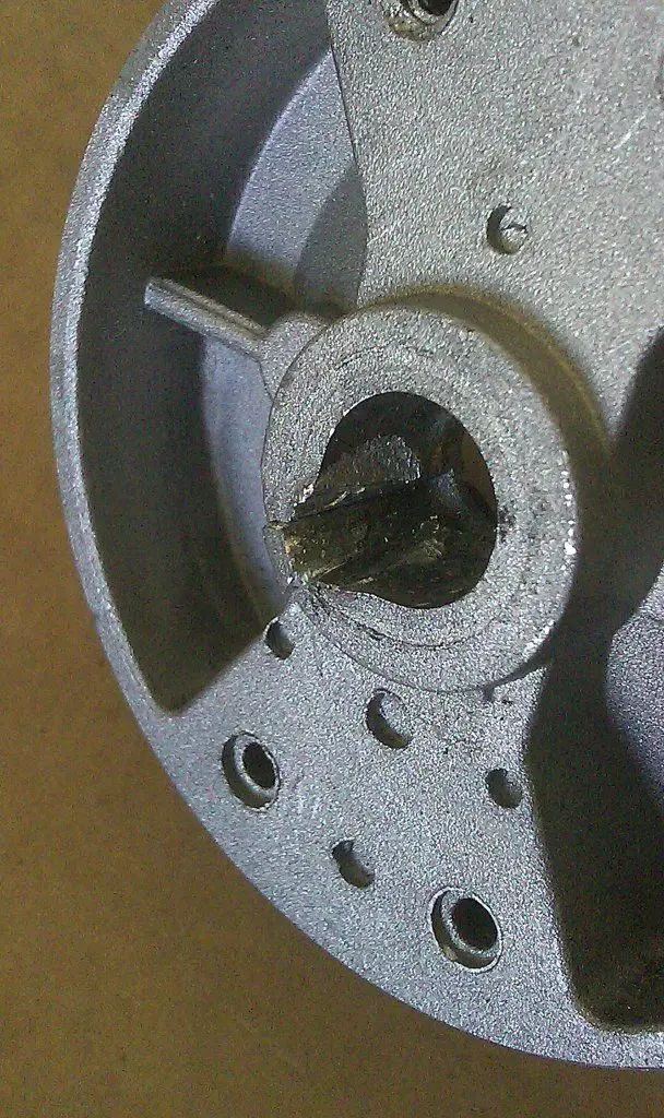

So I got my pullstart in the mail today and put it on and guess what happens next?
The flywheel literally breaks off. What the heck? This aluminum is so cheap.

Also 1 of the fins on the flywheel broke.

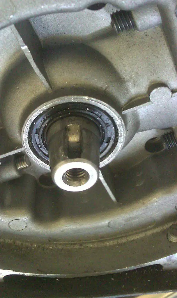

Another thing is the slot where the rocket key belongs to is worn out and I do not want to buy a new crankshaft (this one is already brand new ever since the bearing failure). It's worn out on the upper half of the key slot, so I hope the lower half is good enough to hold a key in place. I hope a new key will have little to no play in that worn out key slot. If the key lifts up and reaches the worn out part it would get out of place and cause damage and/or wear it out even more or even the key would bend or something which I doubt would happen if it's the correct size?
If the key flys out of the slot however (since that worn out part doesn't hold it very well so if the key lifts up it may fly out I guess), it would definitely cause damage I think and/or cause a great amount of wear.
Do you guys think the crank shaft is still usable with that worn out slot?
Here are some pics:
This is the worn out key slot on the crankshaft
This is the flywheel
Gera,
Aside from changing a few things on these Cags to prevent certain destruction (longer head bolts, copper base gasket, clutch springs, etc) I wouldn't be spending all my money doing hi-performance mods to an engine that isn't even broken in yet?

I'm going to use a regular woodruff key next and a flywheel I will buy, but that is still $25 wasted.
What do I do with the old flywheel? Cast aluminum?
