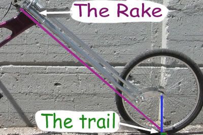

Very cool... It looks just like my 1950 Schwinn did before I "Bomberized" it! (^)
Be careful riding it, (those forks don't handle very well)
yeah they are bouncy. The thing I do like about them is that, once you get going, the bike is more stable, because the front wheel is kicked out. At slow speeds, it handles like ****, because the bottom part of the forks are basically parallel to the ground and it's hard to turn.

It doesn't handle because the rake/trail is not correct...this causes a 'flip-flop' effect...it is general rule to have between 2-4inches of trail for best handling..For those who have no idea how to measure this here's a diagram-->
Plane dangerous if you have the front end geometry incorrect IMHO...
yeah. I'll probably go with a non lowrider springer fork next time. Don't know if I can afford the fancy dual spring forks I saw around here. I'm not sure what to do about handlebars for my next proj. I like these apes and they are actually comfortable. I might make a nod to Venice Boy's "bomber" but use a tank off of a sportster and use a 4-stroke kit frame mount kit.
