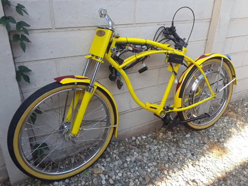

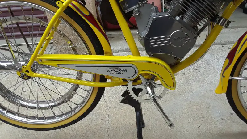

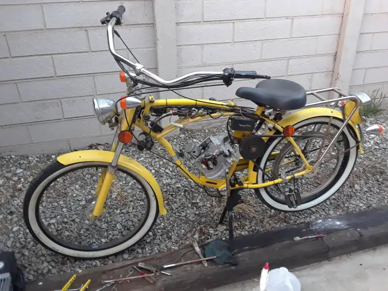

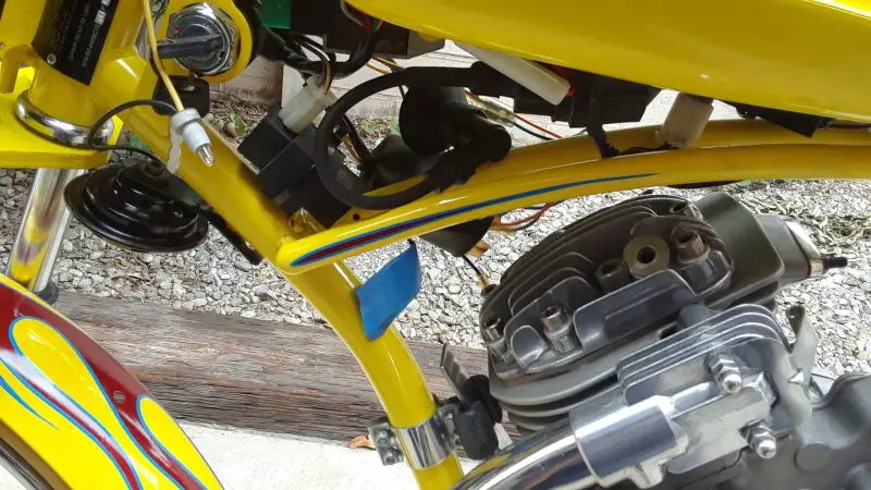

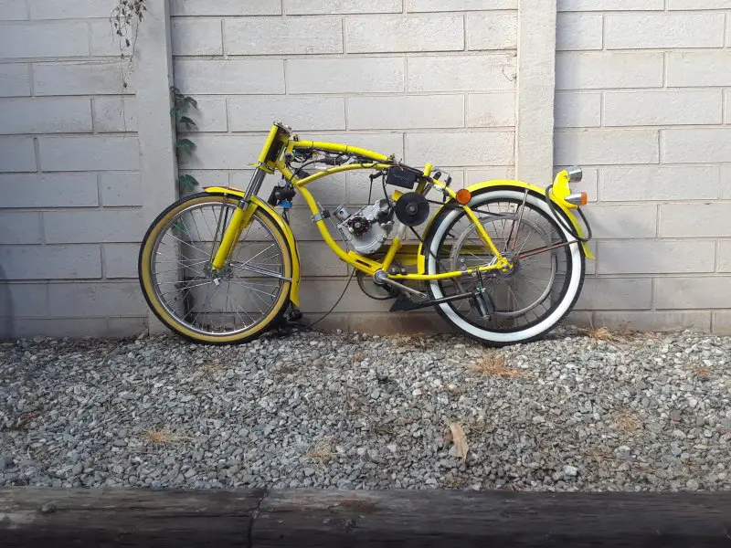

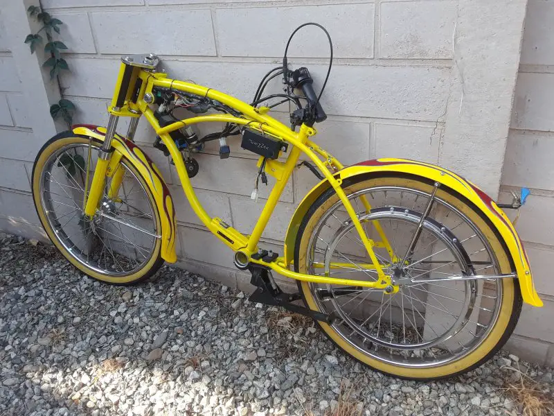

A few years back I got this new edition Whizzer from Dennis (DMB)

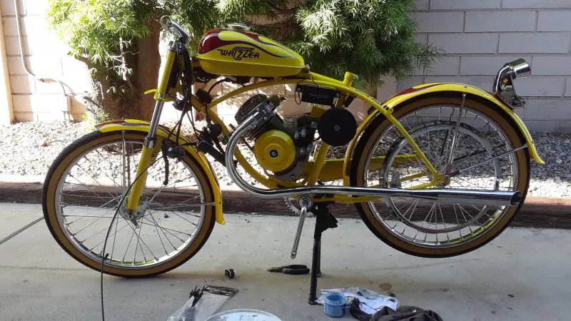

It's a yellow 24" Whizzer. Been sitting for a good while,with about 50 miles on it. My goal was to tame down the yellow,and not to remove much of it's original parts,and of course MY mods.
This is what a 2006 yellow Whizzer looks like from the factory. More to come.

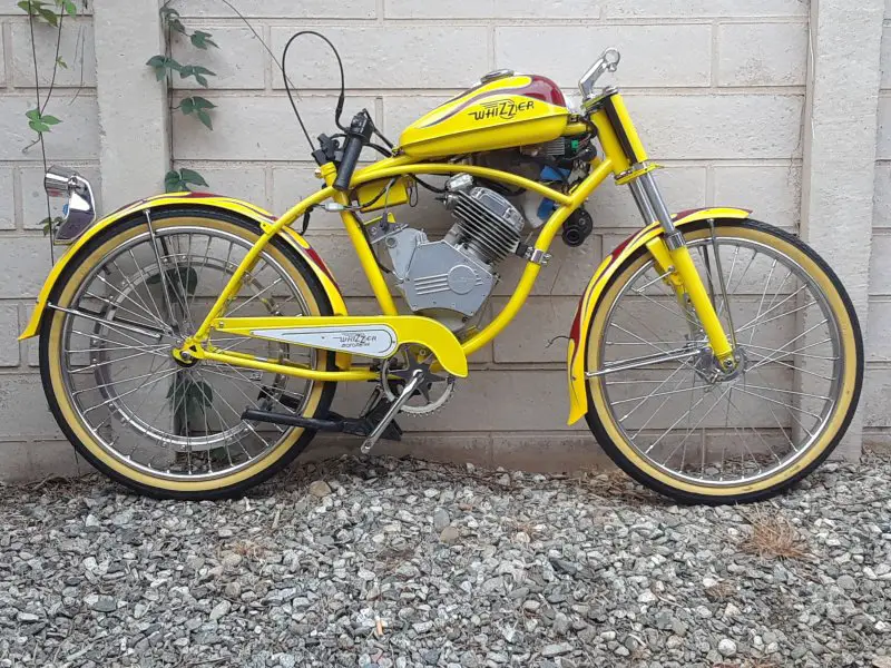

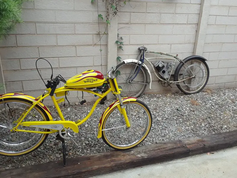

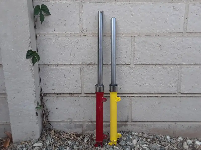

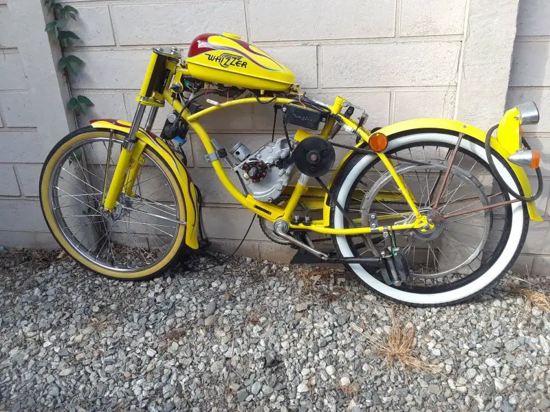

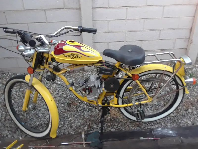

Ray the stance is better with the lowered forks, looks a lot less motocross & more Schwinn like. The flames give a '50's & '60's retro feel which is also appealing. Looks like you're freshening the top end of the motor as well. I'm sure you'll love it when completed & I already do!

Thanks Rick!

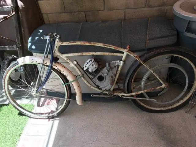

I also like the looks of the vintage Schwinn Whizzers. This one is a 1949 DX BFGoodrich badge machine. Waiting in the wings :)
The New Generation Whizzers still haven't been tap into, this is why I'm using War Machine, to show it's potential. New, but still a Whizzer.

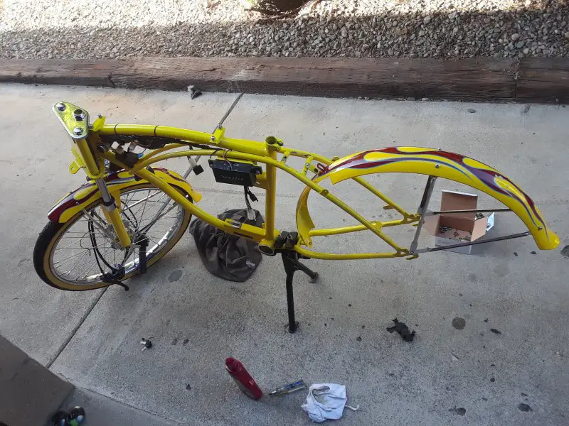

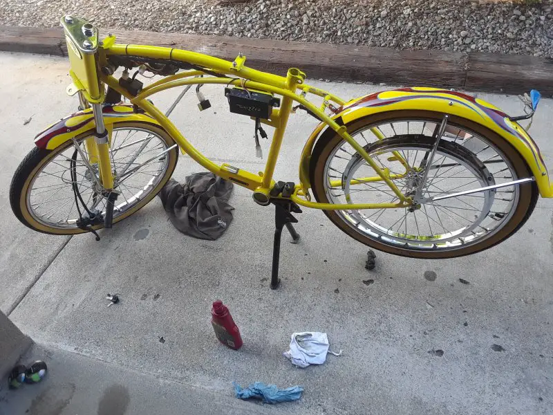

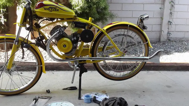

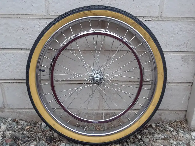

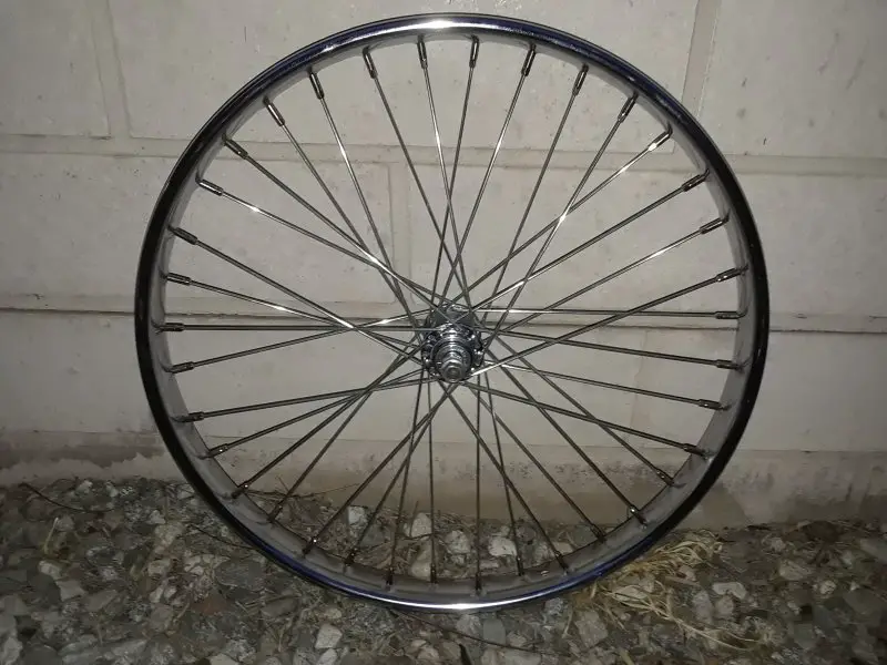

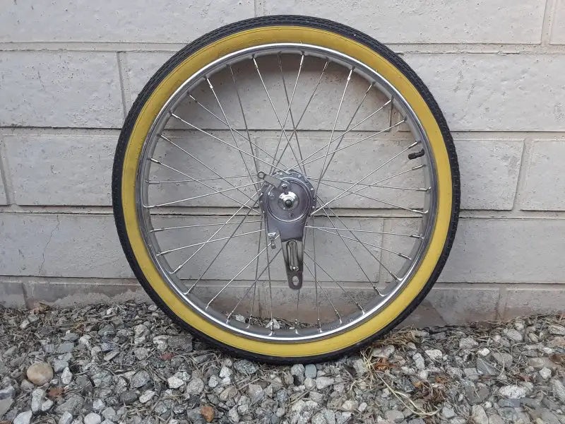

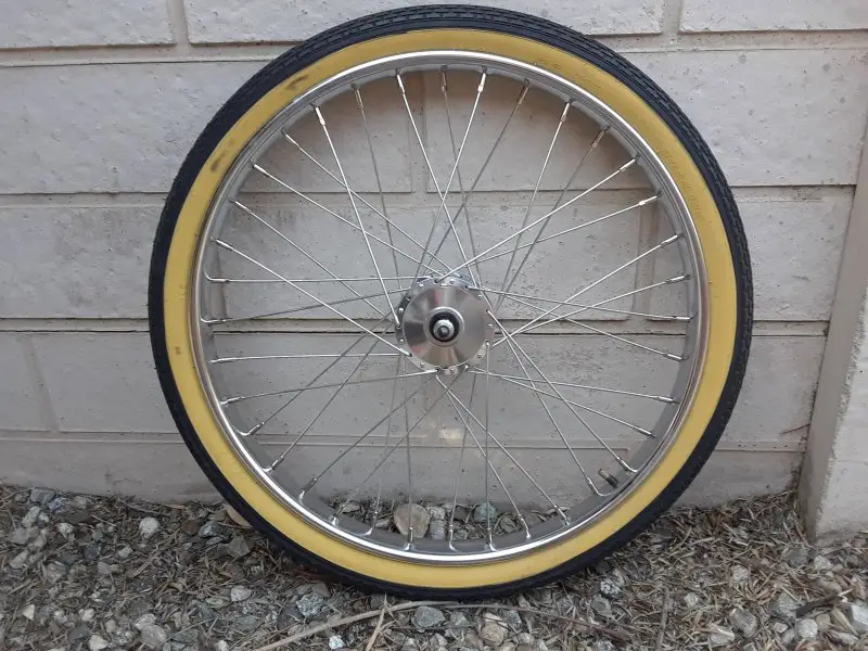

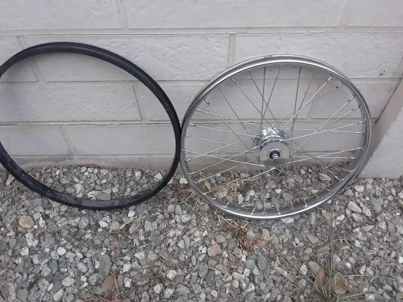

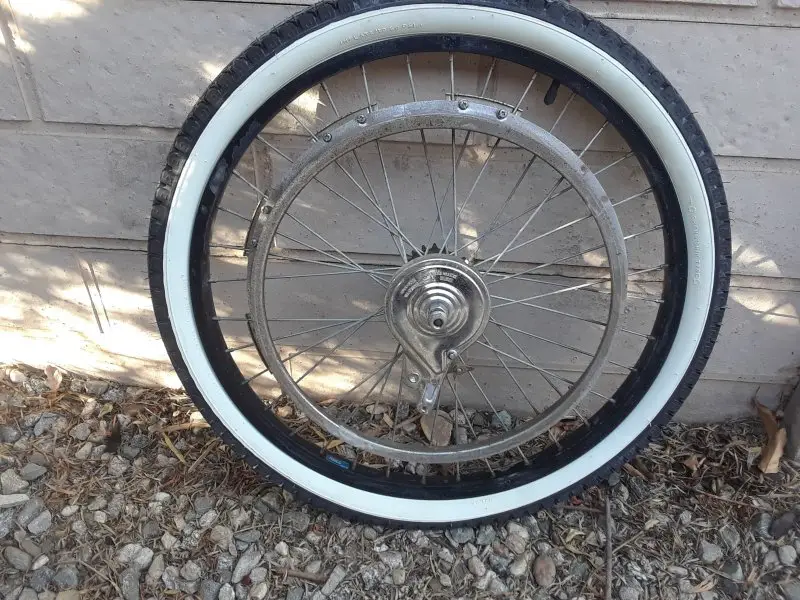

Time to start disassembling the back side,removing the black rim and replacing it with the worksman rim and gumwall tire. I'm using the same spokes (105) and hub at came with the bike,just changed the rim and added the worksman's longer nipples.
Reinstalled the wheel, sheave,and fender.

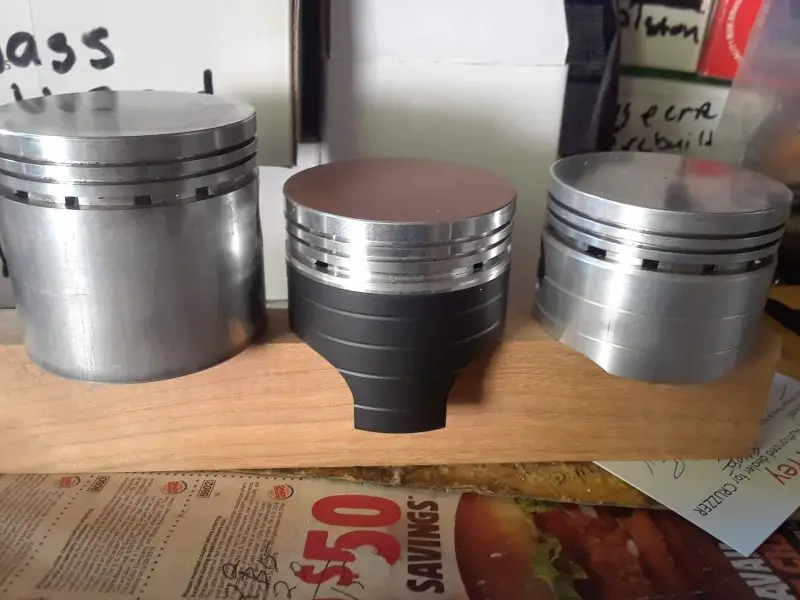

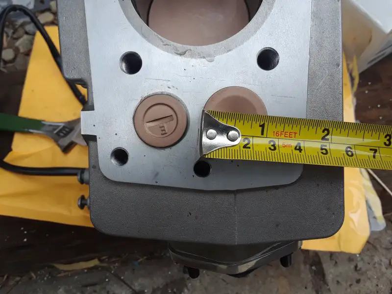

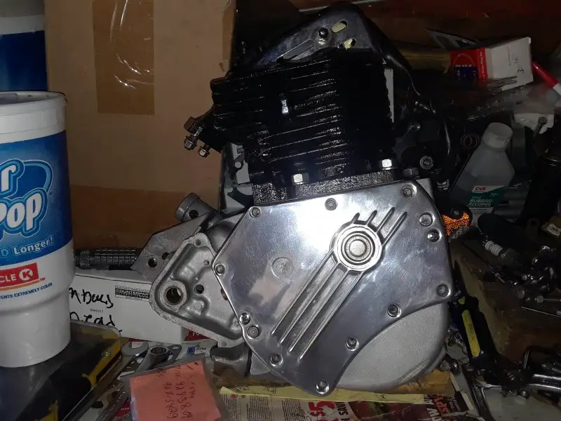

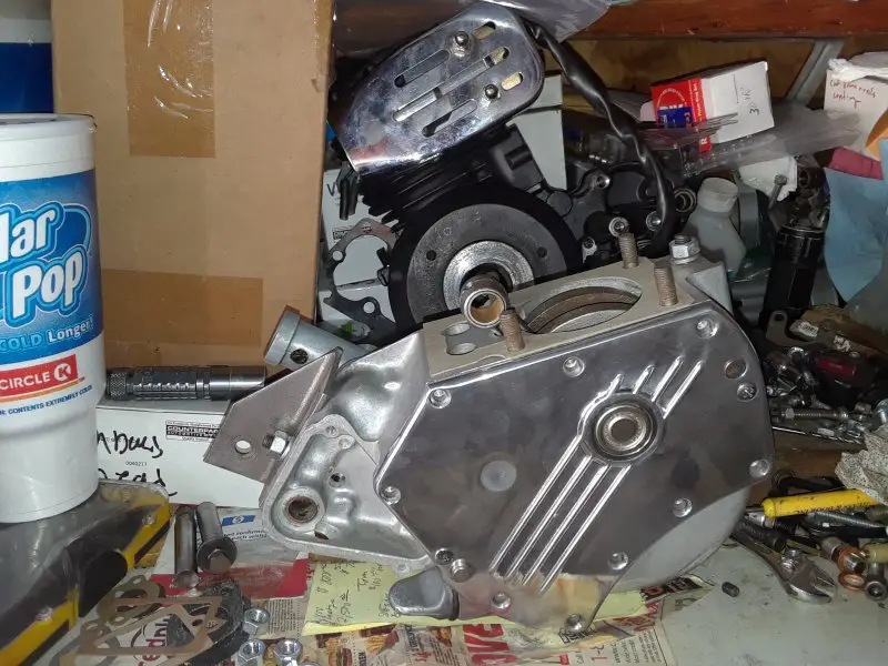

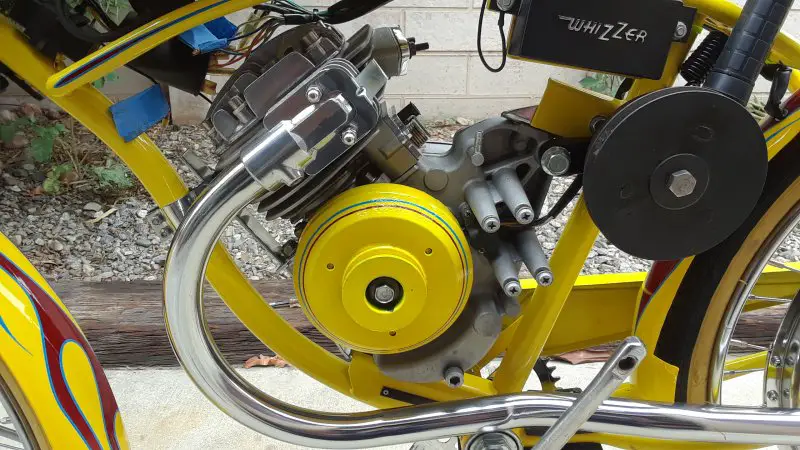

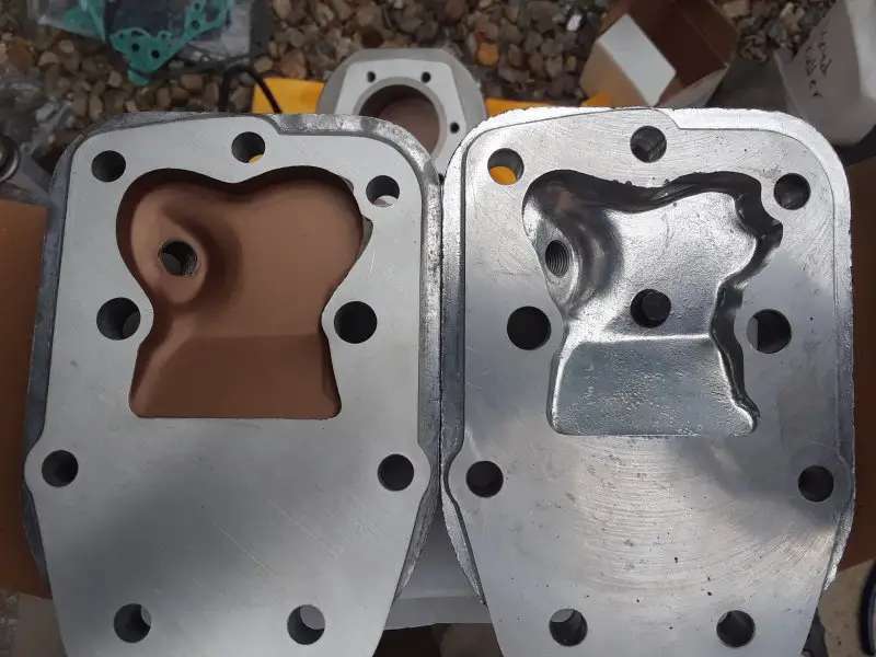

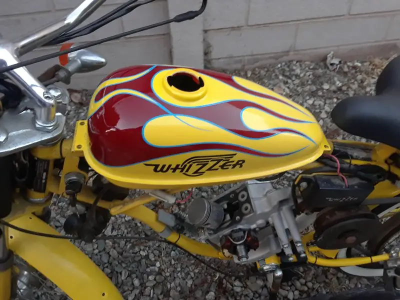

Indian22 Rick, mentioned in a previous post about the top end being refresh. Yes,a bigger intake valve, combustion chamber reworked, piston modified.
I use a Dry film lubricant and thermal barrier to help control heat.motor runs around 300 degrees.
I also lightened the flywheel, removed 2 lb.

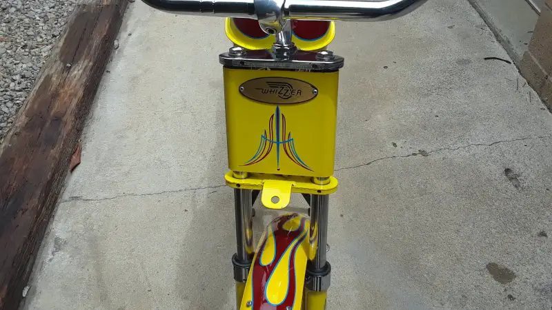

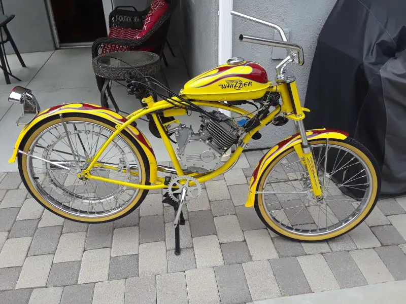

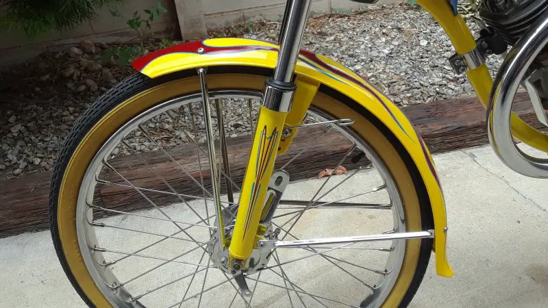

Nice work...great Improvments! Your Buddy Bruce might even start like them again...lol Love the flames did you paint them ?
Thanks MotoMagz!
Flames and pinstriping was done by Tom Clark, friend of Ed Big Daddy Ross (Rat Fink)
I'll post more pictures of the rest of the pinstripes.

I can’t believe that art work...And how it transformed the bike.Wowza!

Flames a piece of art!
Motor work looks great. I'm a fan of internal motor upgrades both for 4 and 2 cycle engines and not just for hp but just as much, or more so, for engine longevity; so I give a mental nod to those who take time to make certain.

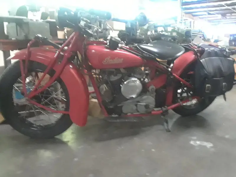

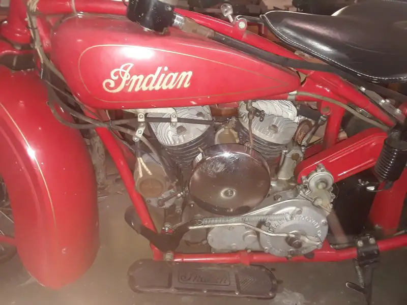

Greatly appreciated! Is Indian 22 for this kind of Indian?
Friend of mines. 1928 Scout

Lol yep I'm a big fan & it's also due to my native American heritage...which is a pretty common trait for those of us living in Indian Territory (Oklahoma) & that's a nice example of the Scout you've shown. I no longer own one and most of my friends that had originals have passed on so I'm relegated to my tribute bikes and fond memories. I especially enjoy the Indian & HD bikes from the first two decades of moto-cycling.
Thanks for sharing the photos of your friend's Scout. I hope he hangs on to it!
