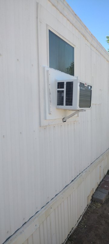

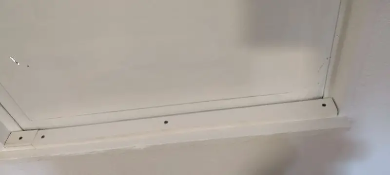

Getting closer to actually getting started... Basically boarding up the window to put an A/C in it... The goal is to make it secure and weather tight and insulated... Luckily the pvc lumber is just thick enough to let it tilt twords the back to let the condensate drip out... Ghetto style

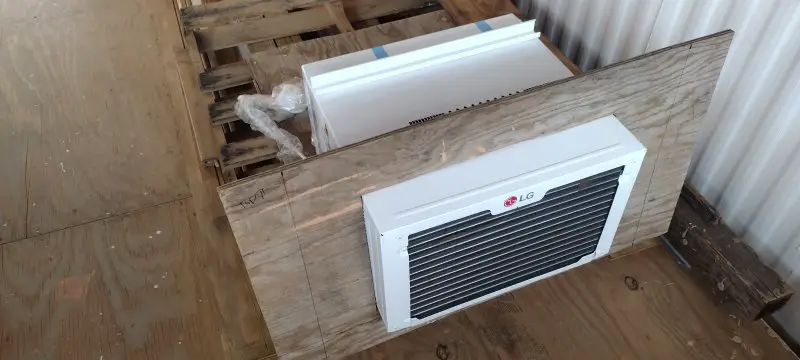

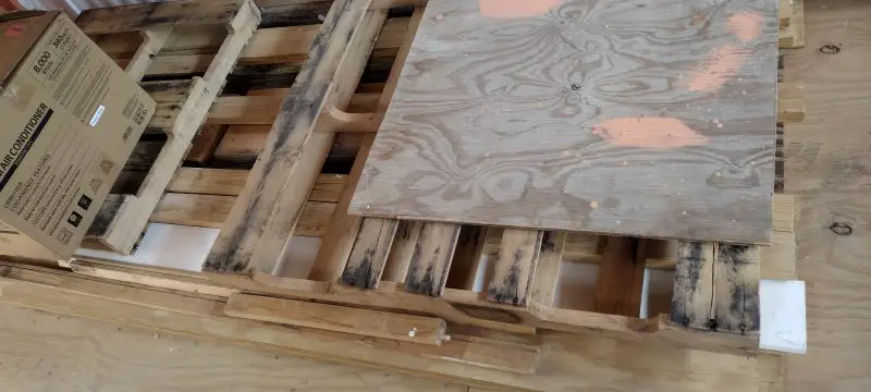

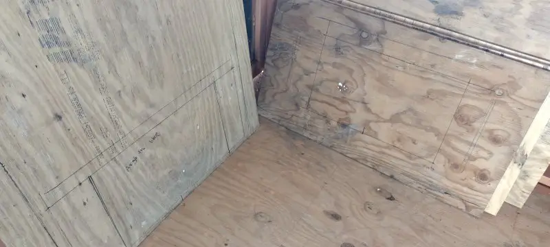

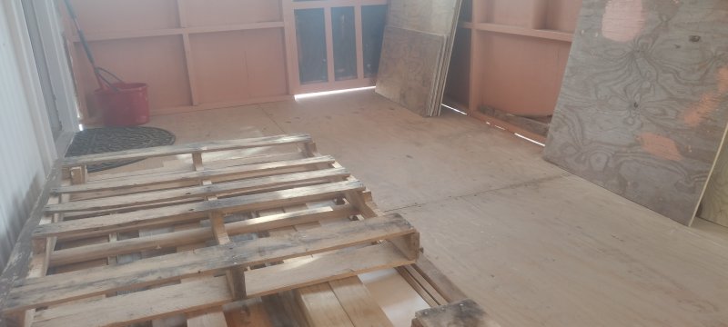

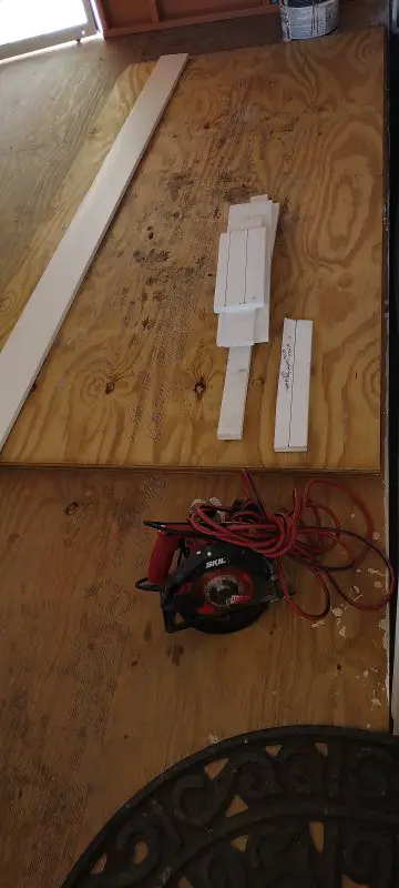

My pallet panel saw worked out great... Used pvc lumber scraps to do the raised sill plate... So the A/C will lean to drip out of the hole I'm going to make bigger... Now I can fit up the pieces to make the hole for the A/C ... Bringing me back to making adapters for pioneer tape decks and Rockford fosgate punch amps ...

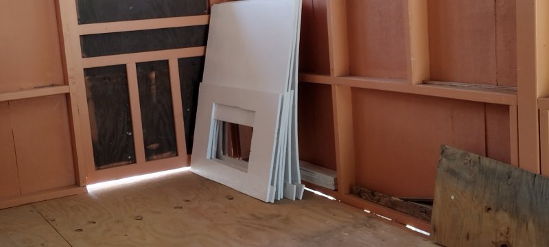

Now I got one to fit up and there all the same and same windows... The support bracket is going to work out good I was worried that it might not rest on the trim... I'm very happy with how the pvc lumber came out it messes up the sides of the blades cutting it... It takes paint like wood and pvc cement and primer will turn it into anything ;)

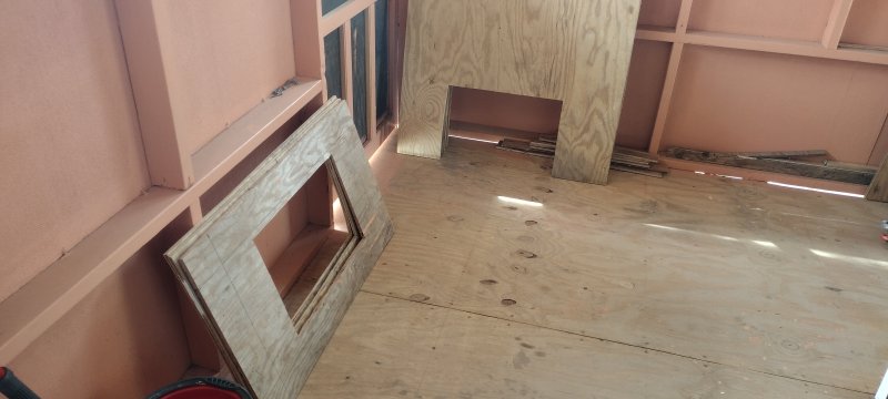

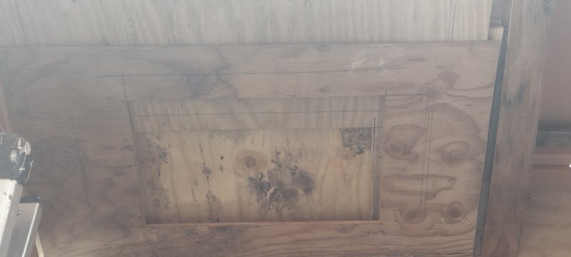

I got one set marked out it's smaller on the outside so it won't fall... My job is to make it fit so it won't push in to gain entry.. insulated and sealed permanent deal... Once I get one fitted the other ones go easy and then I can pace out the install... Everything is a blade oversized for the gorilla caulking to get into... Pre painting will help make it last... everytime I can add a step to the process it's going to slow my roll and it will come out better and install easier... Days and weeks no deadline for completion ;)

I got one set cut so I can fit it up and then cut the rest and pre paint everything... Sunday Smokie Sunday

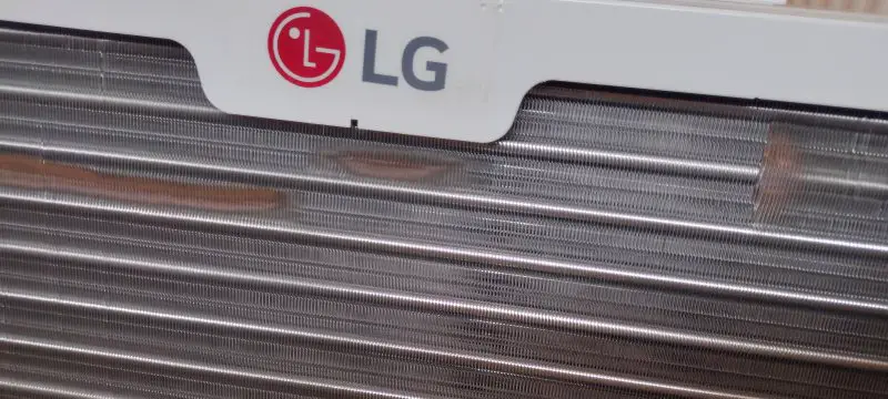

Finally got around to cutting everything... And if you smash the fins on the back you can use a stainless steel welding brush to straighten them out... Works on an oil / trans cooler on a car also.. just comb it it one direction and some purple power ;)

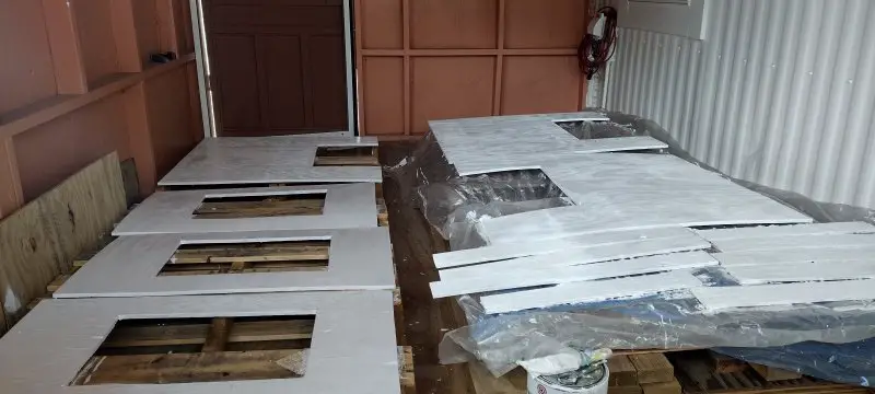

One coat of paint... So relieved got more done today than I expected... And I'm just going to leave the bees alone they didn't take to the box :(

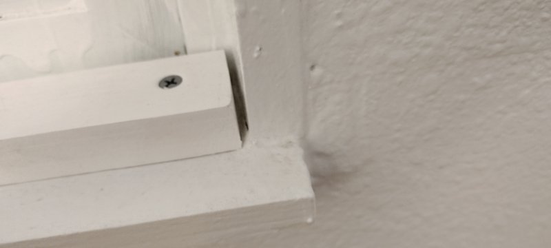

And painted... The shop is working out great... Once I get the boxes empty I can fill them with parts and I have my rooms back...

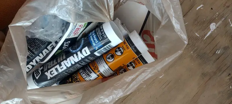

One got done... The gorilla adhesive is like the old marine 5200 you can't get anymore the smell and everything... In a couple of days I'll give it cost of paint...

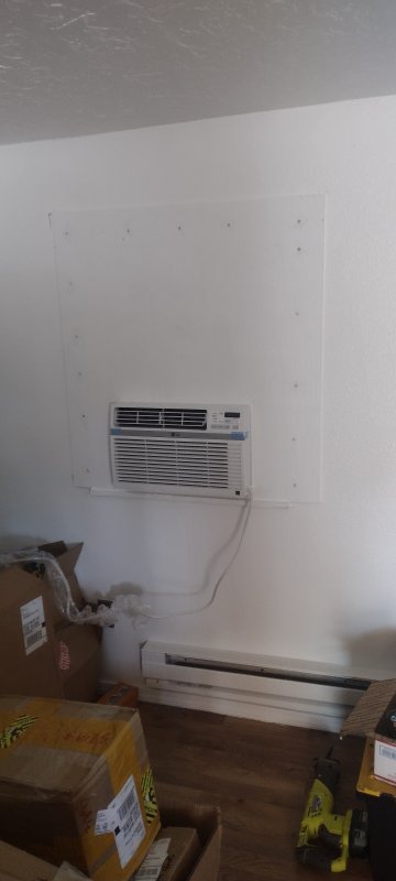

I'm going to make it comfortable... I've had the units for 3 years and don't really need it except for a few weeks a year because of the cool seal coating reflection of the sun... I'm really happy with this place... From nothing works and full of problems to everything works and just a few more things to do is where I'm at now... The first month I stayed at a hotel while I got one room livable and hot water in the bathroom... 100 gallons of paint inside and out and 3 cases of caulk later... the heating bill dropped 25% with 50' of heat tape added... So when I insulate the floor properly I'll save heat and cool making it a lot more energy efficient... The washer doesn't shake the place anymore and nothing flutters in the wind and it's quiet when it rains... The best part is the $40 tax bill for $12k 50 years old bottomed out on the calculator evaluation... Remanufactured for $25k bought it for $8000 and no debt from paying as I go...
