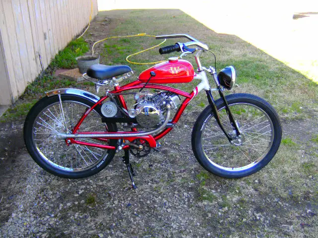

The Zip Bike is kinda similar to this bike I built several years back. Was a great FD!
http://motorbicycling.com/attachment.php?attachmentid=43111&d=1323973089built

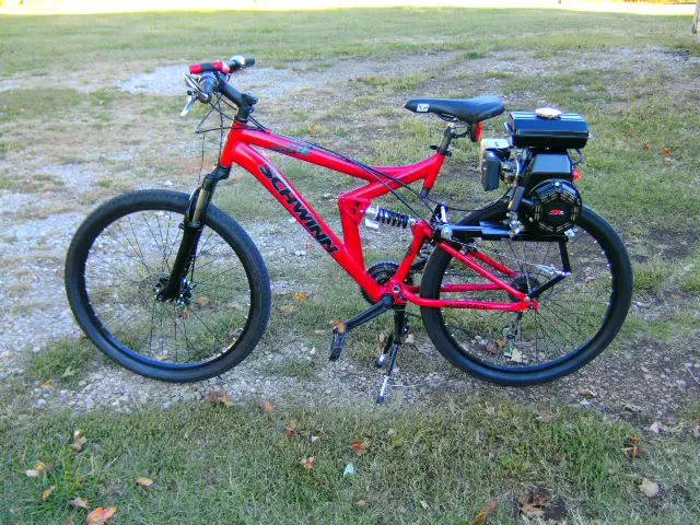

The Schwinn was a great bike too. Direct drive it ultimately turned a 3.75" roller for a top speed of 44mph. Had to pedal to around 15mph then dump the clutch and hang on.
I still have the sister bike a Mongoose. Have more miles on this bike (around 8k) than all the others combined.

The Zip, whether it's the result of construction or of planning, has a look much like the original friction drive Whizzer.
