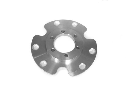

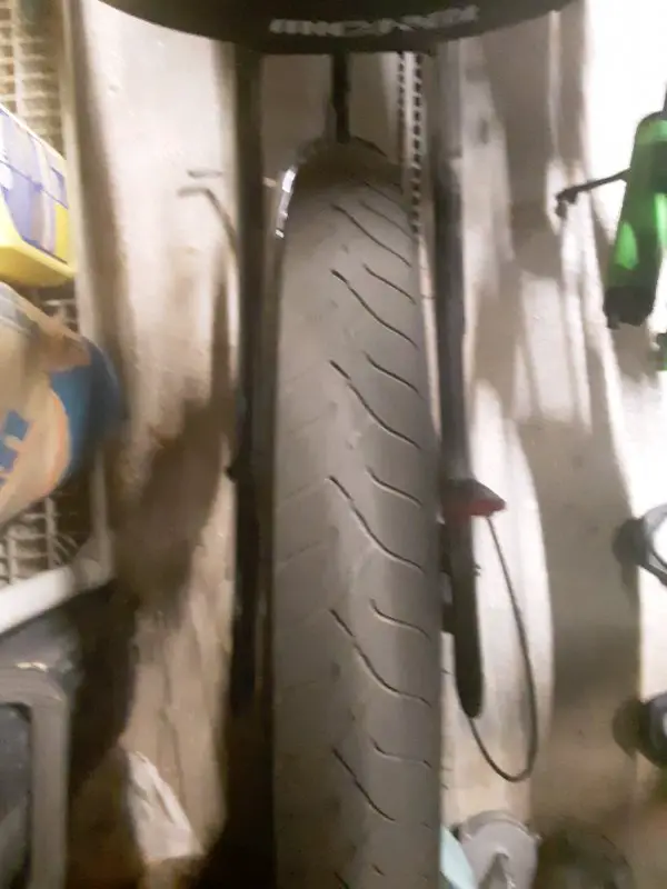

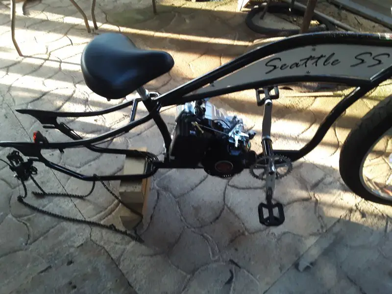

I'm about to start building one, and after looking at the 2 threads here I still have a couple of issues I am going to run into. Maybe someone here can give me an idea, how can I put the sprocket on the left side while keeping the disc brake?
May 22, 2020
67
41
18
36
I understand I'm gonna need a spacer like that, I am more concerned with the space and the caliper being in the way. I'll take a picture tomorrow.

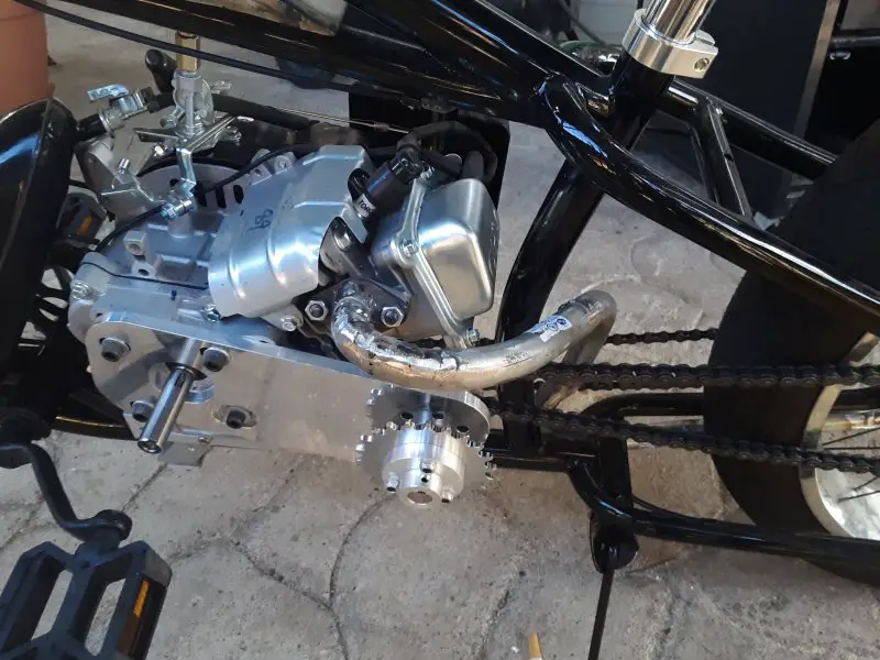

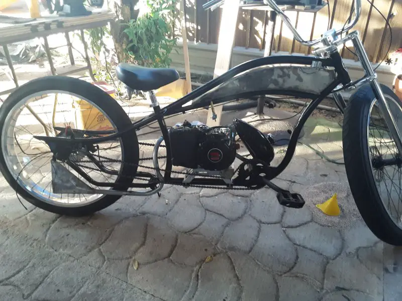

That frame has quite enough space for a big engine. The way the engine has the angle of cylinder leaves lots of room. Looks real nice! The plate with the writing on it too.

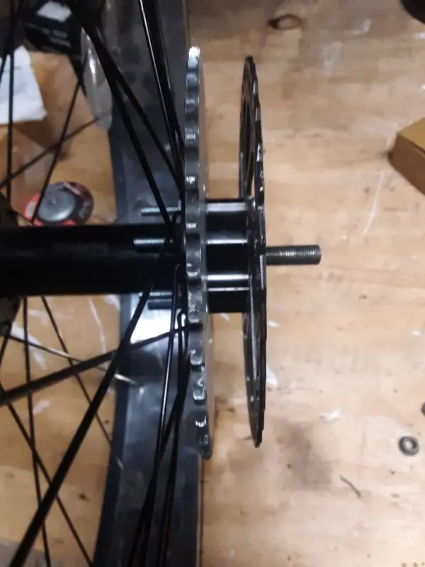

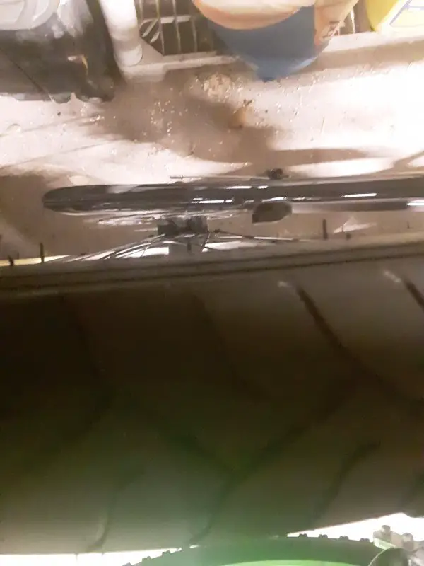

Quick update, got the rear wheel on it and the chains seem to be straight. I did want to put this pic here to show how the sprocket and disc were both able to be mounted on the same side. I didn't realize the spacer in the middle there was not part of the hub when I first looked at it.
I realize there doesn't look like much for it to hold onto, I plan on getting different wheels eventually, probably some Mag wheels from one of those Chinese websites. I plan on doing a bunch more, but hope to get it mobile by Christmas.

Looks good!

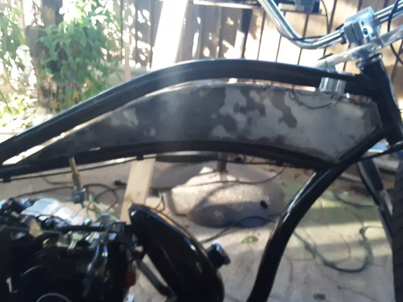

What's with the upside-down peanut tank?
It won't fill up or flow.
I had just connected it to start up the motor, it is not bolted in and will not be used. I needed to test the sound and I would say it failed, ordered a muffler, should go right before the tip. I'm also thinking of White/Black color scheme. Maybe paint the exhaust and certain parts white.

That’s a lot of mid frame space to fit the peanut tank in there, even temporarily.

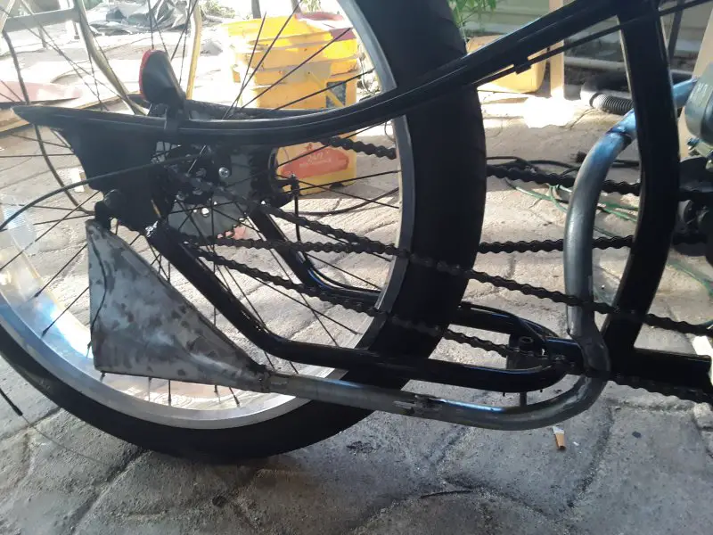

I took it out quickly last night, the nuts on the rear brake vibrated loose as well as the chain which caused a little damage to the fender brace and caliper. USE LOCTITE!! I'll be taking it out tomorrow, hopefully with the exhaust finished and the rear fender sorted out. I'll take some better pics when it's finally done.
