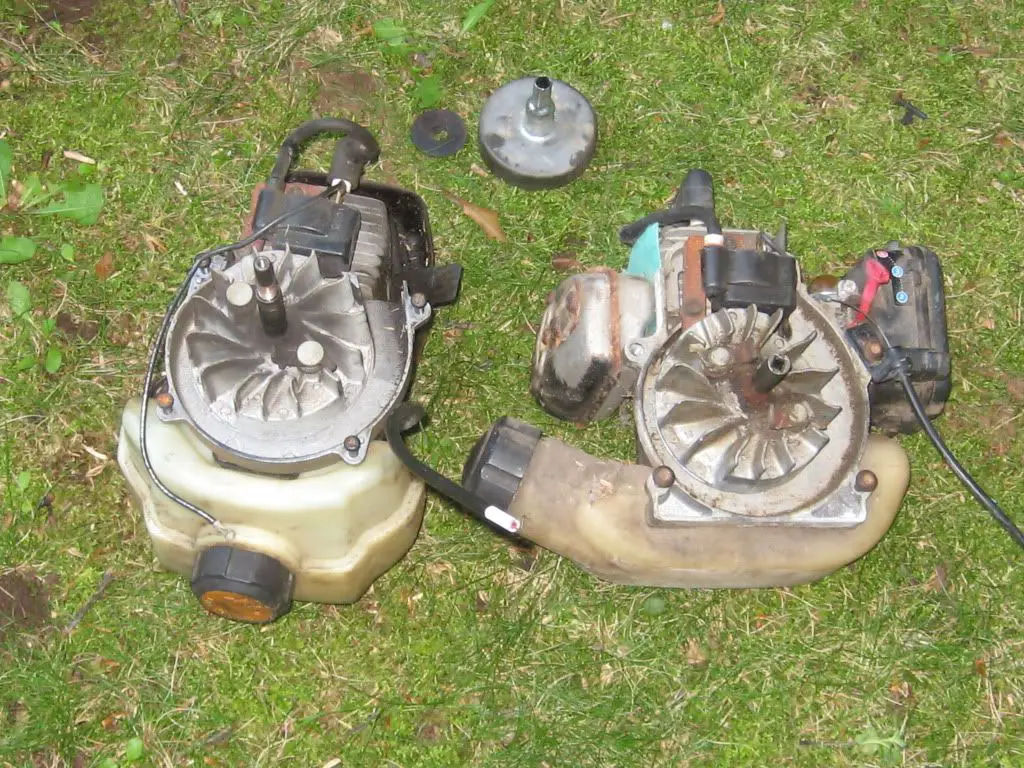

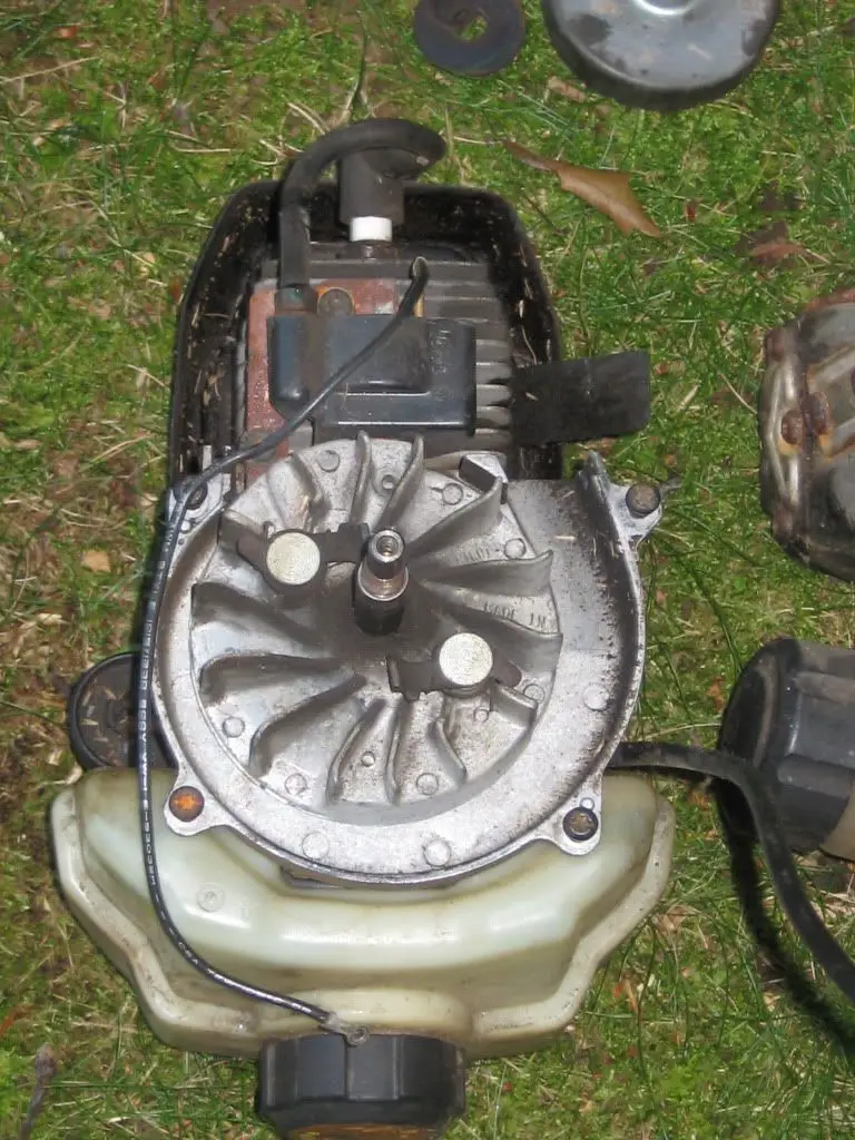

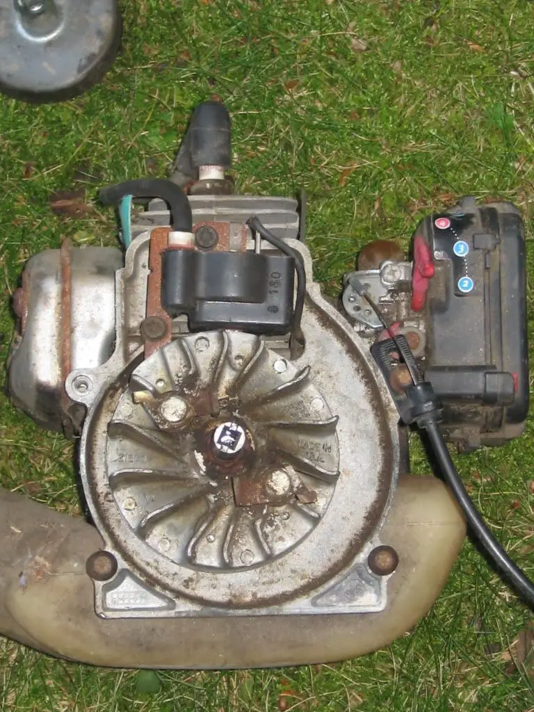

Hope this isn't thread jacking but here are pics of the extracted engines before overhaul and cleanup!

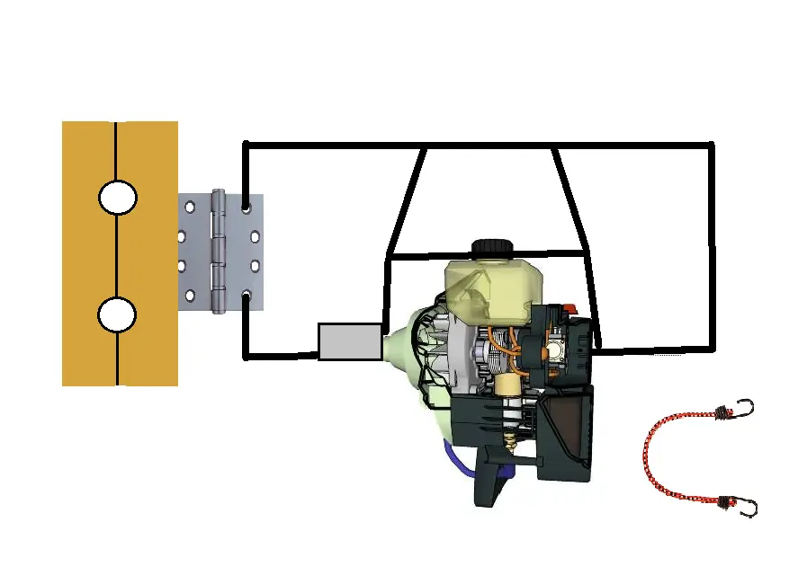

I'm gonna try to make this one pretty sturdy so the black likes are all angle iron, please ignore the fact that the engine image is turned the wrong way. I'm gonna use a door hinge and a wood mount. Wish me luck
Most of them fit but here is a thought. take your engine to the bike shop. Tell the guy there what you are doing, then ask if he has any used pegs you can try the threads on. They usually do. Most likely he will do anything to get you out of his shop lol.
The guy at the LBS is actually VERY MB tolerant, it's amazing, I know. I'm thinking because the threads are so far on the shaft I may have a spindle welded up that is like a bmx peg but has some sort of threaded bit in the middle so it will get close to the flywheel too
