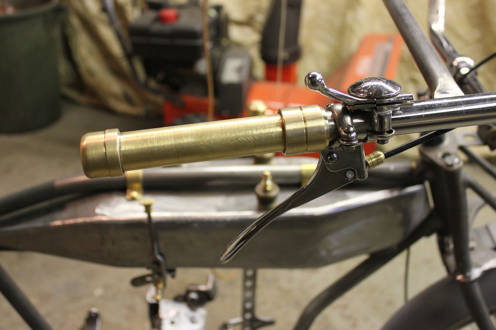

I have seen the "Ely" bike pictures that Mr. B. had posted,and really liked the leather lace grips..
After staring at the rubber coke bottle grips that I had on the bike for awhile I decided they had to be replaced.
Found some brass tube that with a little internal sanding would slip snuggly onto the bars.

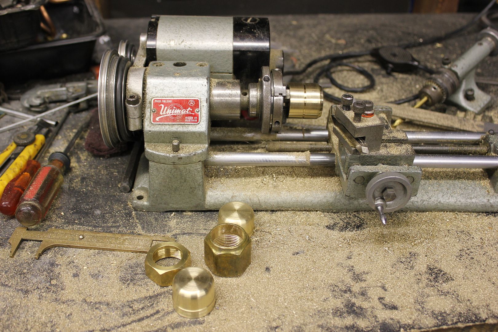

Picked up some suitable brass fittings from Home Depot and turned them into hand grip parts.

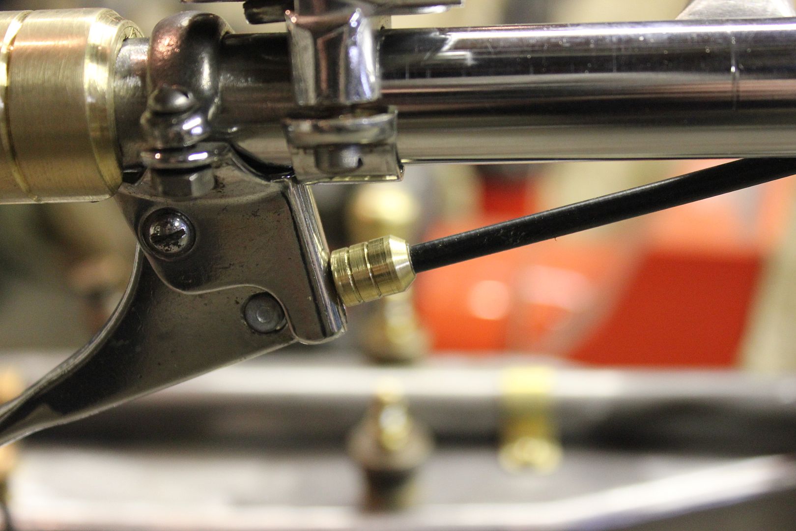

Also made some brass cable end ferrules.
Soldered the brass hand grip parts together.

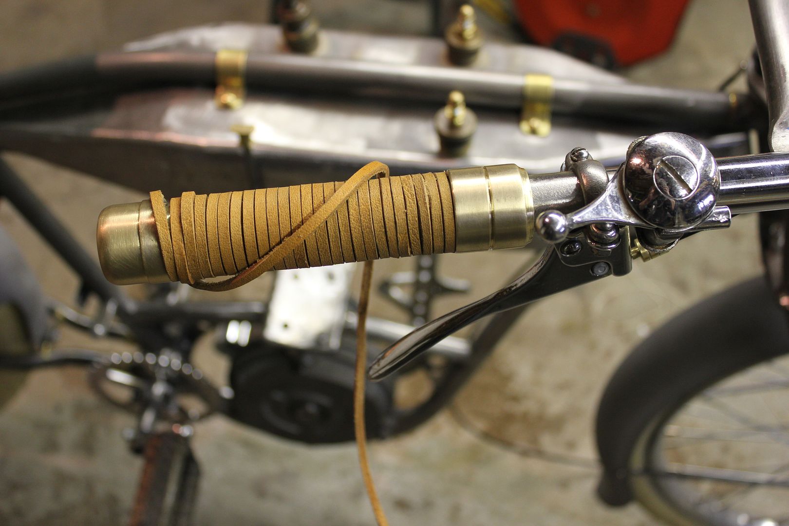

Initial wrap with leather lace just to take a look.

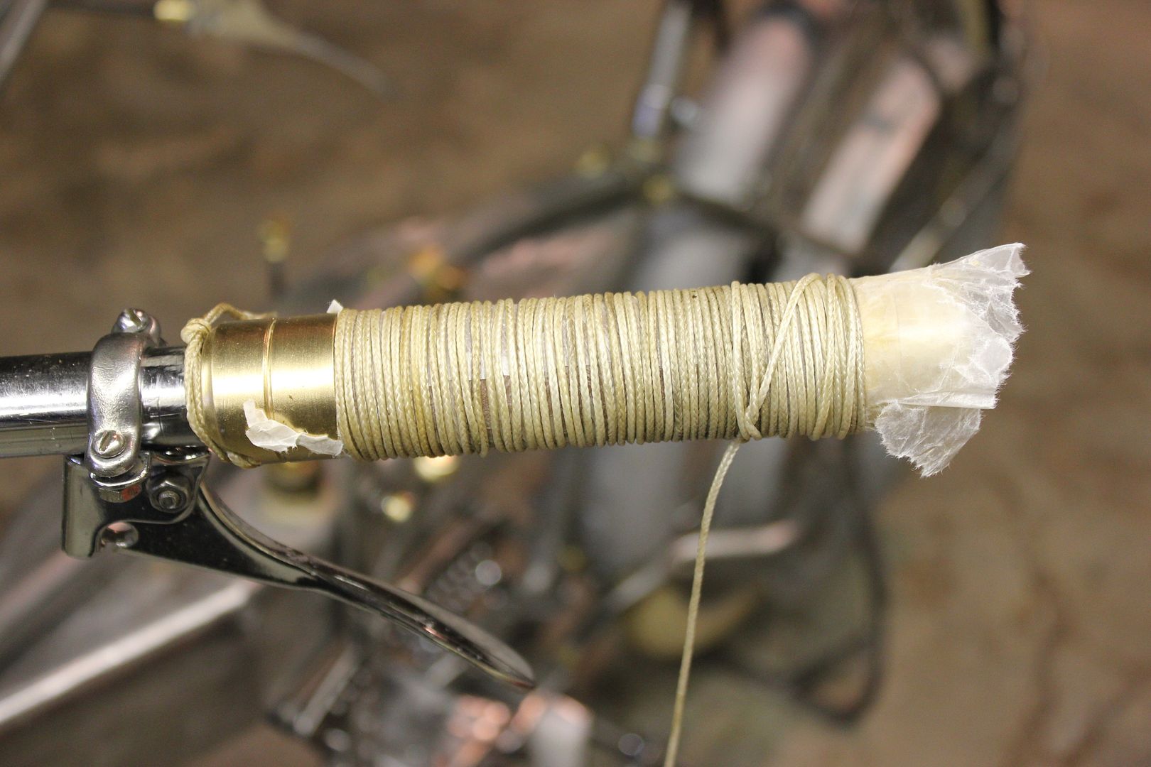

Lace is glued, wrapped tight, covered in wax paper, then wrapped tightly with cord to "clamp" the lace until the glue sets.
I like them.
Final task today was to modify the throttle lever and the front brake lever so that they shared a common mounting clamp, just to clean up the look a bit.

What kind of lath is that you have there? Also how are those grips (brass parts) being held on?
It is an old tiny suitcase size "Unimat" transforms into a mill/drill as well.
