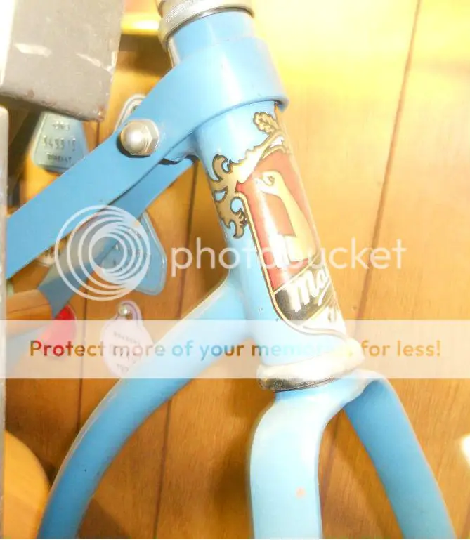

Terry did the brass head badge for my Indian Hiawatha tri-car. He's honest, reasonable and a fine artisan.Give him a design and he'll make it.

Judging from the wide range of fine work done thus far, I’m guessing Whozawhat will make his own brass badge...
And it will end up looking great too! :-)

You are correct. I will try to make my own brass etched badge.
It is another thing I have yet to try but am willing to give it a go.
Already gathered up the materials needed.
May even try a couple of test pieces this weekend on some round brass tags about 2" in diameter that have been sitting in a box for about 20 years.
Picked some suitable circular designs off of the net to use as testers.
The actual Maytag design will take a little work before I will know if it can be used for an etching.
I need to get the positive and negative images sorted out for the etching.
