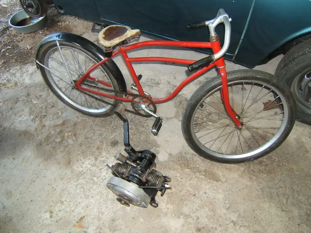

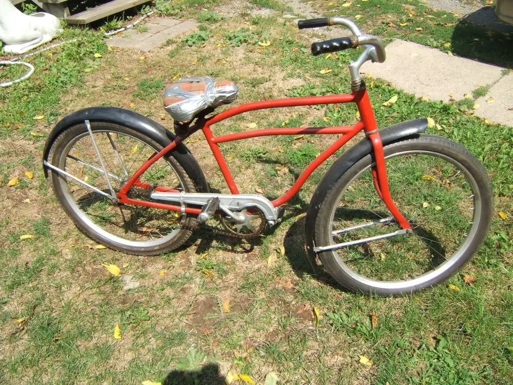

Hello all, just joined up here since I finally scored a donor bike for my build. It looks to be a mid 40s Western flyer. Its got 24" tires, a skip tooth chain, and a Bendix coaster brake. the only identifying mark on the bike was the pedals, that are stamped "Western Flyer". the head badge is gone, and it has been repainted. It's in ride-able condition ( I took it around the block) but very small for me. I hope that my mods will make it a bit more comfortable.
The plan is to make a board track tribute bike using a 2 cylinder Maytag model 72 I have sitting on a shelf. I'm going to extend the frame about 5 inches, and I plan on building some version of the flat belt drive setup with the large hoop in the rear wheel.
I'm just starting my search for parts, including some white or clay colored tires, some sort of jack shaft, some leather belt (cheaper than what I've found so far) a springer fork, or some springs to do my own build.
I work at a fab shop, so I'll be making a lot of my own parts. I have pics, and will be uploading stuff as soon as I can get it on the 'puter.

Here's some pics as promised
The flywheel will really cap your acceleration (think continental drift), but it will be so lazy and long legged once it's rolling.
Ok. running with the longitudinal idea, I'm thinking the flywheel is gonna go. I'm thinking that a smaller flywheel, just enough to keep things smooth, mounted on the output would be better. I gotta make the timing adjustable, and I'm starting the hunt for a 90degree drive box. possibly out of a lawn tractor or a tiller. this is all still in the brainstorming mode and is subject to change, but this is the fun part.
