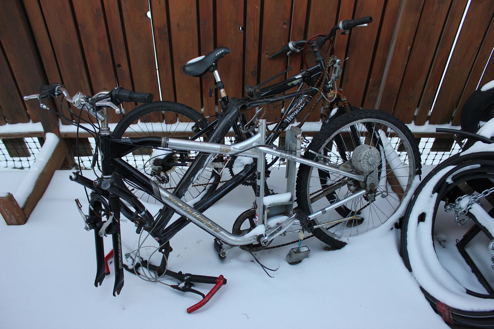

I have collected some free wrecked bicycles for bits and pieces.

What's that thing on the rear wheel of the silver speeded bike?
