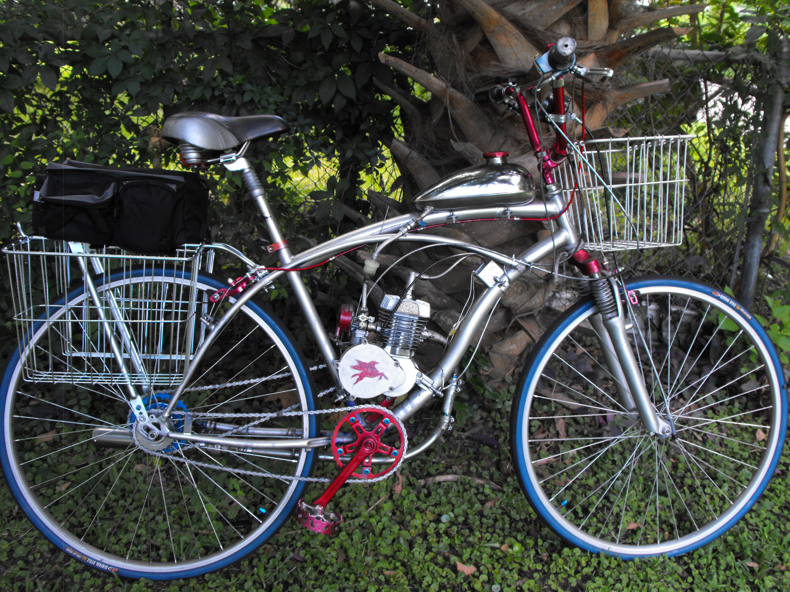

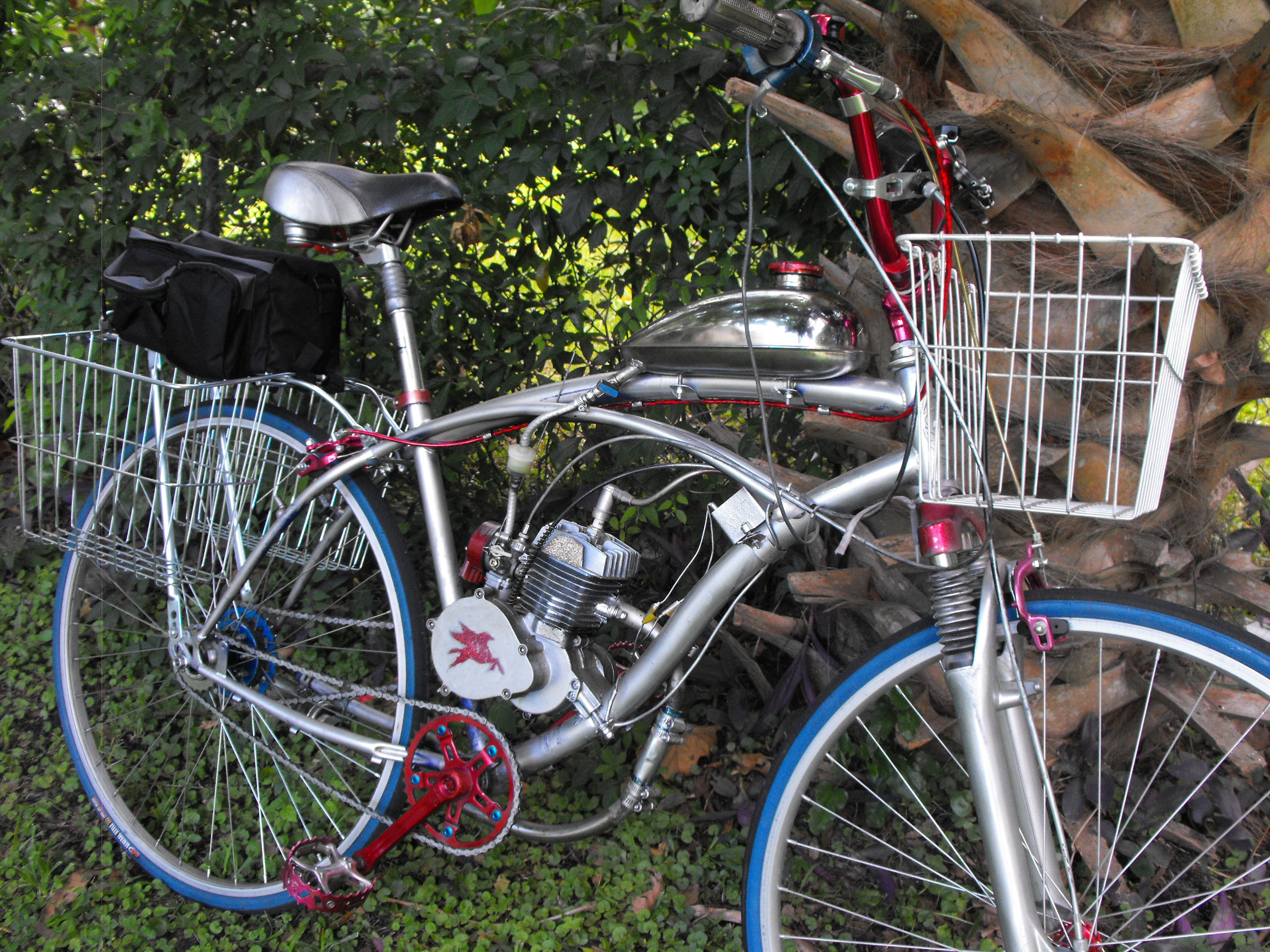

Thanks for all the advice I did all of that and more I also ported it out as well and I now reach 50 miles an hour on my bicycle
I ended up using a 36 tooth sprocket however I do have one coming The Hub and sprocket adapter with the 30 tooth.I ordereed the chrome tank that attaches to the seat pole. Thanks for the advice on the picture. I will do that

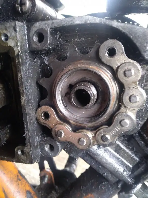

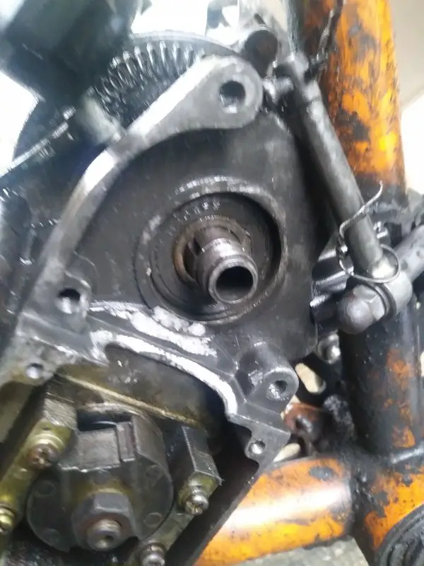

I ride daily and cruise speed is 25-35 mph 30 is my average speed. here in miami fl i travel many 80 mile round trips into the city with many stop and go situations. got a 26 wheel 2.10 tire, 39 tooth sprocket, a MZ expansion chamber pipe with kx80 muffler a rt carb 61 jet, fred head 5.5cc, c7hsa ngk plug, and use AMSOIL 100:1 SABER oil. I am getting around 60 miles a tank almost a half gallon. the bike will scream right on up to 43mph with the powerband trying to slip the clutch. I also woke up in the hospital one day going 30 mph to work from the front wheel bearing failing. dont hink I need to go any faster on a bicycle. what you think?
no thinking needed - bicycle parts weren't made for those speeds - when was last time you heard of a motorcycle wheel bearing failing

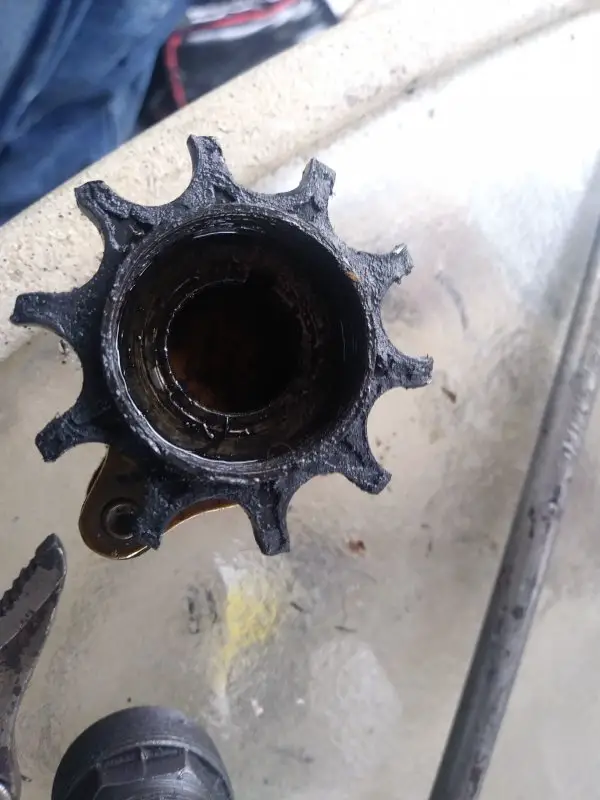

Now I am ready to try in the morning a 12-36 tooth combo, done worn out two ten tooth sprockets and the new 12 tooth wont last 500 miles I am sure. Need to find some well made sprockets. these are just paper thin.
got it all to work 12-36 but could not get the rpm needed so went back to a 10-36 and it is a very good city cruiser gotta pedal a little but if the engine is in good tune it will pull you from a low rpm and mph and accelerate without pedaling just fine. I was probably getting close to 50 mph with the 12-36 but the engine could not push any faster and got hot so the 10-36 it is and it is good.
For commuting it is excellent, if you gonna go hi rpm with it better have a new cylinder and piston waiting for ya at home in case you had too much fun.
