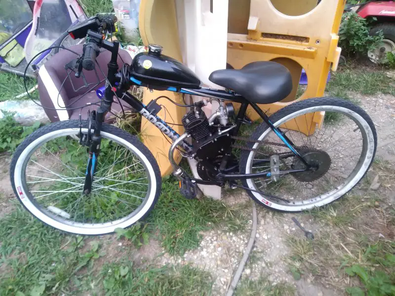

Hey I have a 80cc bicycle motor kit I bought from Amazon from Calloway and its all stock I run 38 mph and want to try to get into the 50 mph range what would be the best way to get a extra 12 to 15 mph I am running 44 t sprocket

But I'm hitting 38 mph all stock nothing done to it at all well the weld on my exhaust broke so now it straight piped but when that happened I lost like 2 mph was thinking bout getting a jackshaft kit for the gears but I saw on a thread that the best exhaust is the cr80 off a dirt bike and a high compression head and a better spark plug and magneto and cdi u think with the exhaust,head,magneto,and cdi I can get a extra 5 to 6 mph

you are " hitting" 38 mph. i can run 46 mph flat out till i run out of gas. try tht with a single speed and you'll burn them rings up and blow the top end up ( not boom like kill ya, but boom like rings gonna break and be spit in to the header). i know i can hit 50. i am eventually going to custom build my gear cassette. that way i can hit 50 mph easier and hold it like i can do with 46 right now. plus with sustained high rpms, them bearings are gonna go fast. it's why i ported my engine for torque instead of rpm, and slapped on the long header to match the long intake. i'm not trying to blow them, i wanna ride them. people tell me to get a motorcycle, i have one. it's just as fun as these bikes, buy way more expensive to play with. plus i can't take my kaw down a bike path or sidewalk without serious trouble following. lol. i do not recommend running tht single speed at 38 mph very long. where as if i could find the right road around here, no traffic and straight, no hills, and long enough, i know i could get tht 50mph. just need a long enough run. the 46mph came from the longest safe street i can use around here for this. i ran out of road, but had more rpms to go and was still gaining, slowly, but gaining.

oh on exhaust, build your own, or get one of them mz65 pipes, they kick rear for a stockish engine!! the mz65 was build for a 65cc engine, perfect for a 66cc china girl. nice low end pick up, mid range too, and even goes up pretty good on the top end. nice all around pipe for these bikes. i wouldn;t use it for racing, but trails and street riding, it adds quite a bit of punch once you jet your carb for it.
