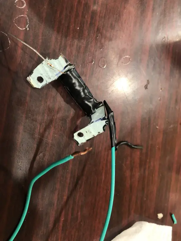

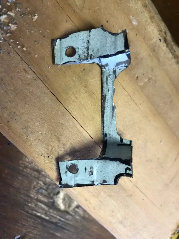

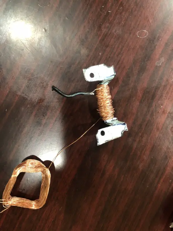

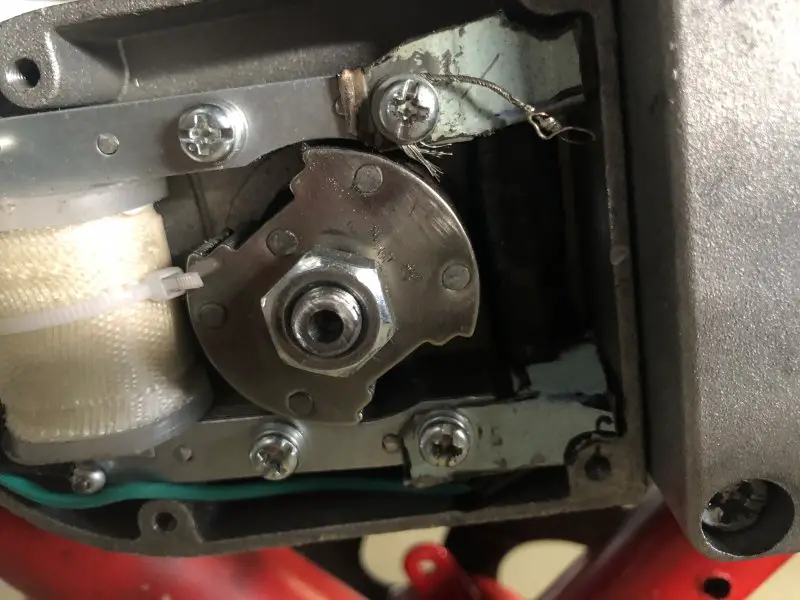

I've been messing with the white wire trying to hook it up to a light ever since I’ve built my MB. Eventually I gave up cuz it kept on killing the motor. Rather than stealing power from the spark plug's magneto, I decided to build my own generator instead.
I made it out of some wire (from an old electric motor) and thin sheet metal. After all that, much to my disappointment, it only produced a maximum of .32 volts. Did I ground it incorrectly? Is there something wrong with the wire? Or is it just a crappy idea?
Anyways, I'd really like this thing to work, and I appreciate the help I can get from you guys. Hope the pictures help and thanks in advance.

I think you have a good thought but your construction installation is just lacking some. The magneto generates the power by passing the magnets very close to the curved metal part of the coil which then induce voltage in the coil. Your design only has a very small area that’s close to the magnet. Also if you do manage to make one that is close enough it will also “steal” energy from the magneto unless you can manage to arrange it 90 degrees or so in relation to the the mag pickup.

Ahh, i see. Thanks for the feedback, I'll just use a battery to power my lights for now :)

I am sorta thinking that the ignition module may only use one half of the AC the magneto generates if it used both halves then it wou spark twice per revolution and it doesn’t. If that’s the case then you should be able to use the other half with the white wire without killing the ignition. Just put a diode in the line in the proper direction. I will do a little experiment and see.
