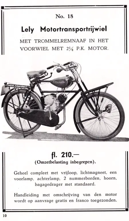

This appears to be close to what you're aiming at, but it's more early 1930s European.

Great image as it shows that even with the second tubular frame bar there is enough room for the engine.I also want to add a headlamp though originals are of course priced high and modern types not accurate enough.

Your engine should slide right in! When you have the V frame it's very simple to install. That image Ludwig but up is peeeeerfect
