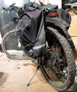

Mounted my taillight to the reflector tabs on the rack and the headlight to my fender. I did hafta remember to put a connector inline in case I wanted to pull the fender and/or rack - but it's easy 'nuff

I really do think norm's lights add more than just the ability to see at night, they "finished" the build for me. Here's an older pic just for the heck of it (pre lights);
