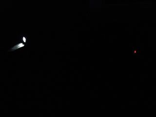

I just thought it would be very cool to say my lights are still running perfectly front and rear that Norm. You keep that that secret bulb humming.... Just too cool. Works perfectly.Thanks! At a decent price too...
Norm's headlight & taillight combo runnin' off just the white wire :D
They be ossum!!1! The only "problem" is my bike doesn't like 'em on when it's at idle and not warmed up yet... obviously that's really not much of a problem lol I did hafta drop my spark plug gap a touch, but that's fine as I had it too large anyway :p
Once the engine is warmed up it's doesn't have a perceivable effect on the ignition at all! Norm - yer a genius (^)
